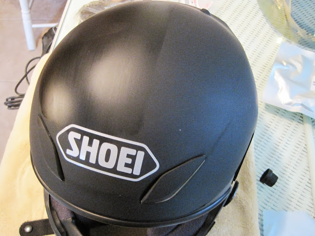

I wanted to protect my new helmet as much as possible and Cquartz specifically states their coating will work on Matte finishes.
First I thoroughly cleaned the matte surface. I'm just using the BFWDWW bottle as a sprayer, it's actually filled with ONR.
Scrub a dub-dub.
Then I wiped the helmet down with CarPro Eraser to remove any remaining oils.
30 ml Kit.
First pass.
The matte finish almost seemed to absorb the CQuartz.
After waiting 10 min, I buffed away the high spots with a short looped MF towel.
The finish looks *slightly* glossier, darker and feels coated.
Looks great!

Water repellent before/after. You can see how much darker the coating made the helmet which I love. Hard to see in pictures but Cquartz is doing its job :xyxthumbs:
CarPro Cquartz 30 ml. Kit
Looks great!
It really didn't impart much sheen to this particular matte-finish...
And: It does look great! :xyxthumbs:

@Bob - Thanks. It looks even better in person.
@dpk20x - Why didn't you tell me before?? lol Thanks :)
@Flash - The darkening of the black turned out to be my favorite part. I called it "Batman Black" lol. The water does repel now, before it would almost stick.
