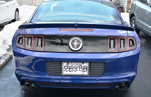

I just did my first run with ceramic two weeks ago, and used UK 3.0. I did the following;
Wash
IronX
Foam Wash
Clay
Polish with M205 (because I had it)
2xeraser wipe down
2 x CQ UK 3.0 (45 min to 60 min apart)
1 x Gliss (4h after CQ UK)
Couple tips from my first experience with it.
Eraser works great and cleaning up any polish residue.
I thought I had loads of light in my garage for looking for high spots. While I got pretty pretty. I have everything, it wasn’t until I pulled out into daylight (over cast period was best) that a few jumped out. If you can, pull it out into daylight to check it over after you apply.
Because I was slow, being my first time with it, I set a 45 min timer, so when it went off I would go back over previous panels with second coat. I guess if you wait much longer, it can haze.
If you try Gliss, it flashes white apparently, but I had trouble seeing it flash at all.
I though CQ UK 3.0 made it look great and smooth feel. I had no idea until I applied Gliss. Totally shocked how much more slick the surface felt. Dragging MF towel across trunk with one side Gliss applied and other CQ only, was night and day. Maybe it won’t give anymore protection, but it was worth it for how slick it felt, and I didn’t need reload. Gliss goes on in a fraction of the time of CQ.
I had the car to the dealer today and I didn’t say anything, but the service advisor said I will be telling them not to wash the car because its ridiculously clean.
On dash, rear view, steering wheel, seat and do not wash autoplay mp3 loaded on radio
Ha ha. I’ve had the car in a number of times and always tell them don’t wash it. This time the service provider just beat me to it. He said when he saw the car he knew that I didn’t want it washed.
