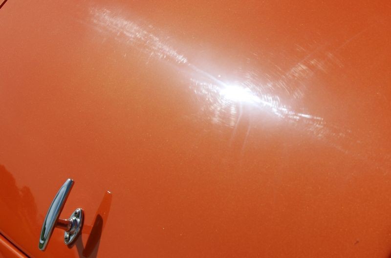

Now lets see what's really going on....
These my friend are holograms....
Can someone explain to me how to tell that the marks in the last 2 pictures are Holograms?
To my eyes all 3 pictures look like swirls, and I don't see the difference between the first picture and the later 2 pictures. (except maybe more lines coming out from where the light hits...?)
Sure - be happy to.... :xyxthumbs:
Look at the wispy LINES or PATTERNS you see in the below pictures from my article here,
The word holograms means a specific scratch pattern inflicted into paint using a rotary buffer
watermark.php
See the LINES
watermark.php
watermark.php
Holograms are a pattern of SCRATCHES that mimic or copy the direction a ROTARY polisher was moved over the surface.
Swirls are RANDOM.
Micro-marring is caused by ORBITAL polishers, they are not random nor are they caused by a rotary.
Somewhere on this forum I have another article with pictures that shows the different types of paint defects.
Swirls are RANDOM.
I have tried to draw on that picture in your post:
I see lines, which i draw on in red. I'm guess this is the direction the rotary was moved
I see other (circular?) scratches, & I draw on (some) of them in blue. These look the same as swirls TO ME, but I THINK these are also from buffer spinning.
Are these circular scratches (where blue lines are) holograms, swirls, or micro-marring?
