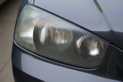

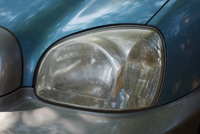

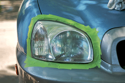

Of the few headlight restoration kits I've tried (Mother's, 3M, Meguiar's) I like the 3M kit the most (here are some headlights I've restored with a mashup of products, most of which come from the 3M kit: two Hondas, an Elantra, a Santa Fe).
But after you restore it you'll need to put a real coating on it to replace the clear you stripped off. If you want cheap, try the Spar Urethane method. If you want something designed for cars, try Opti-Coat 2.0.
