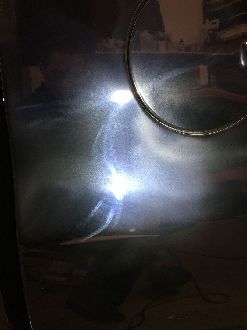

This paint was actually really weird and a PITA. Many of the compound polish combos I tried would not wipe off easily, or at all like the HD Cut+ test spot below.

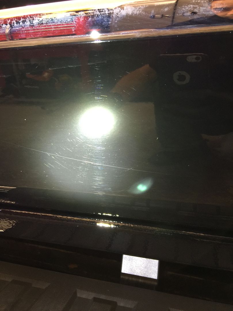

There was also a lot of deep RIDS in the areas the dealer hadn't polished
Because of this I chose to use M205 as a compound with Meguiar's MF Finishing pads, which is a technique Kevin Brown shared a few years ago. This step cut well and wiped off with ease, but also left a pretty deep DA haze which required a finishing step. Many of the finishing polishes were drying up too so I ended up using 3D's 502 polish for that step. :props:
