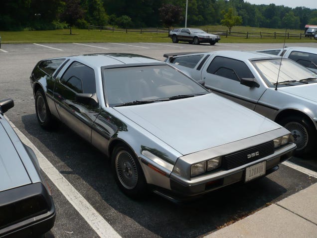

This one?
Mirror-Polished Delorean
Too bad they can't polish the bumper covers to match.

This one?
