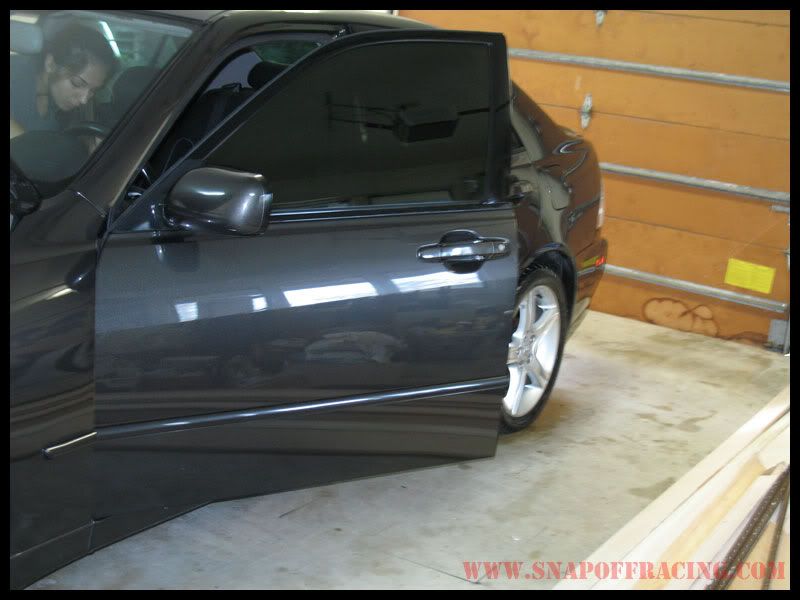

Products used today are:
  • Pinnacle Souveran Carnuba Wax on white lakewood country pad
  • Black Again (on all exterior trim)
  • Pinnacle Glass Cleaner on all glass
  • Cobra Micro Fiber Rags
  • Ultimate Detailing Machine
  • Ardex Tire Dressing
  • Under hood detail used the following:
  • Purple Power
  • Pressure Washer
  • Tire Foam Dressing
  • Interior:
  • Vacuum
  • UDM Machine with green carpet brush
  • DP carpet/upholstery cleaner on all carpets
  • Pinnacle Leather Cleaner
  • Pinnacle Leather Conditioner
  • 303 Interior Protectant

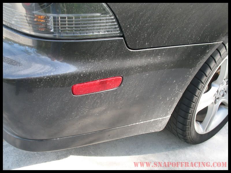

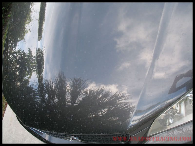

BEFORE:

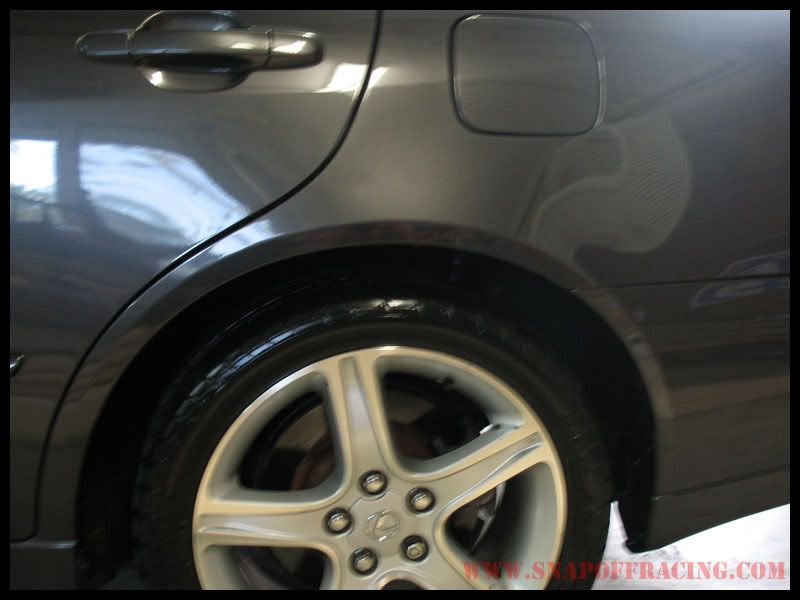

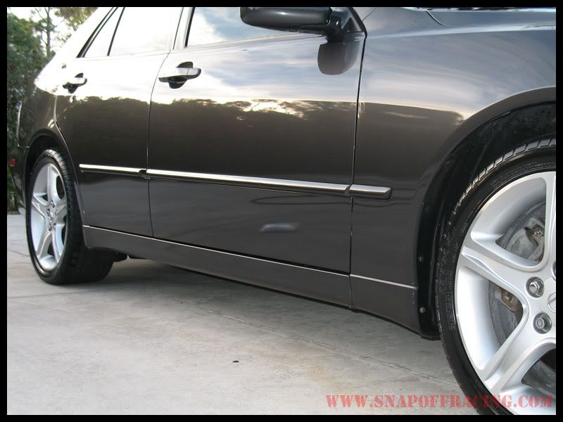

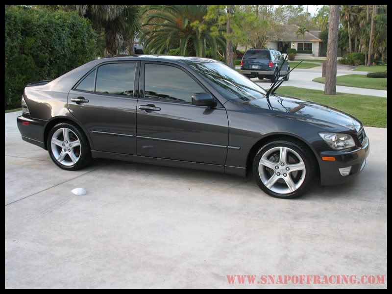

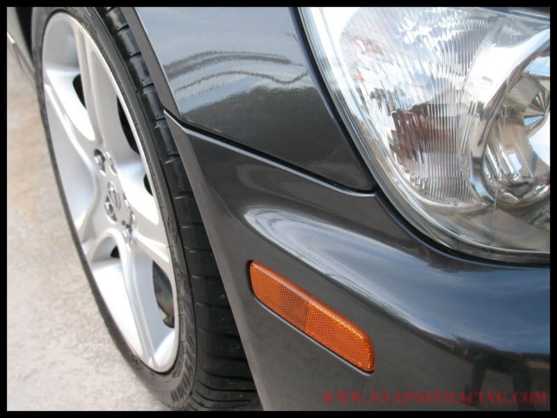

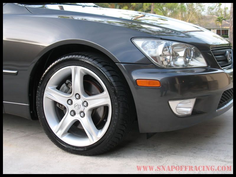

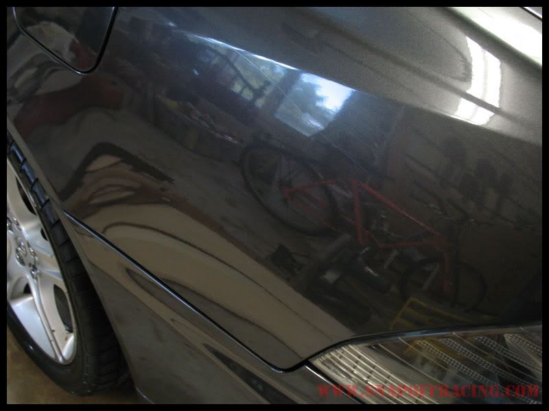

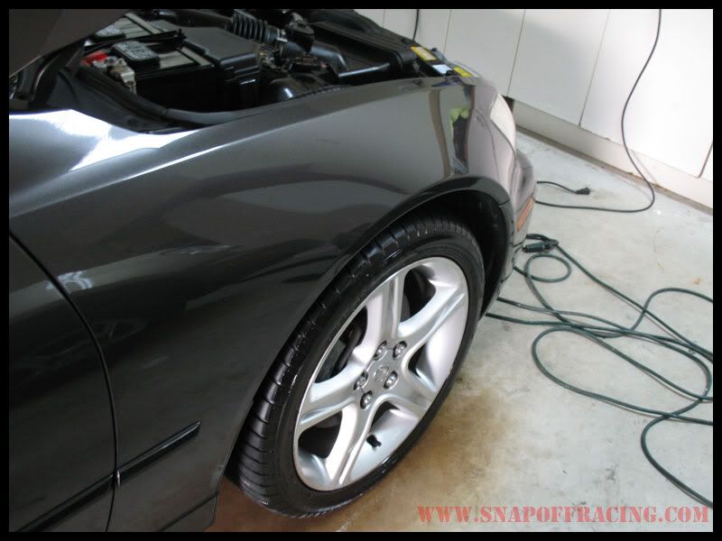

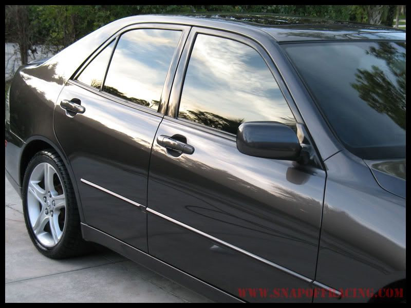

That's a nice color. The detail and reflections look great. Nice work.

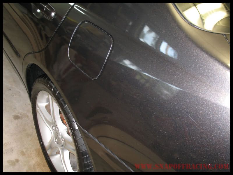

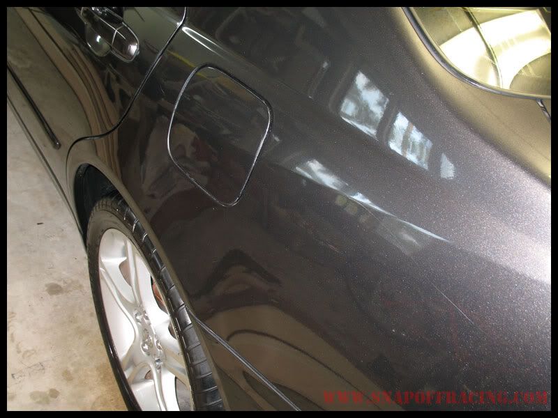

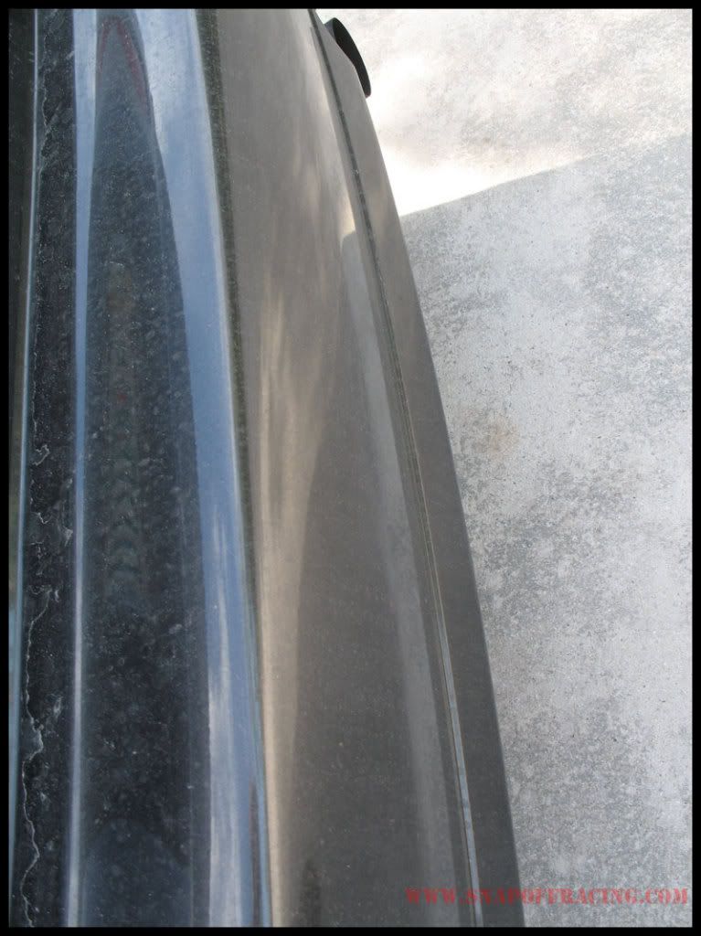

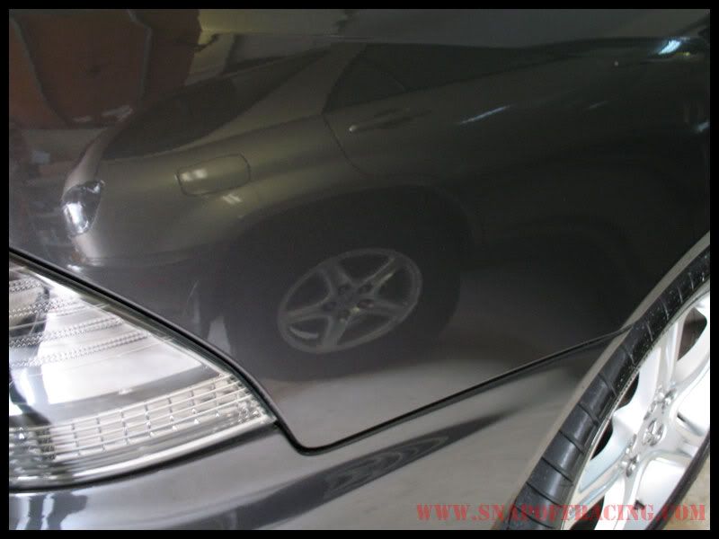

Thanks, the vehicle's actually mine. I bought it with the clearcoat missing on half the front bumper, and my psycho cuban x keyed the entire driver's side when she found out I finally moved on. I got about half of it out, and the wax filed in a lot as well
Sounds like you had quite a job ahead of you beside the detail. An angry ex
can add hours to the job as you found out lol. Real nice work.

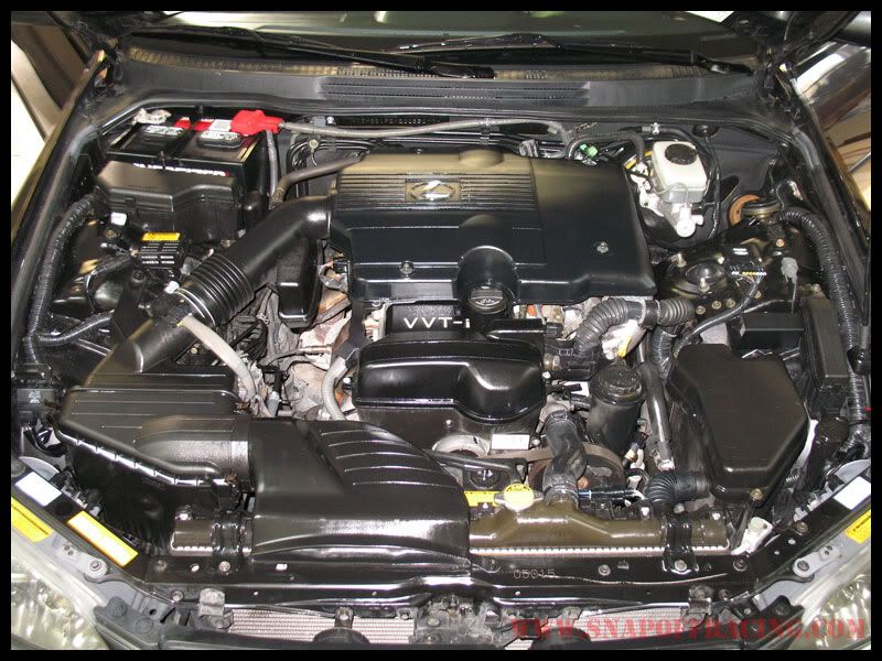

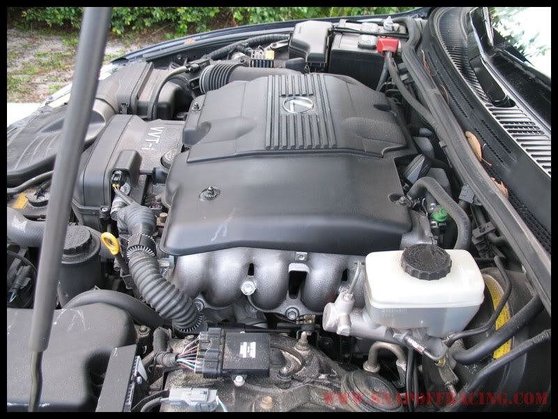

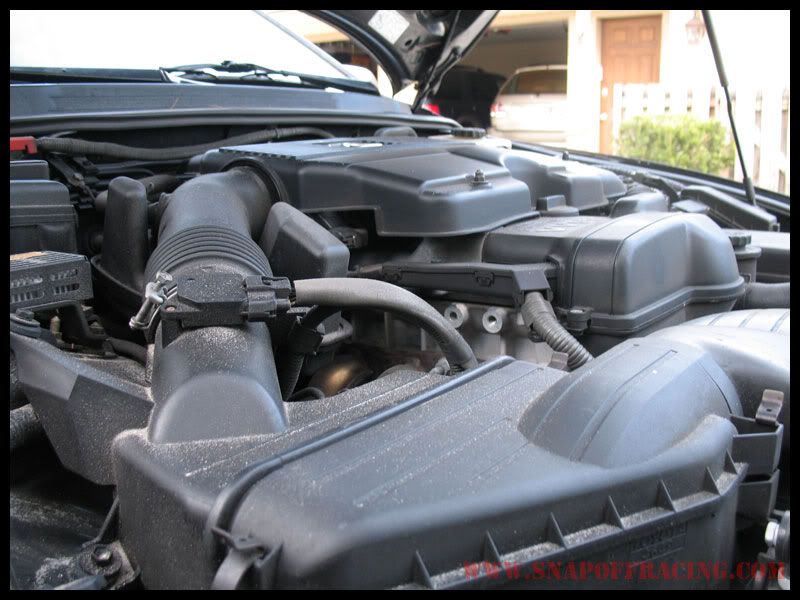

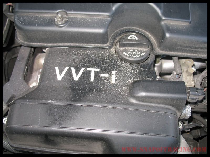

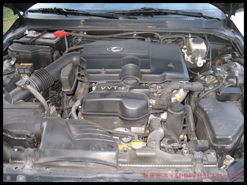

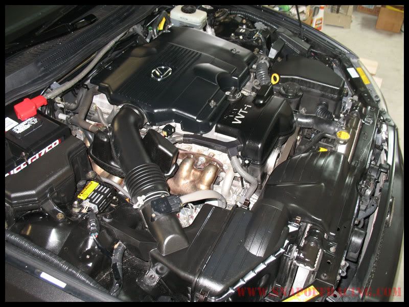

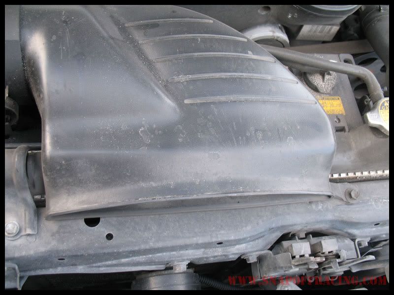

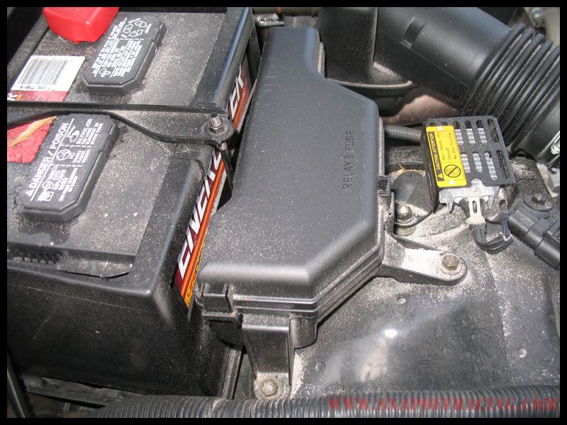

Lurve ur engine detailing..
care to share the steps and products?
Nice work. As much as I like the new IS's, it's to bad that Lexus didn't stick with the inline-6's like in your IS.

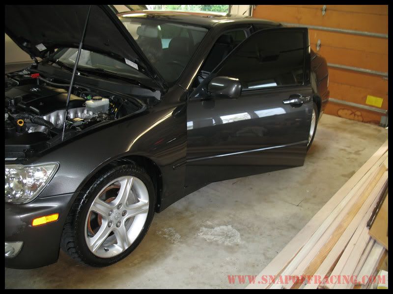

any tire shine product (i use good year as pictured), and purple power degreaser ( i used simple green for this one) basically you warm the motor up, park it, use a pressure washer wet the engine bay down, then spray degreaser on it, let it sit for 2-3 minutes, then pressure wash off, while WET, spray tire foam everywhere, avoiding electronics/belts and let dry. Wipe whatever spots missed and voilet!

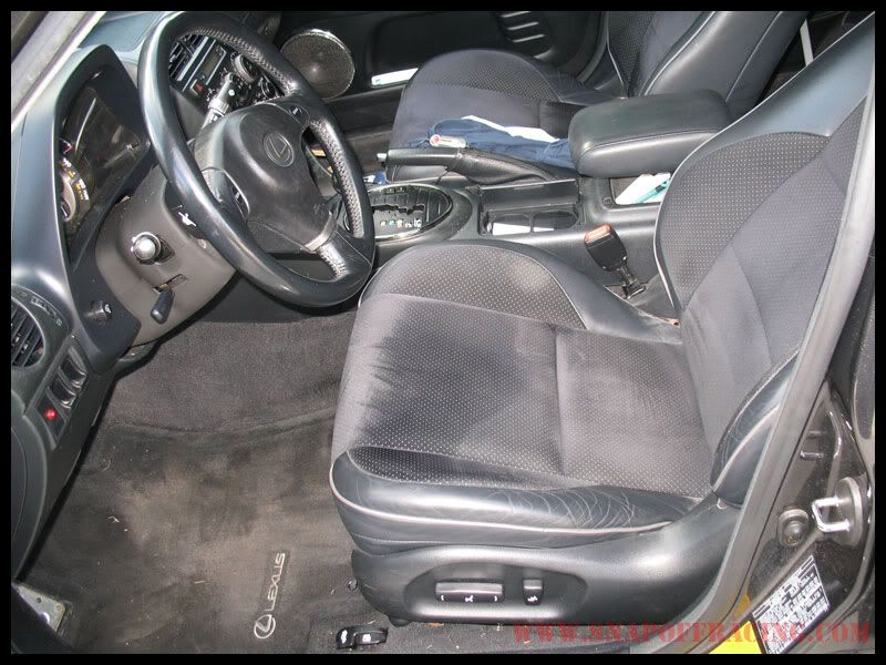

what about the interior? Any pixs?
yeah, I'll snap some tomorrow, sorry was too dark to take those when I finished
