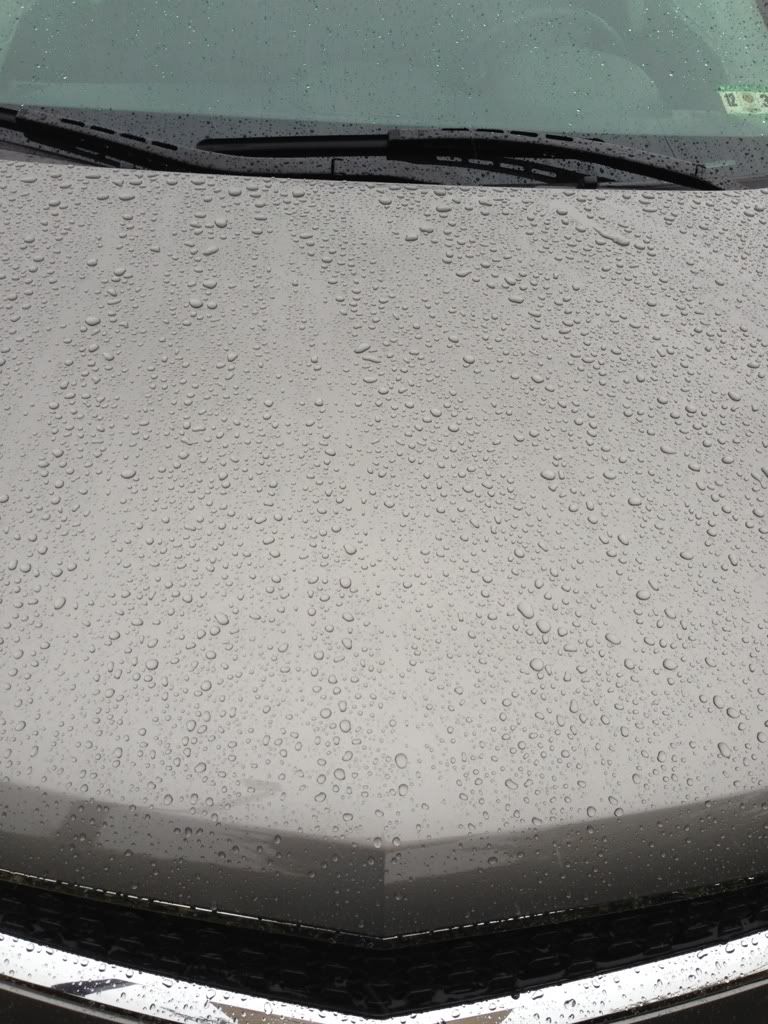

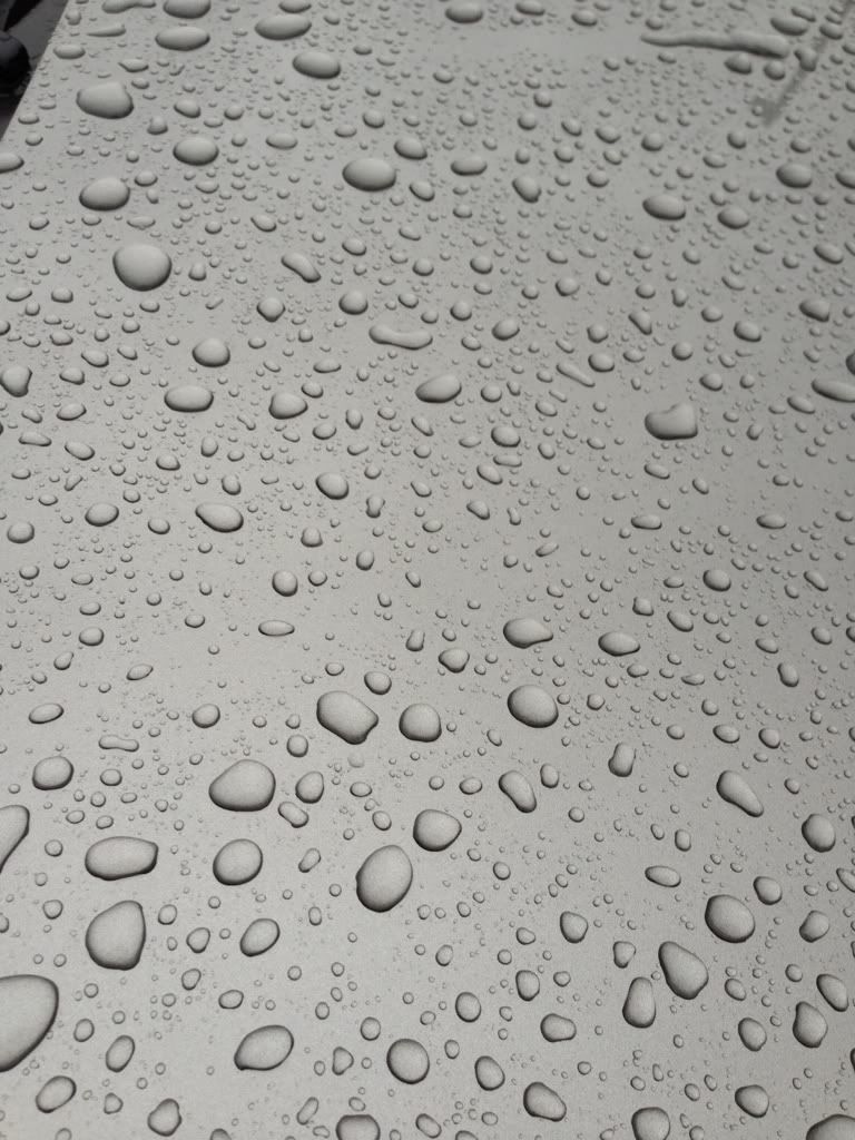

BTW, got a phone call last night after it had been raining and she said that she ran to the store to get some stuff while it was raining. Pulled it back into the garage and you can't even tell that it rained at all.
Love it!
Got these from the customer today.
