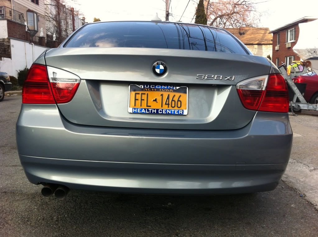

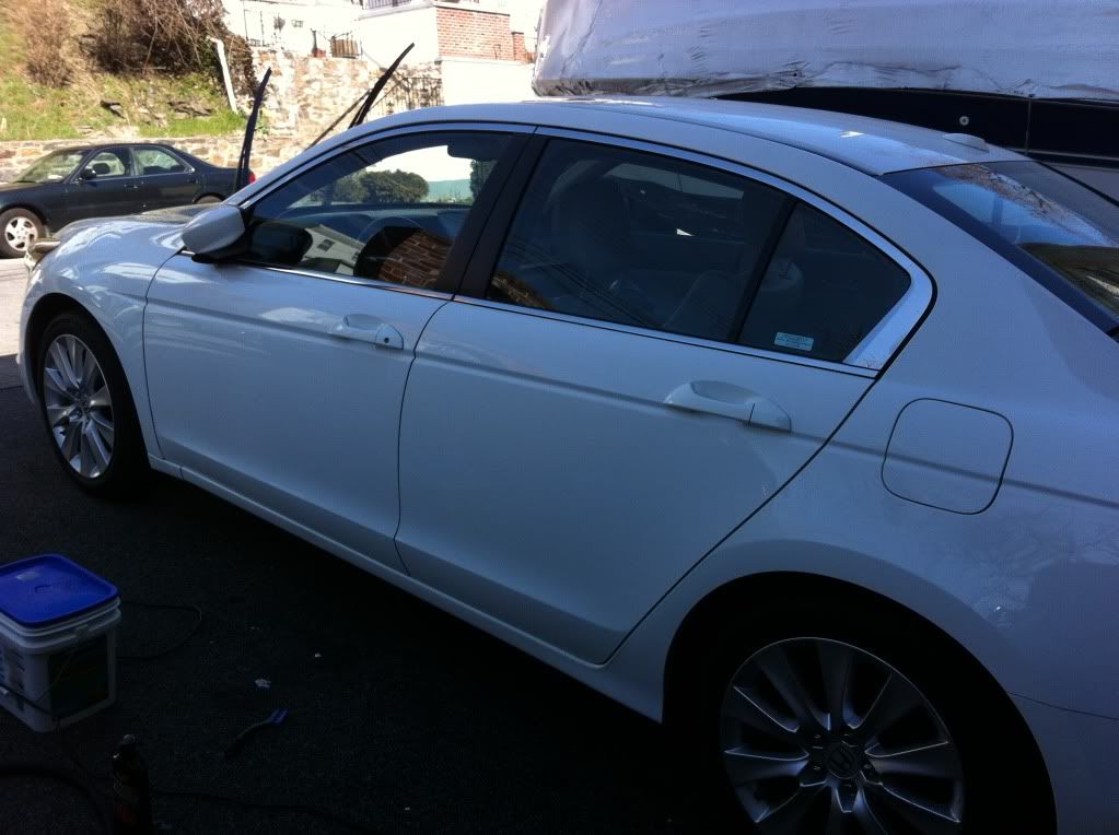

2011 BMW 335Xi took around 7 hours
2008 Honda Accord took around 10 hours
2006 BMW 328xi took around 9 hours
well heres onto the pics!
I totally forgot to take interior pictures of the cars once i finished. but it came brand new showroom condition
