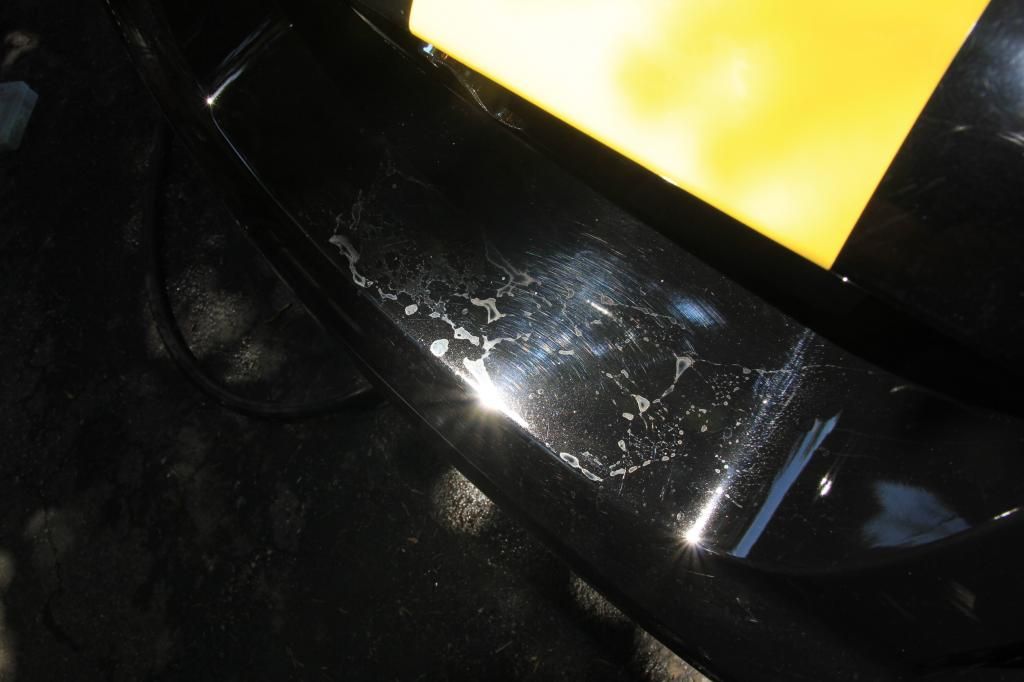

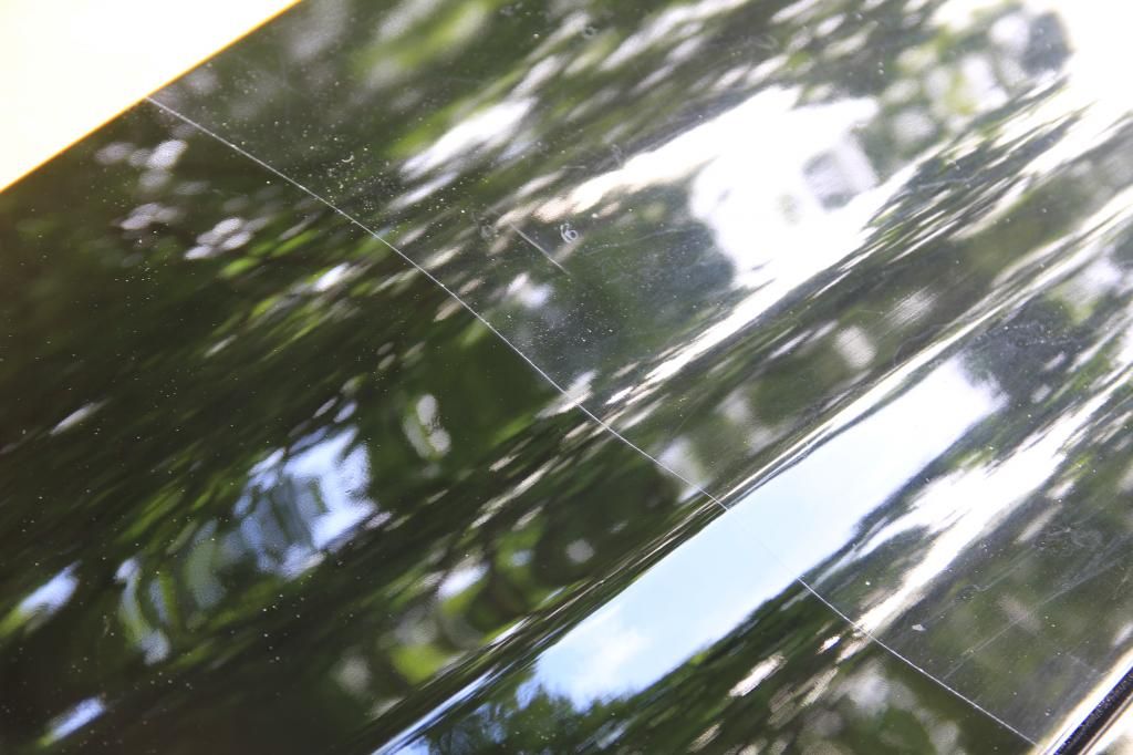

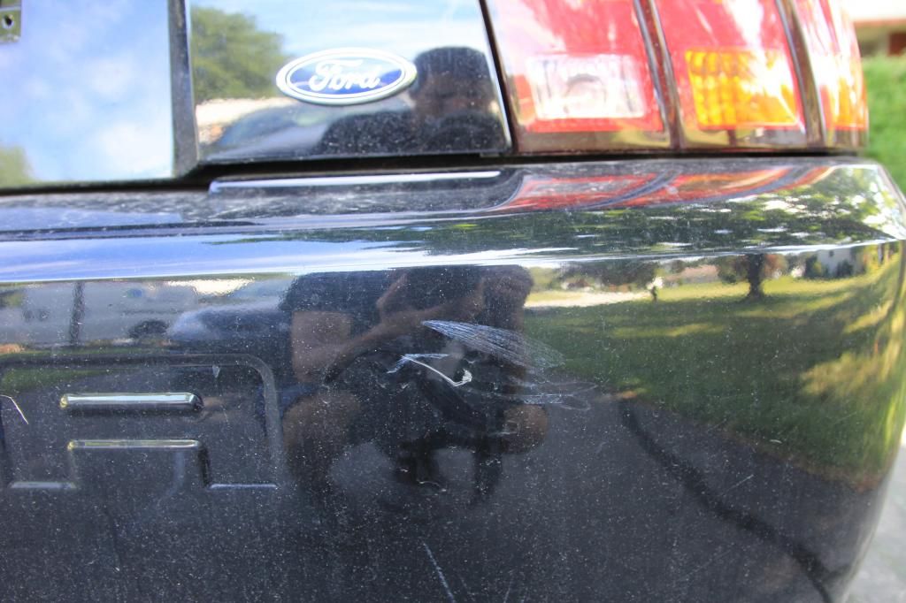

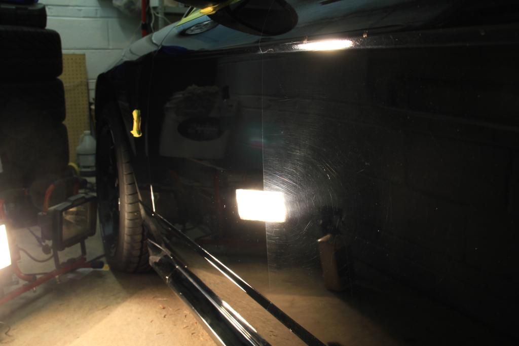

car was repainted aperently and it showed. paint readings were in 300-400 range and missed spots where it wasnt wetsanded and hood was blochy. so was not good paint job.
washed the car, clayed (was not too bad except for back bumper and trunk). took readings, did test panel and decided that wool with 105 will have to do, then menz 203. some panels that were not bad did SIP with yellow followed by white pad with menz 106

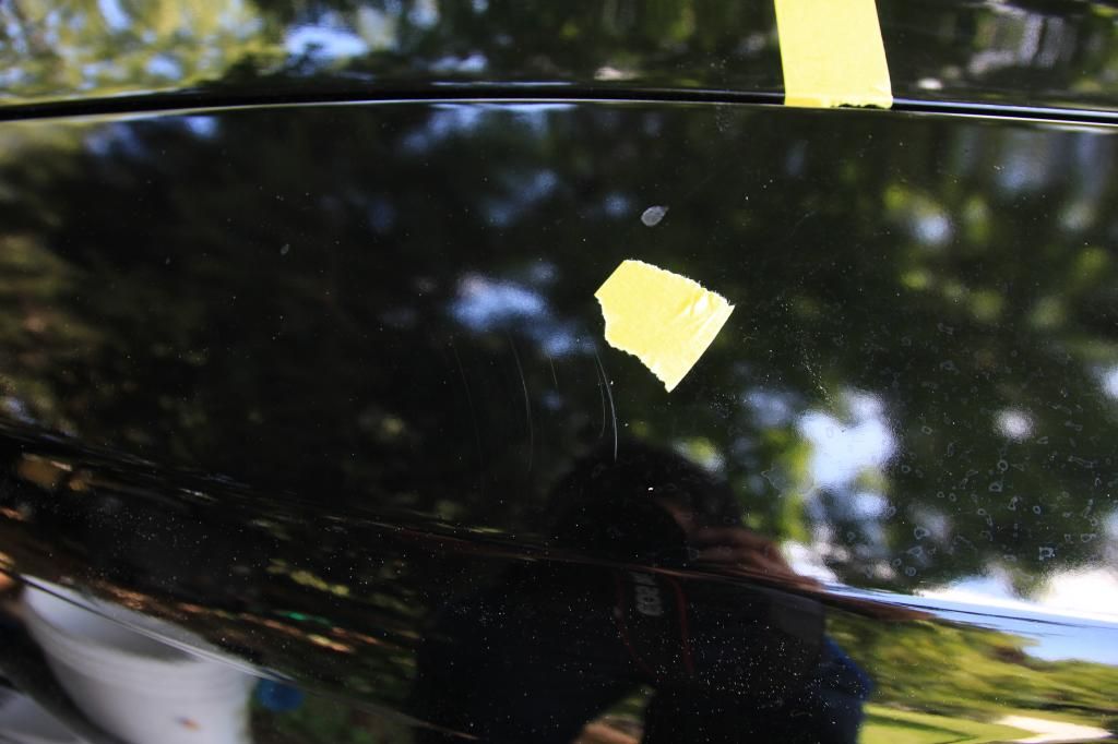

after polish. car was washed again. dried. wiped down with carpro errase and coated with cquartz. wiped down interior with CG sprayable leather. steamed carpet.

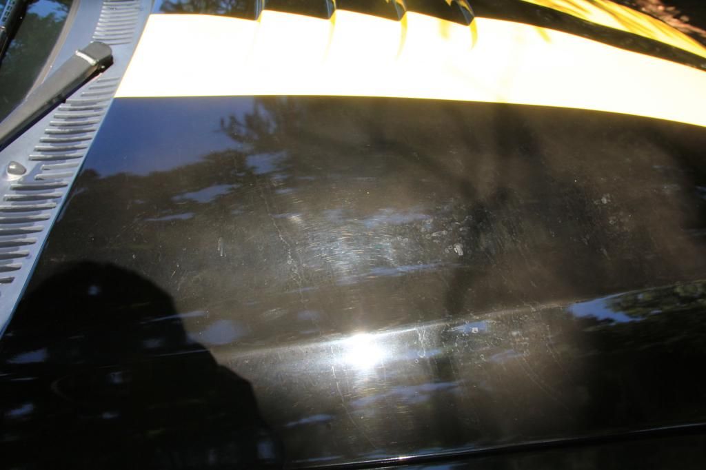

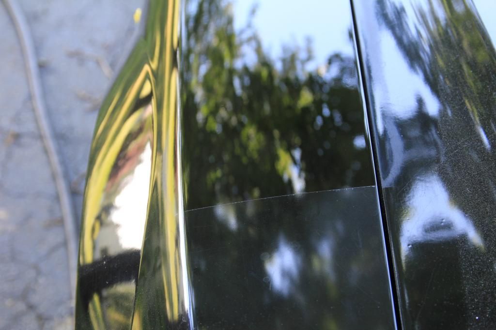

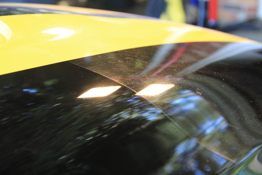

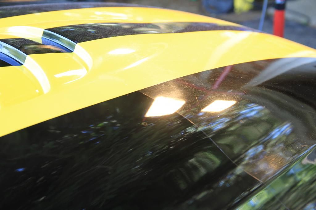

buffer trails from paint job

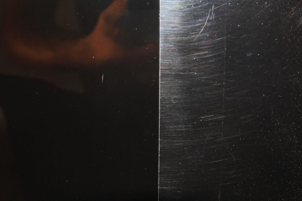

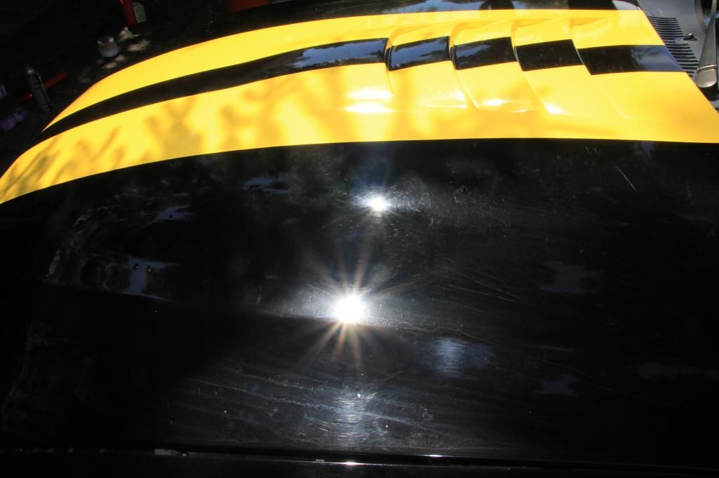

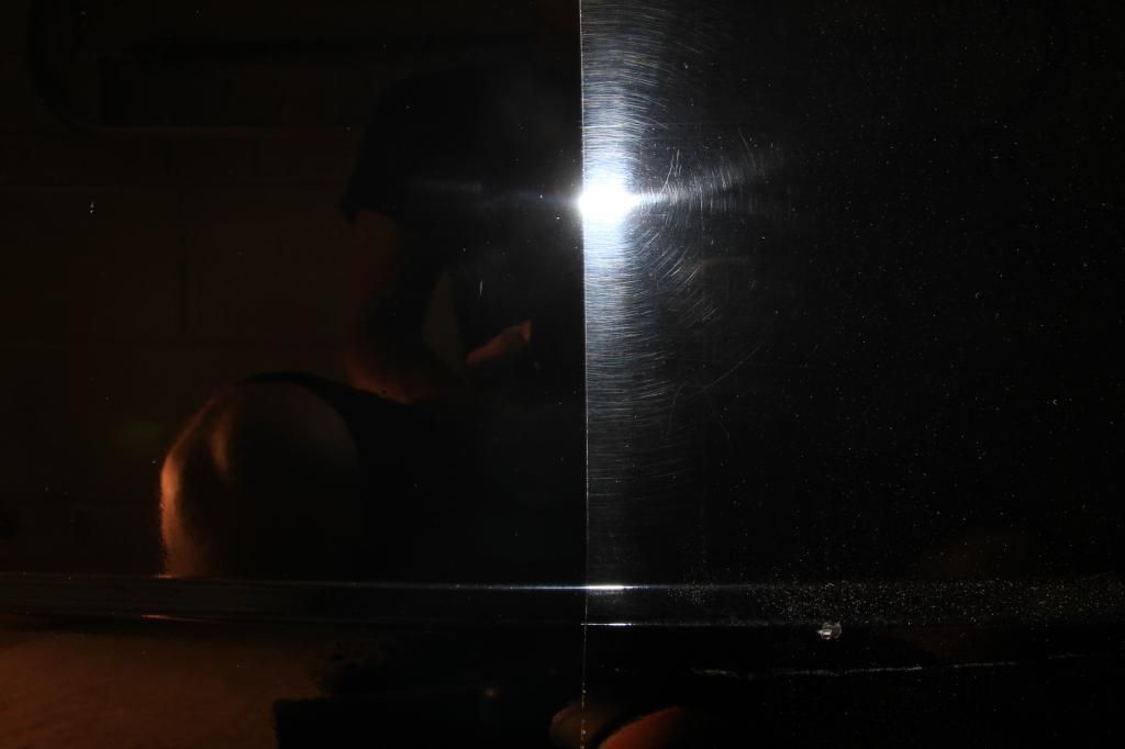

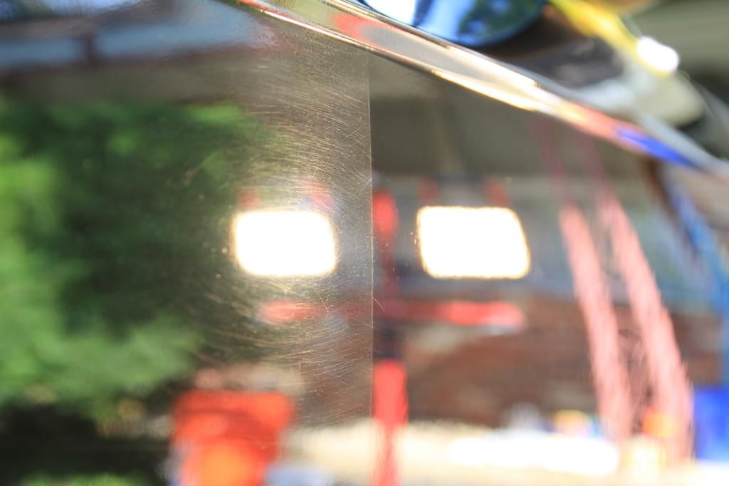

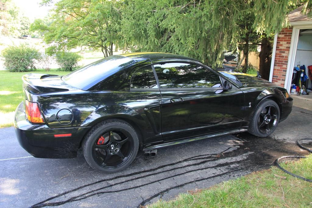

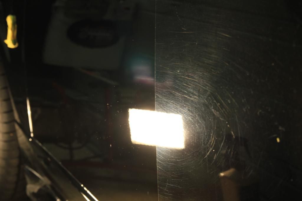

here is progress pics (50/50)

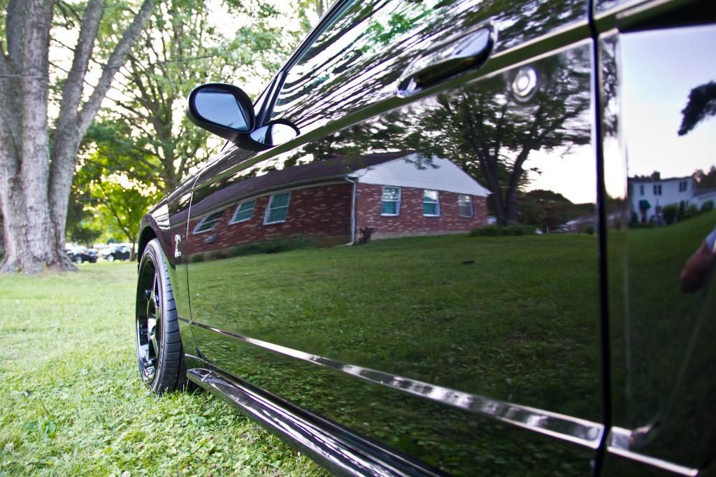

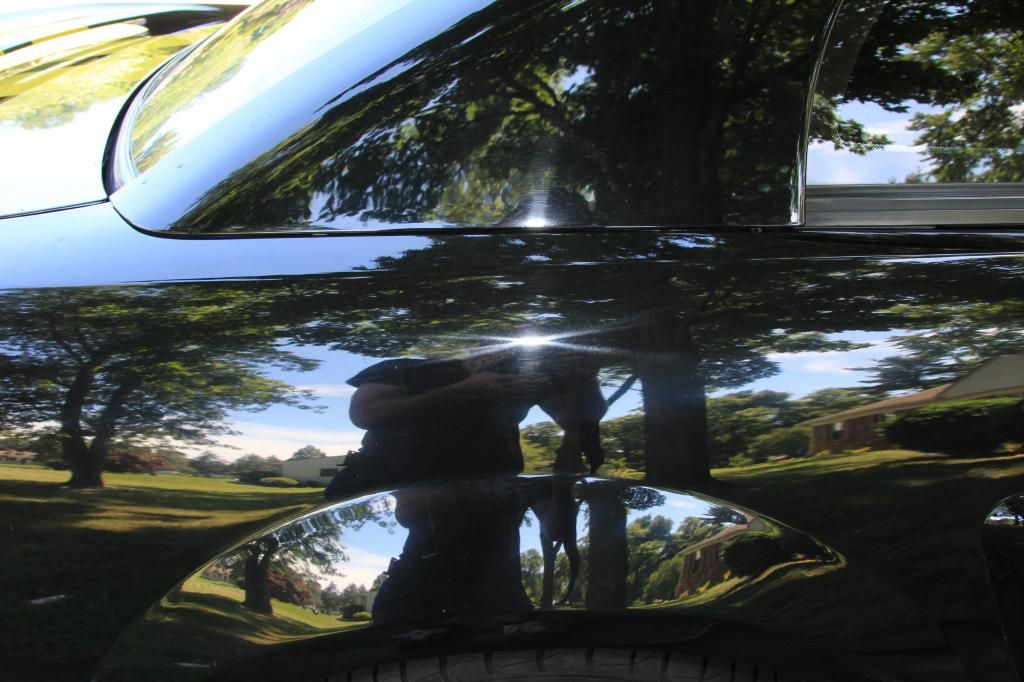

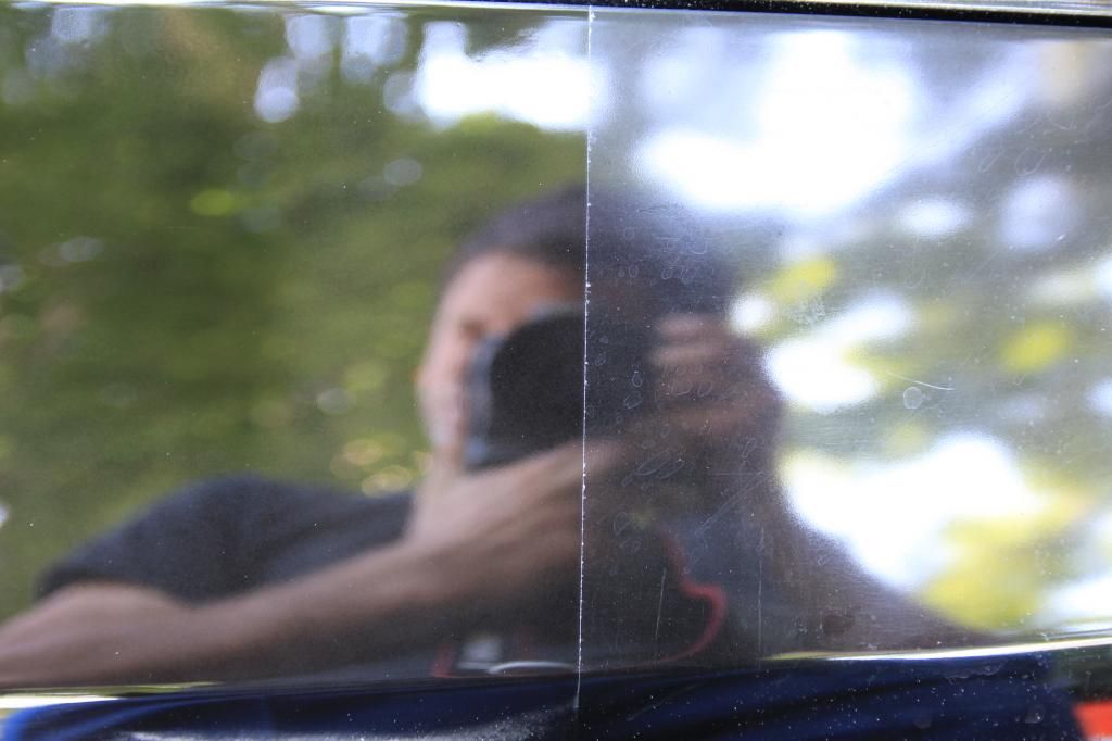

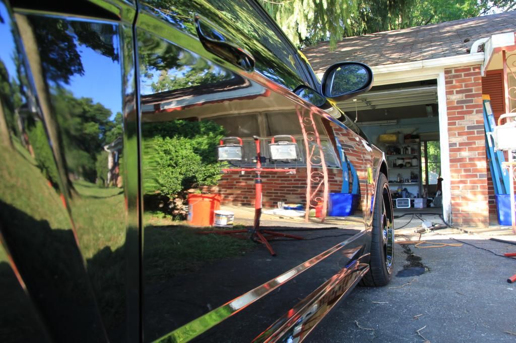

finished door reflection

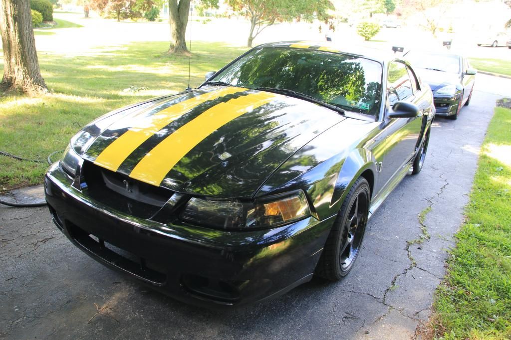

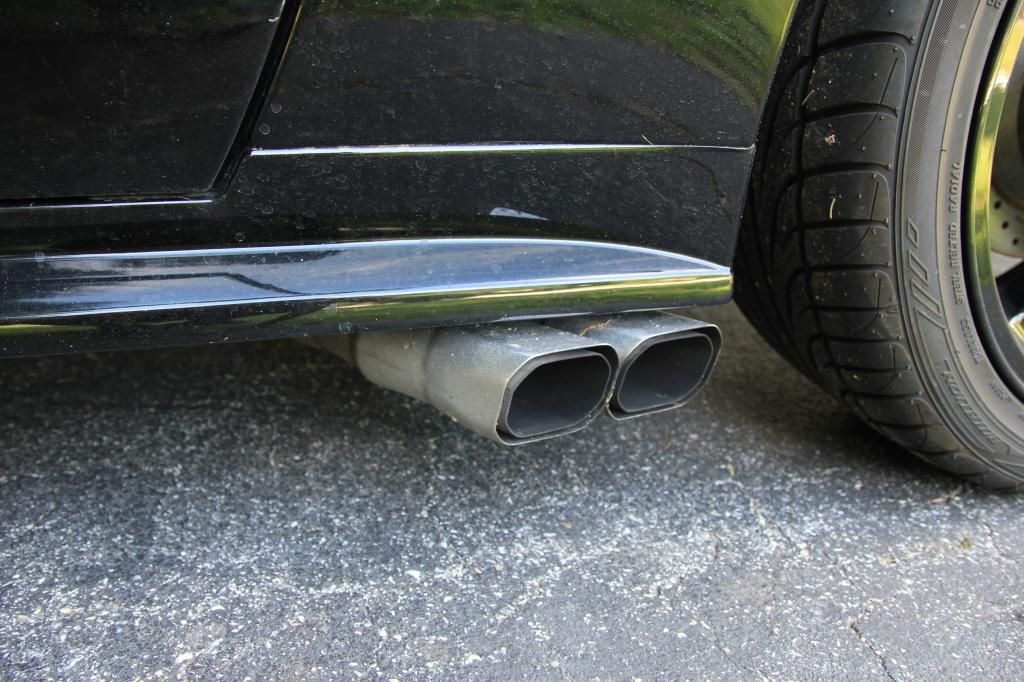

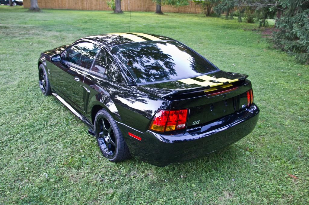

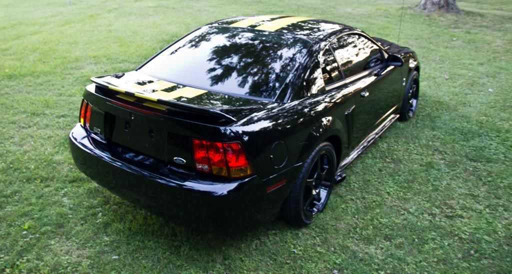

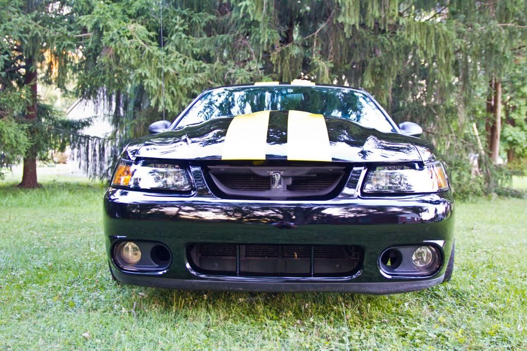

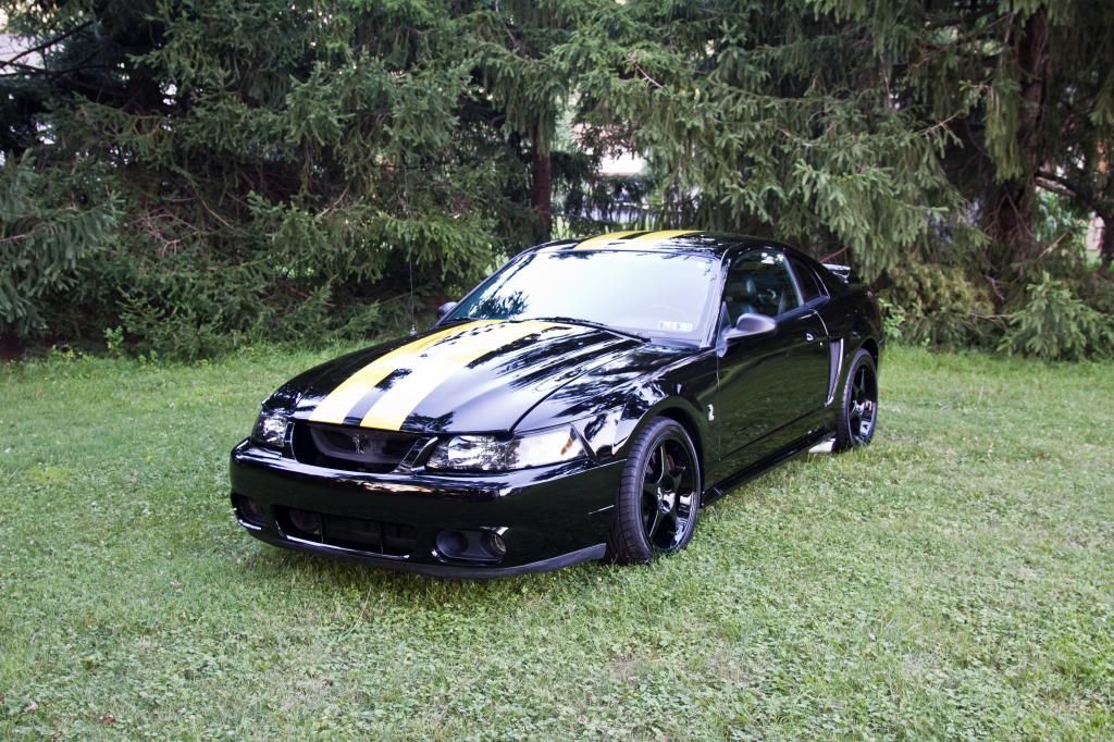

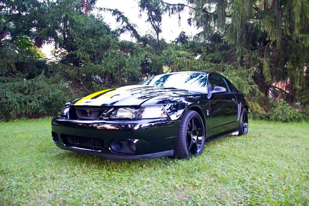

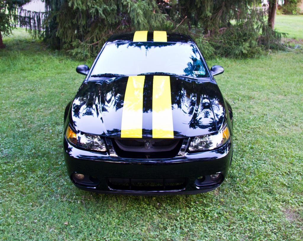

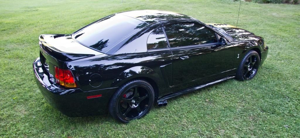

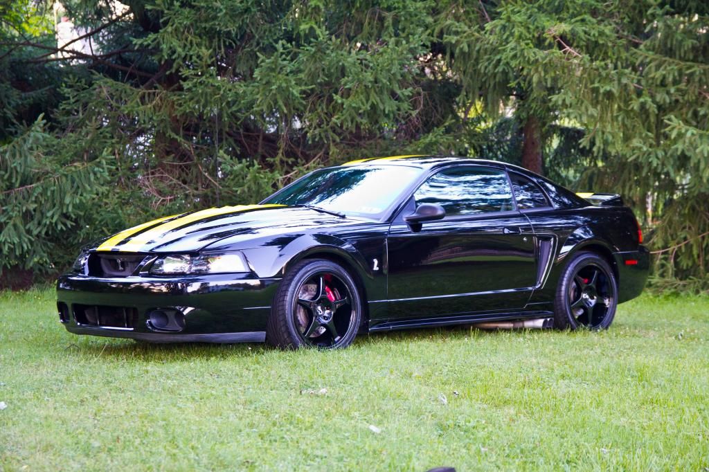

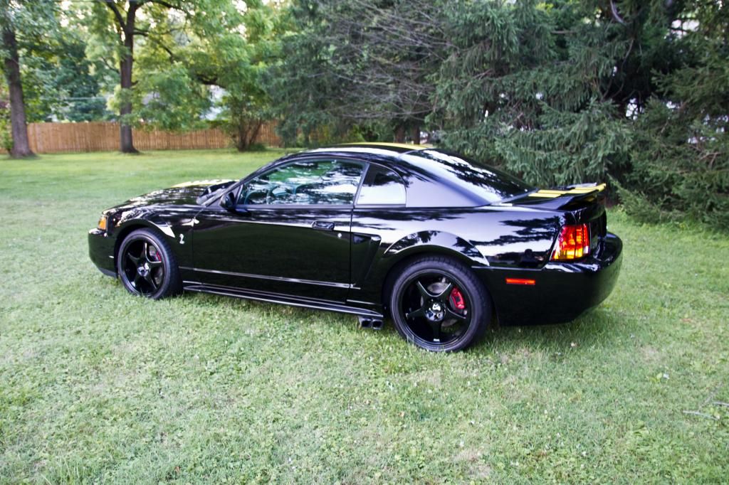

finished pics
car took about 20 hours
finished pics
