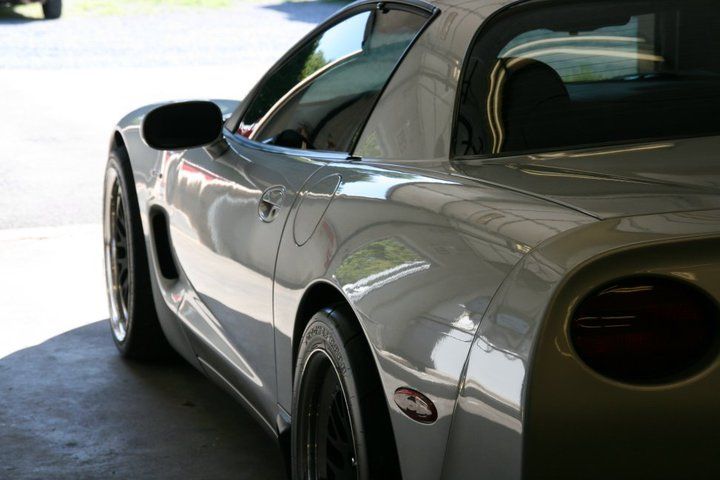

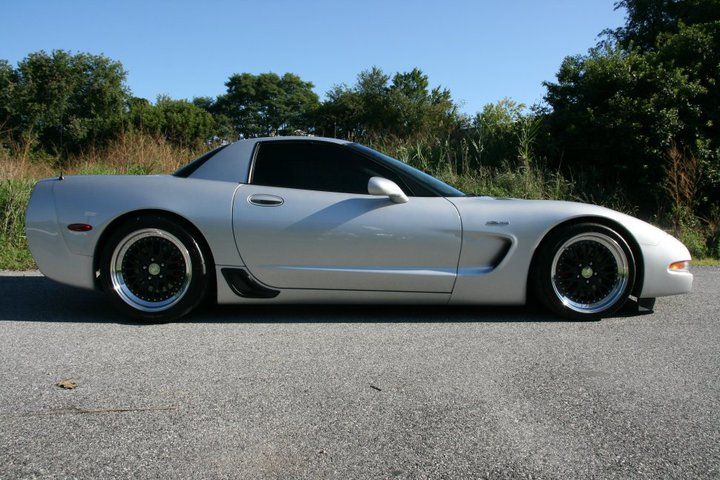

^agreed, after this paint i dont realy like them, had to use rotary on this paint which we usually dont use, even audi paint is softer compared to this (at least before they switched to water based paint or however you call it since 2010 audi paint is pretty soft compared to other years)
we had 2 of those vetts one after another, this was second one, first was silver but dont have many pics of that one so didnt do write up
