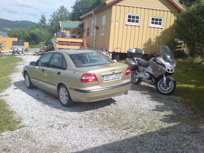

Hey!
New customer and a new volvo today! Waaatsup with volvos? I live to close to sweden :p
The car was not so bad, I have seen better and worse! I went with the pc and 360 today, and it got everything out. All the swirls, and some scratses. The interior was bad :( But I got it living again. Used 5 houers on this one.
Wash:
Clayed with pinnacle ultra clay
To buckets metode, with optimum car shampoo
Wheels washed with Meguiars hot wheels
Dp tire gloss on the tires.
Paint:
Pinnacle 360 on orange pad with pc
Topped with WG DGS
303 on trim
Klasse AIO on windows
Interior:
Vaccumed
Meguiars APC
Autoglym vinyl protect
DP krystal clear on windows inside and outside.

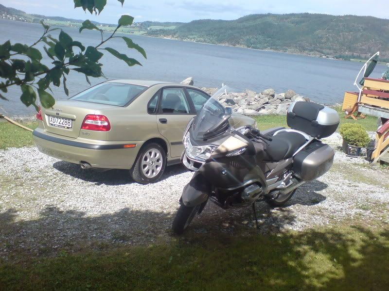

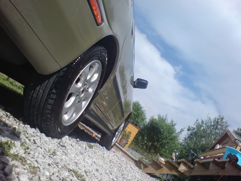

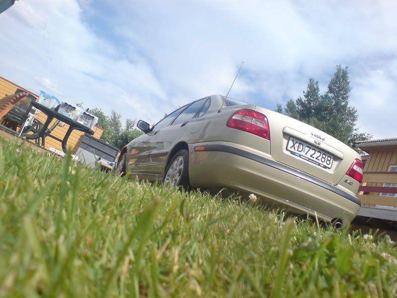

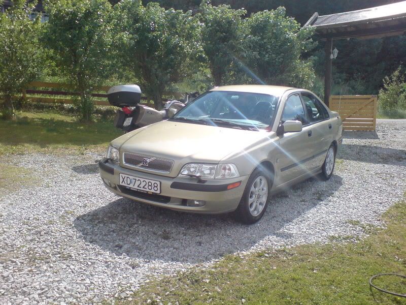

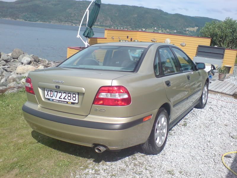

PICTURE TIME!!
Before:
After:
Looks great there pirex, I'm enjoying your pictures at different angles. Looks good. I'm surprised you went back to the PC after the experiance with the Metabo ;) hahahaha just joking. I can't see my self going back to the PC, even my Cyclo just sit's there waiting to be used :(...but it will get used.
Question, did you detail the BMW bike too?
Looks great! I really like that lake. Wonder how much properties cost out there?;)
Nica: Thanks buddy! Trying to make the pictures a bit more interesting :p I don`t think the 360 works that great with the metabo, thats why I had to use the pc :D Still love the metabo, got to share your love, Carlos :awesome:
The bmw is my fathers, no detail today ;) But I washed it yesterday :D
supercharged: Thanks! Come visit? :p Its not that cheap :p

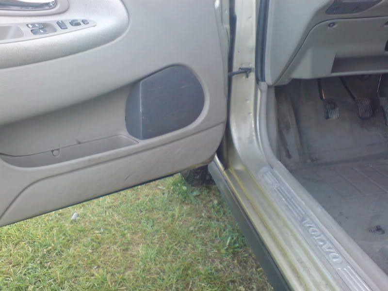

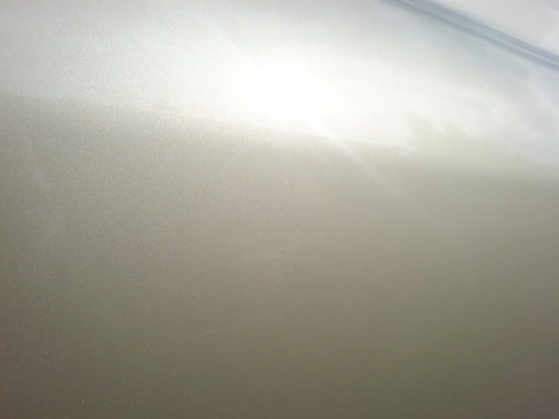

Do you have an after picture of the driver's side door?
You showed it a before pic and it was all marred, marked up at the bottom.
What did you use to remove all those marks? The 303?
I forgott to take close pictures after :( I used pinnacle 360, with a orange 5.5 pad on the pc at 6! 2 passes really slow! All gone!
