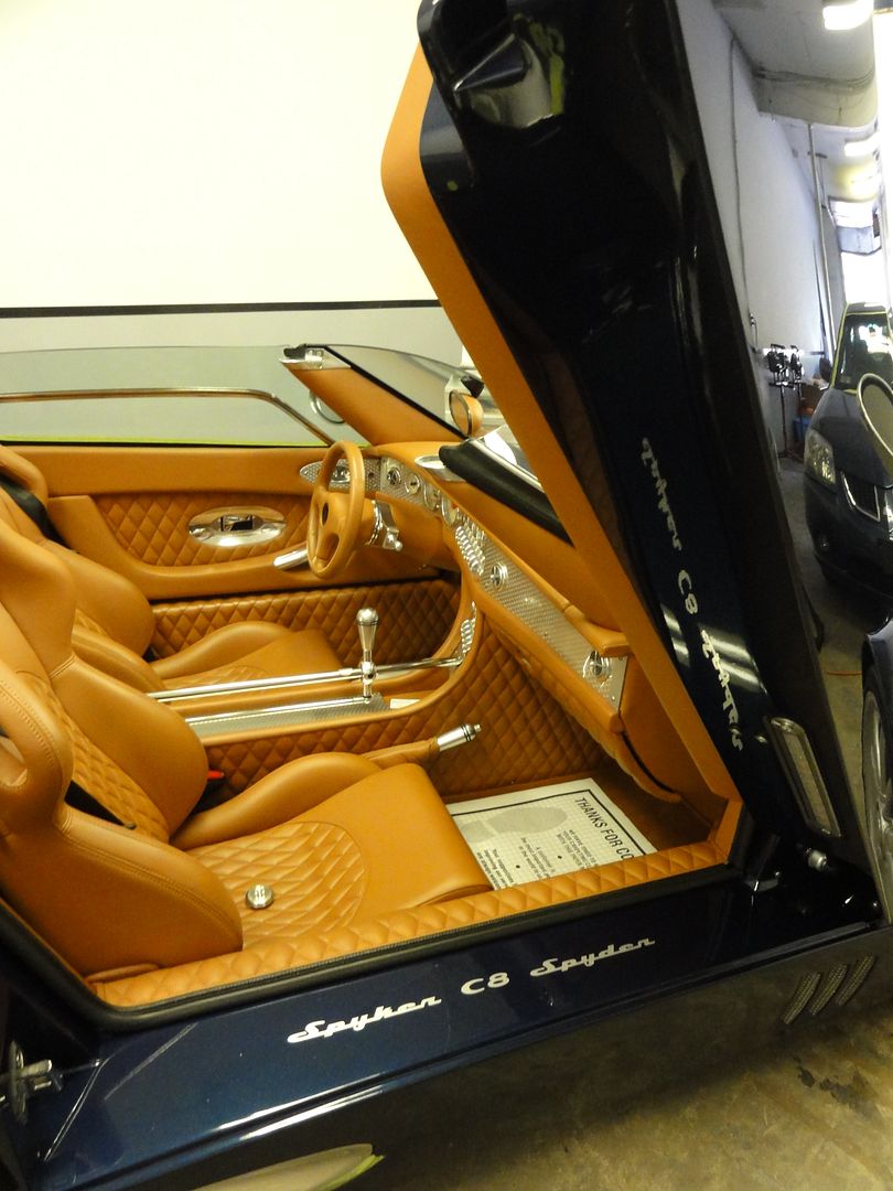

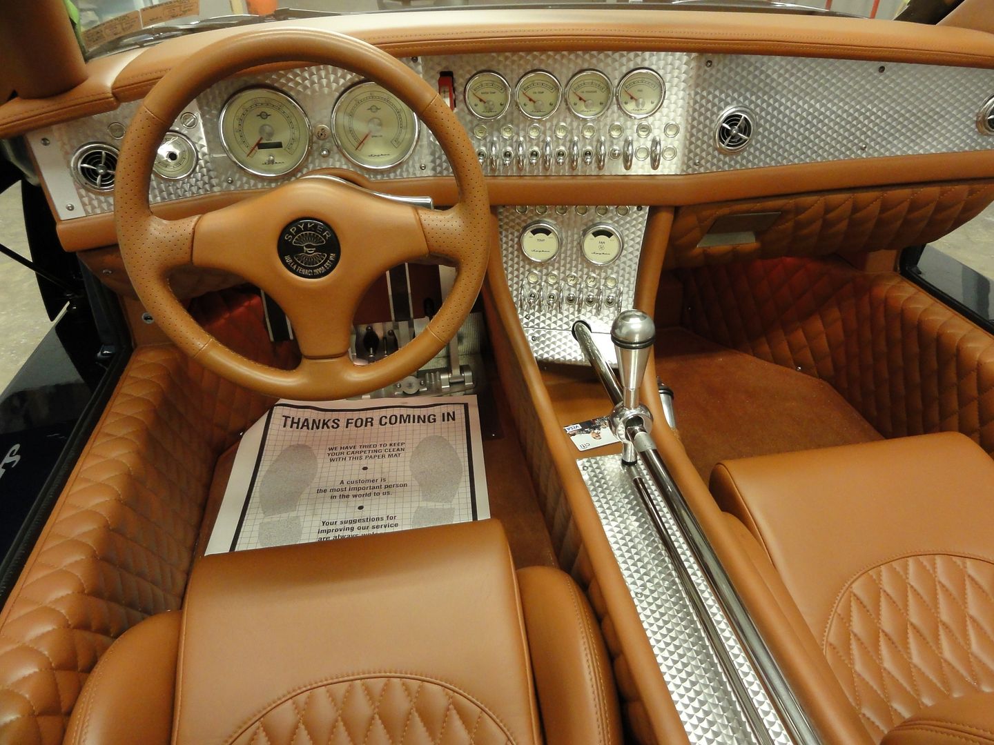

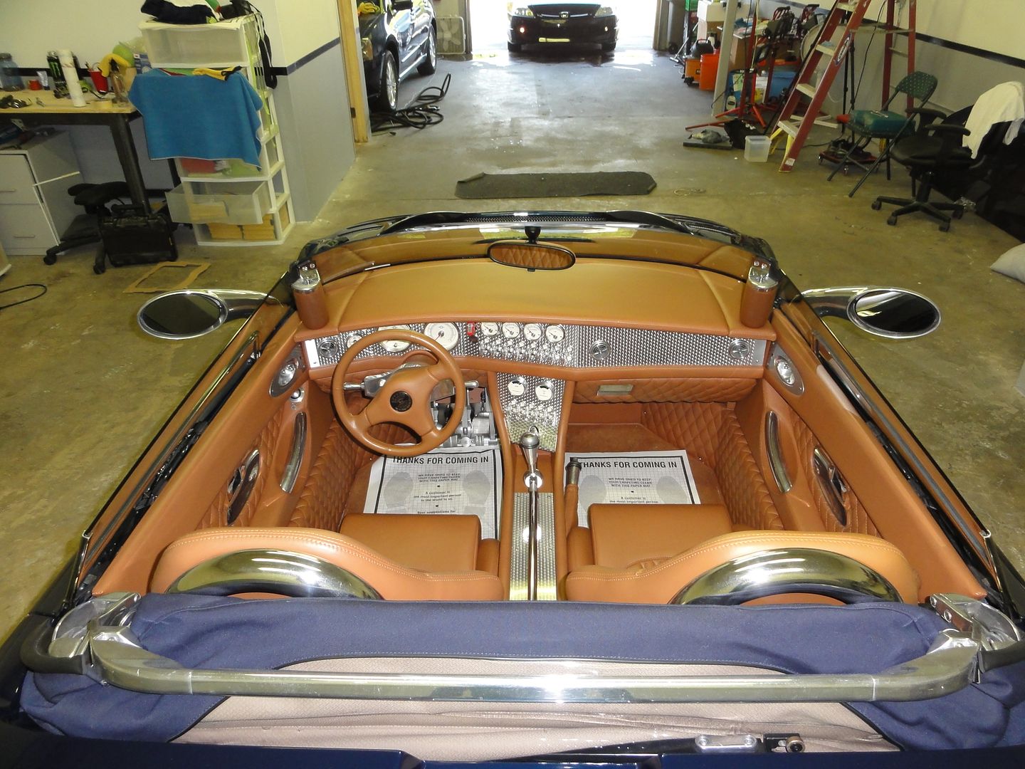

You got any pictures from the interior?
This car has the most insane interior out of any car I've ever seen.
That color is stunning, good job bringing it back!
here you go

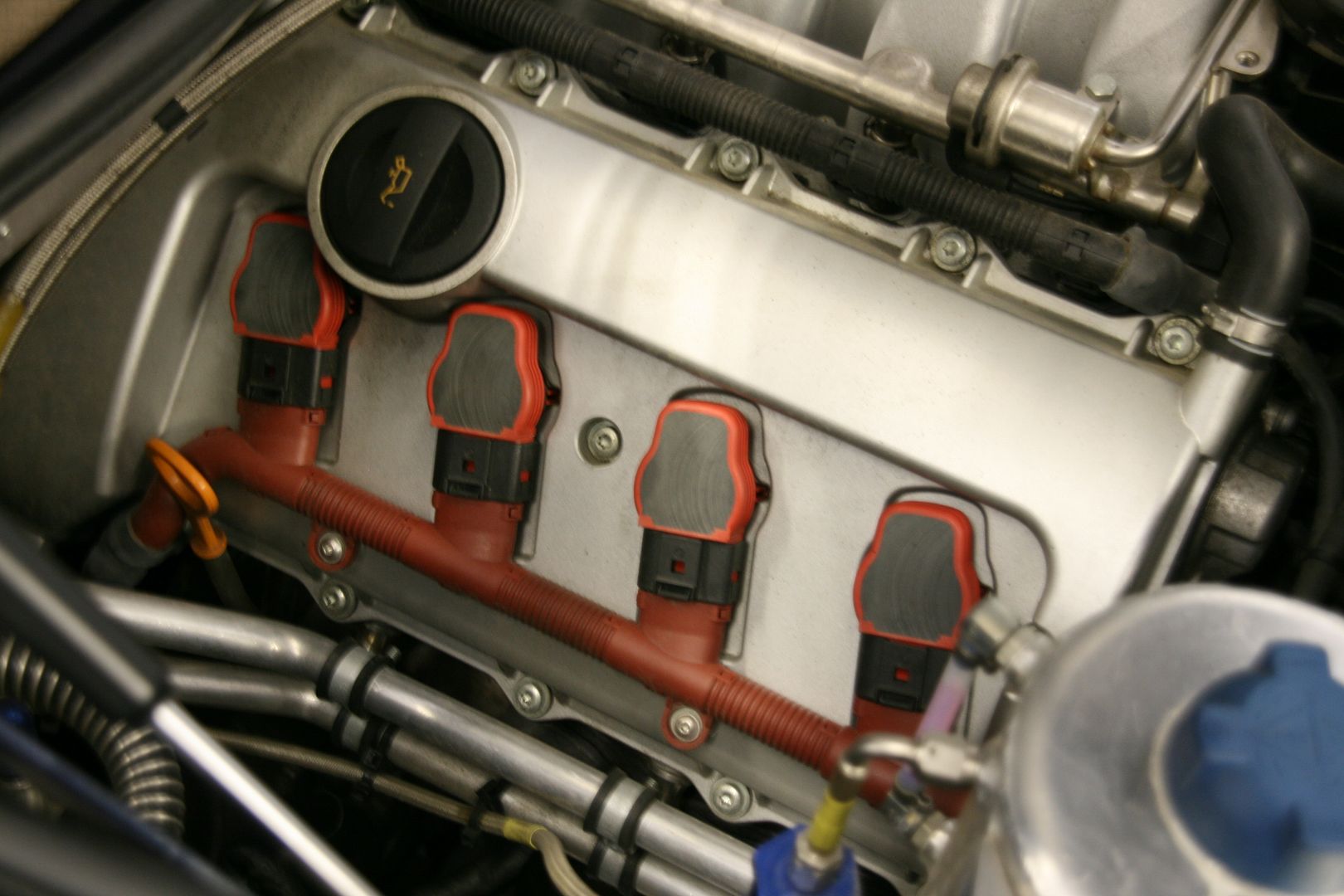

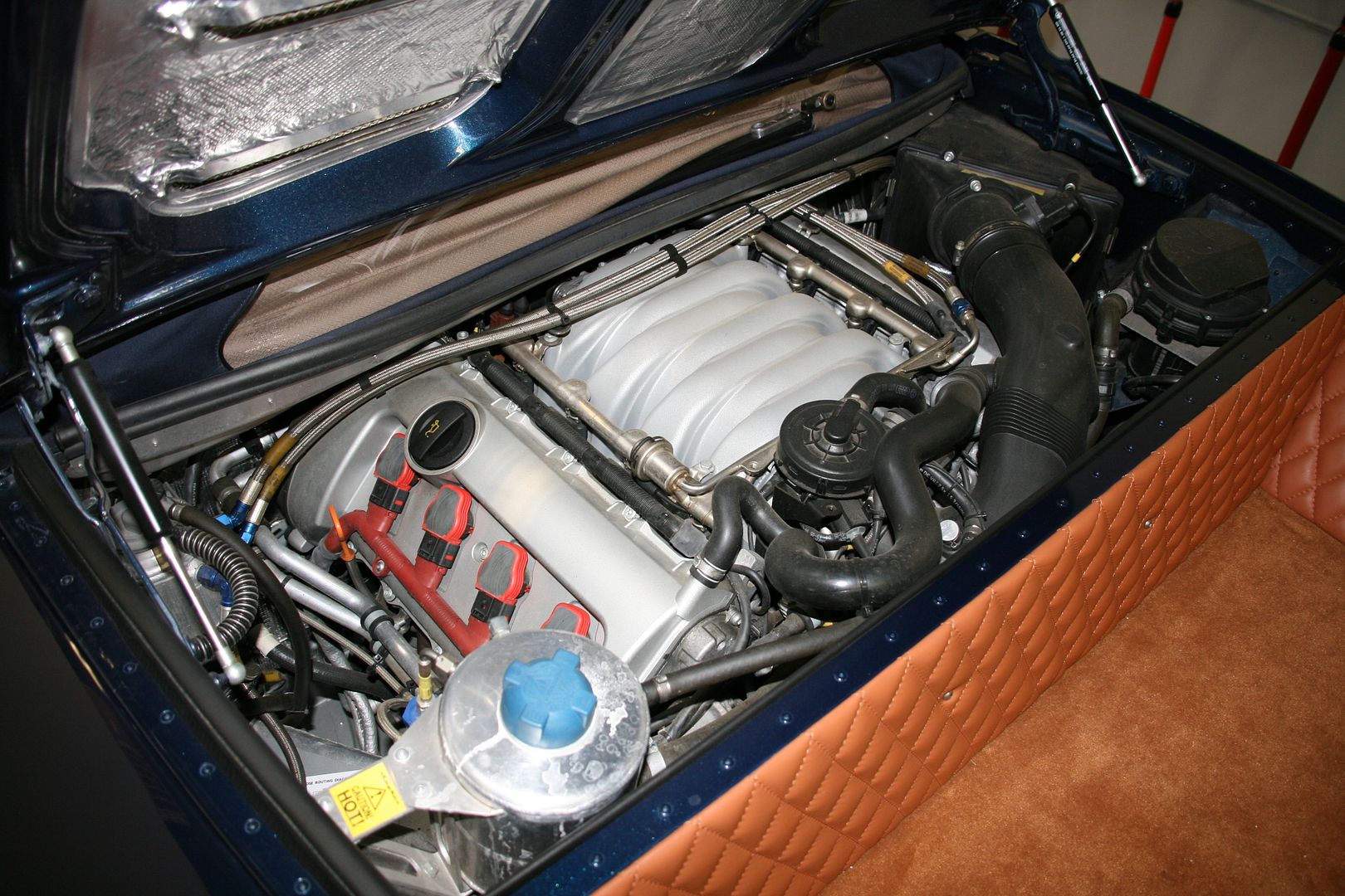

Do you happen to have any pics of the engine?
Stunning job and a great write-up.
your typical audi S4 4.2 V8 slightly tuned to put out 400HP ( i think regular S4 is about 340hp). not sure why they just didnt put RS4 engine in it. only difference is its RWD not AWD like s4
