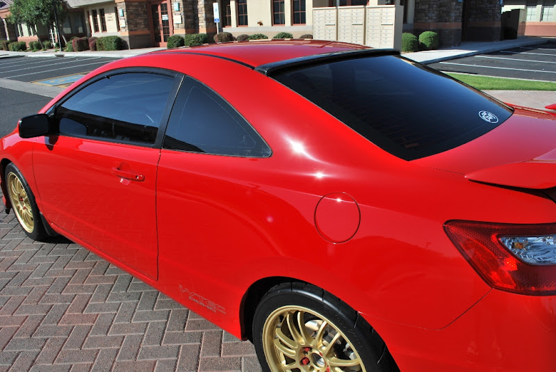

The following shots are the fruits of my labor:
Sun Shots:
Photoshoot:
What do you guys think? Comments and criticisms are welcome!!!
