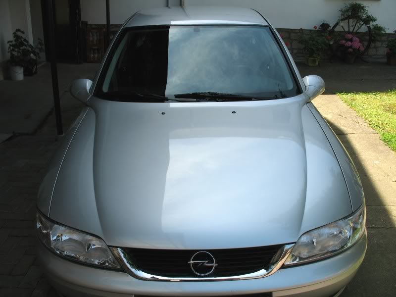

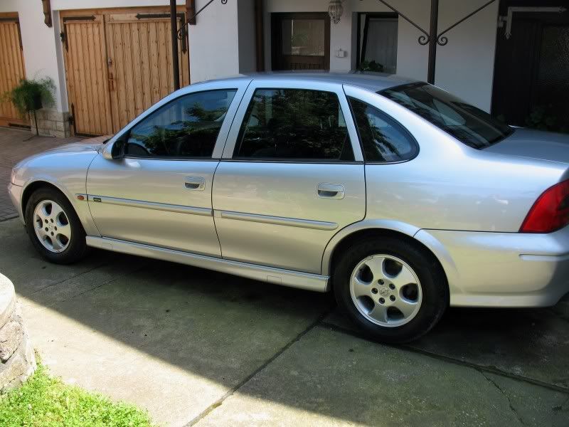

last saturday I detailed a Vauxhall (Opel) Vectra-B, Bj. 2000, 167.000 km, in silver. Tha car was in very bad condition. Sorry, no pics before.
After cleaning the interior:
The wheels needed two passes of Meguiars wheel brightener:eek: .
Outside I use my Rotex DA polisher with Meguiars #83 and 5.5 orange LC-pads. After that one pass of Meguiars #82 with 6.5 white LC pad. Hard work with the #83.:buffer:
2 coats of Meguiars #21 with four hours between the layers and at last one coat of Nattys blue.
Silver is not the best color to have great success, but it seems to be a well done job, isnt it?
Nice job...Yes it is hard to make Silver pop...especially in pictures...your work looks fine..and I know it looks better in person....
The Meg's Pro line works nice as a system...takes a little learning but when used right they do work nice....
Your work shows you did fine job....looks great

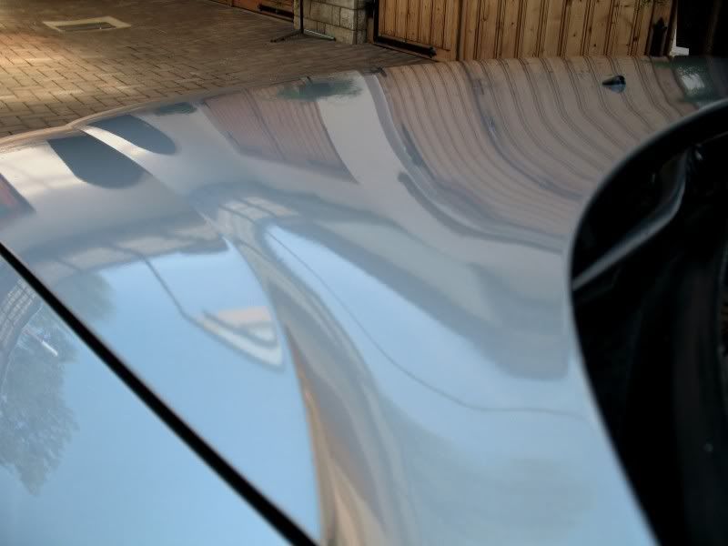

i agree with Al..you have a nice reflection shot along with your hood shot..the hood pic looks like shimmering liquid
