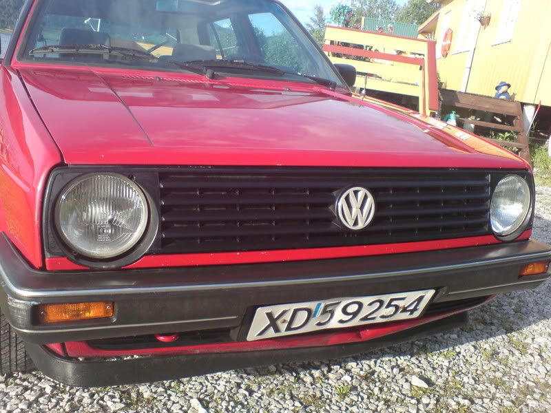

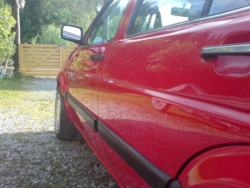

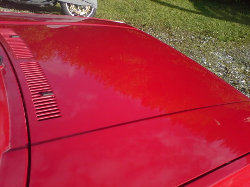

It have been a busy weekend, but a fun one to :D Did this car for my brother today, its his daily beater, poor thing looked really bad! Take a look at the pictures, it was baaaaad. The car came from baaaaaaaad town, not flaw less town! But I bet he is moving in to flaw less town right about now :cheers:
Clear Coat: VW GOLF, 1987, medium CC
Wash:
Degreaser on the lower panels
Clayed with pinnacle ultra clay
To buckets metode, with optimum car shampoo
Wheels washed with poorboys spray and rinse
Dp tire gloss on the tires. (Made my own mix here, put dp tire gloss in a spray bottle, mixed in some water, and just sprayed it on the wheels! Worked great ;) Time and money saved :D
Paint:
Menzerna SIP with orange pad with the metabo/
Topped with WGDG

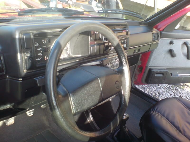

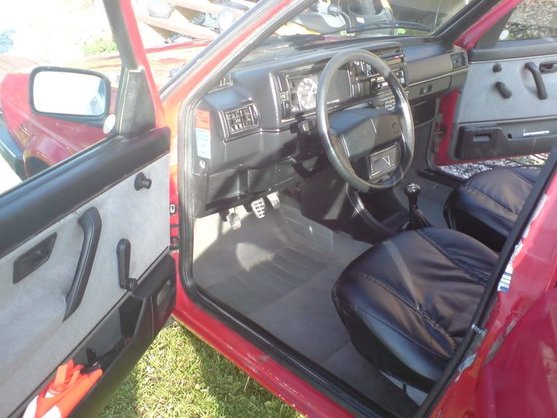

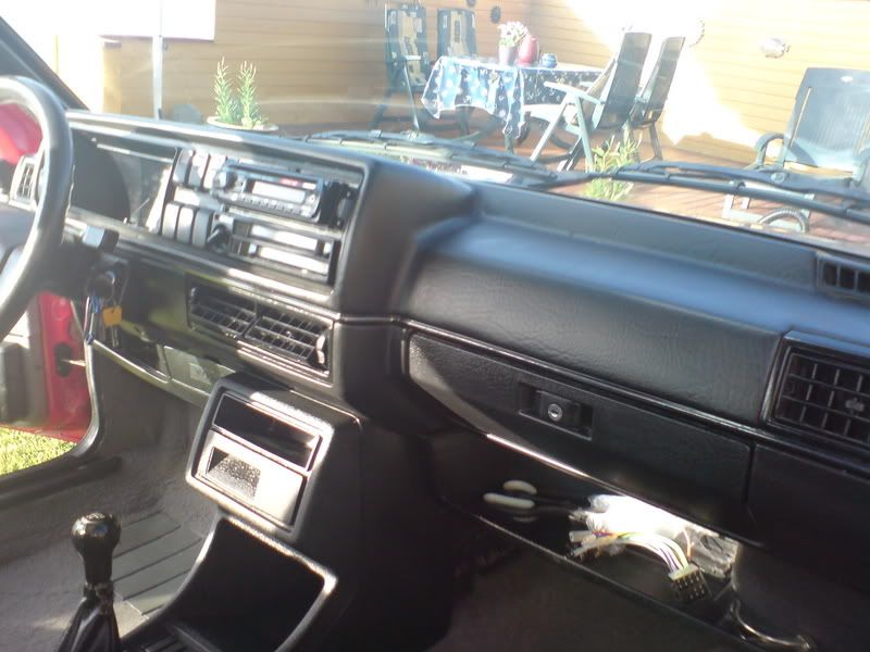

Interior:
Door jams with pressure washer and 303
Megs #40 on dash
DG odour eliminator
PICTURE TIME

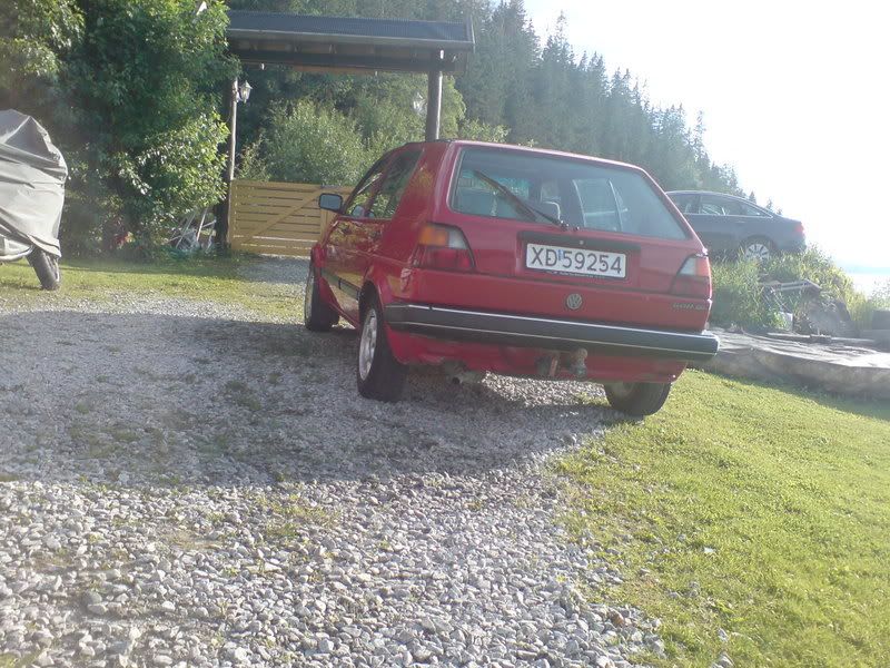

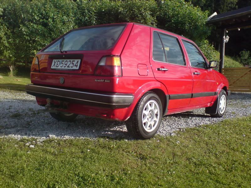

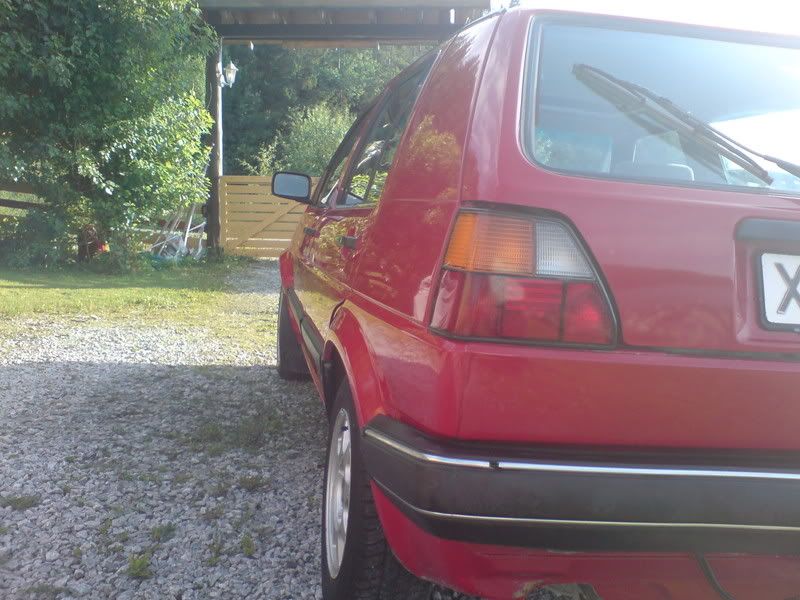

Before:
50/50
From this:
To this:
1/2

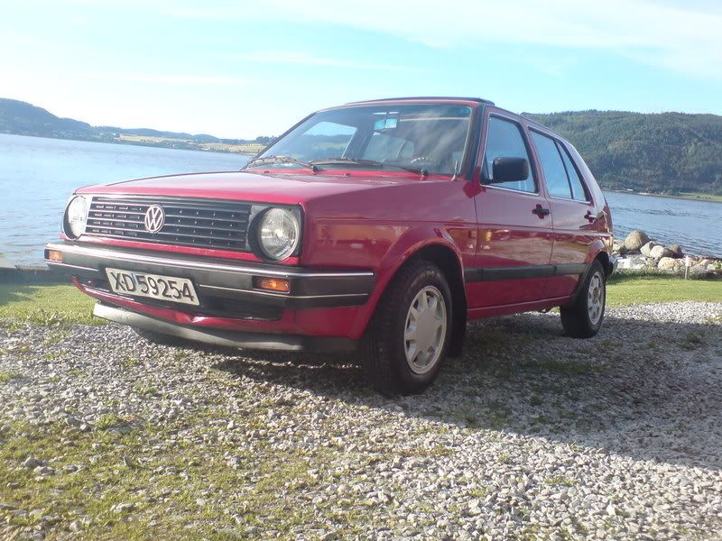

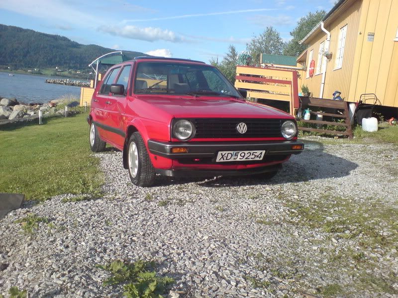

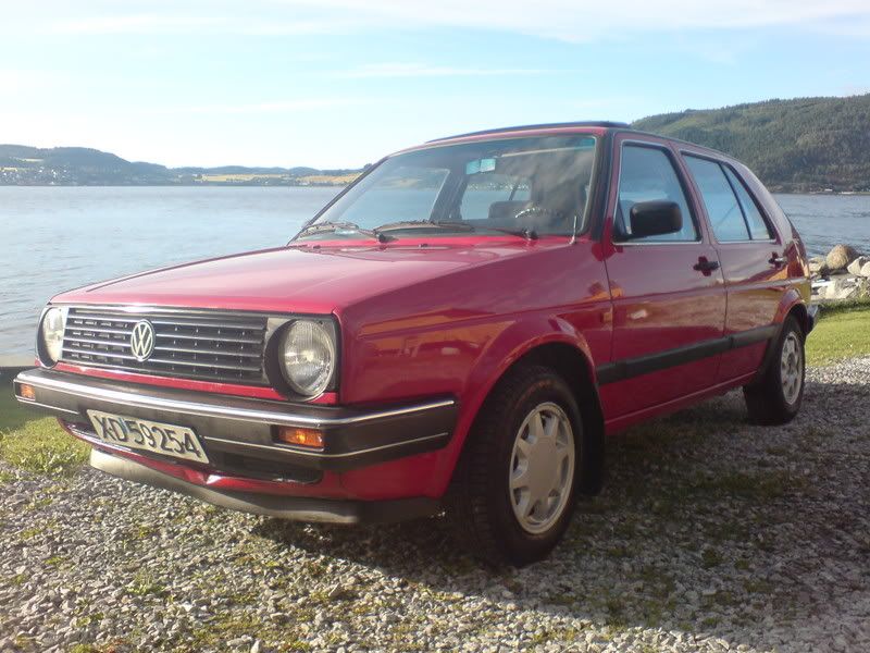

After:
Feed back please
2/2
Wow, what a difference! Could similar results be done with a PC or UDM? That is amazing how you took it from cloudy to shine. The WDGS looks great, I love that stuff.

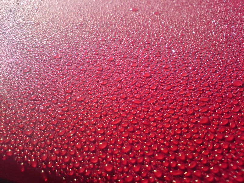

Tandis: I liked it to :p Its the beading of the menzerna, i rinsed the car after jusing SIP, before sealent.
joe.p: I know what you mean :D
zo6-goose: Thanks bro ;)
Reddwarf: Thanks buddy. :) On the first 50/50 I used pc with pinnacle 360, and it worked. But it took alot more time, and thats not good. So I switced to the metabo. So you can get the same results with a pc, but it will take you mutch more time. I love WDGS to :D

Pro work Pirex, love those Extreme makovers
Well done there pirex, you sure brought that paint back to life. Oh I too like the last picture of the beading. Very nice :righton:
A job well done!
i am surprised at the top = it looks like it has cc failure, or some serious damage, yet you fixed it. How did you achieve that? I am impressed!!
That Golf was really bad. Great job! Keep us updated on DP spray gel tire dressing durability. I really like that dressing myself. By the way, love your teaser beading shot.
Awesome turnaround, Pirex! That was some severe oxidation, and etching! I agree....you made a pink car RED!!
