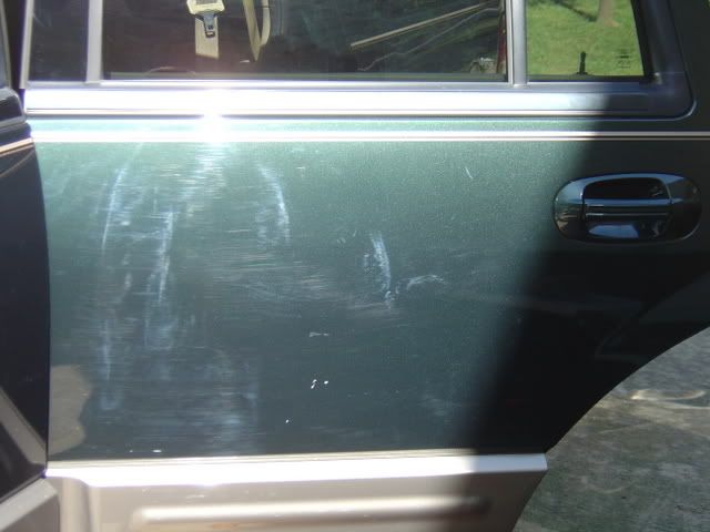

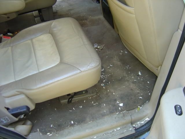

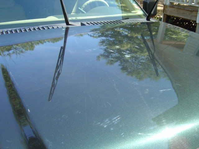

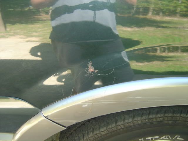

Let’s just start a thread based on everyone’s opinion on doing a "FULL DETAIL"
Explain the process using the three below cars. Products used…Whatever
The #1 Vehicle has moderate to light blemishes and a dusty, but not trashed interior.
The #2 Vehicle has been through a swirl-o-matic and the interior is scuffed, carpets stained, and the leather is poor poor poor....
The #3 vehicle is 3 weeks old and has pretty easy interior cleanup.
Explain your processes using #1,#2,#3 and tell me your combo from the tip-top of your head and we'll see everyone’s aspect of "DETAILING"
#1
#2
#3

1st Car
Engine- is fully degreased, AA or a protectand is applyed to the engine. Car is turned on and runs for about 5-8 minutes. A thourough inspection is done after this step. If any spots are missed or were not cleaned in that process, they are done by hand with my favorite product megs 40.
Exterior- Wheels, tires, wheel wells are fully degreased. The car is fully washed. I like dp 4-1 rinless wash the best. Car is clayed.The paint doesnt look in to bad of condtion, so mabe a light polish or something xmt 360 could take care of. Then a sealent or wax is applied. I like sig ser II. The wheel wells are dressed. Along with any other plastic pannels that look to need dressing. The wheels are cleaned and tires are dressed. All windows are cleaned. All polishable parts are polished. All door jams and nooks will be cleaned
Interior- Dash and wall pannels are white down with a mf to get rid of all the dust. If needed they are sprayed with megs. all purpose cleaner and scrubbed with a soft brush and white dry with a mf. They are then coated with megs 40. This product is great because you can control the gloss. The interior is then vacumed. The rubber floor mats are removed, degreased and hosed off. The carpets are cleaned with Blue Coral carpet cleaner..love this stuff...then a quick vacume to remove and residue. All windows are cleaned. The seats are also vacumed, cleaned and conditioned.
#2
Engine- Same as 1st car
Paint- Same as car 1...butthe paint on this car is going to need a little tlc. I would use rotary with cutting pad, and megs fine cut. I would then use megs 2.0 swirl remover with a polishing pad. Sig Ser II. Wool pad would be used if needed. last resort though.
Interior- Same as car 1.
#3
Engine- Same as car 1-2
Paint-Same as car 1-2 but i would use xmt 360 with a cutting pad and sig ser II to really make that pearl pop. Tires will get a little more tire shine, being a nicer car.
Interior- Dust away dash and pannels, and apply megs 40. All plastic is cleaned. Vacumed and carpets cleaned.
Im sure i forgot a few odds and ends but you get the idea
