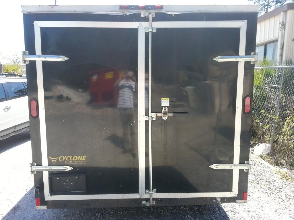

Friends 18" V Nose Trailer.. black

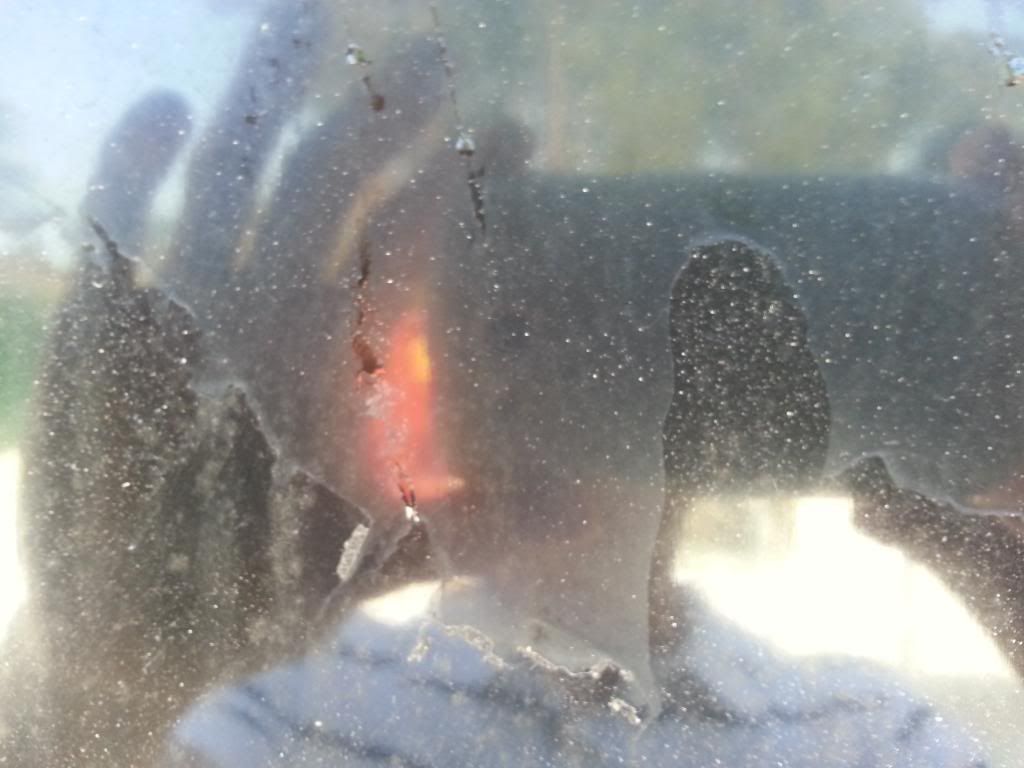

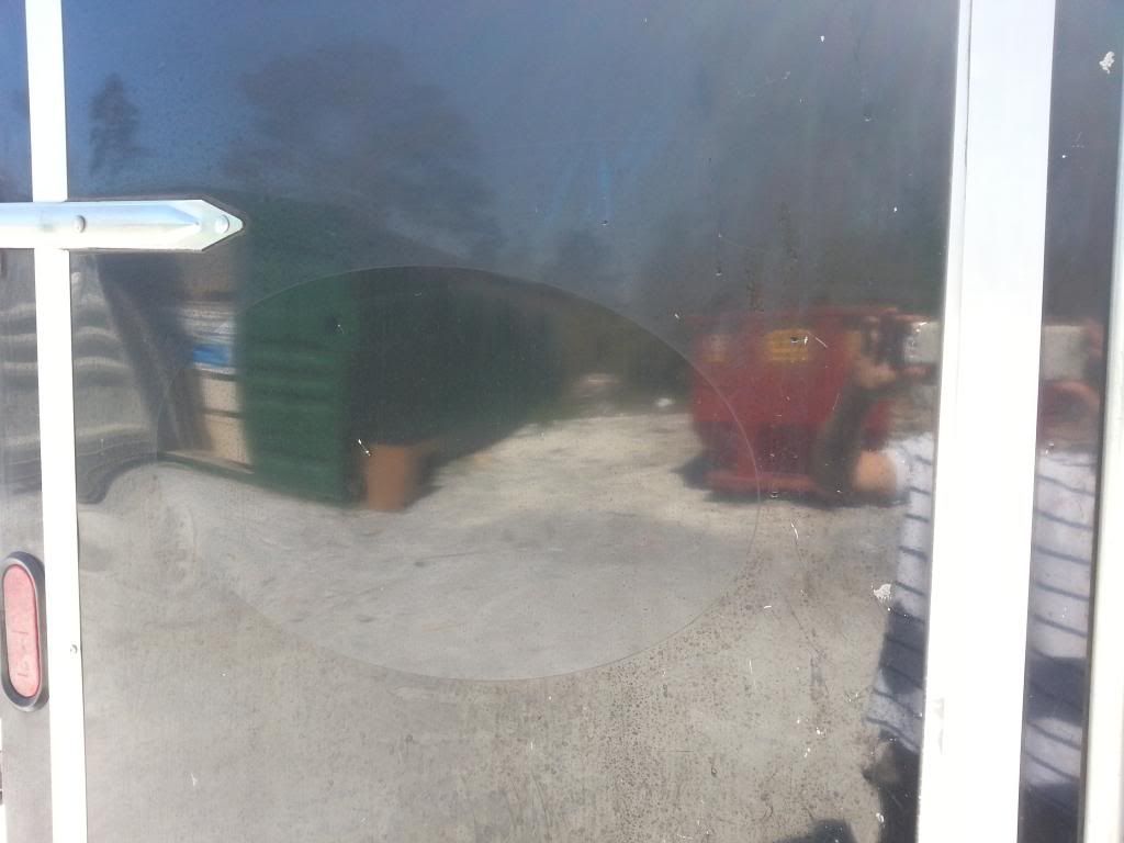

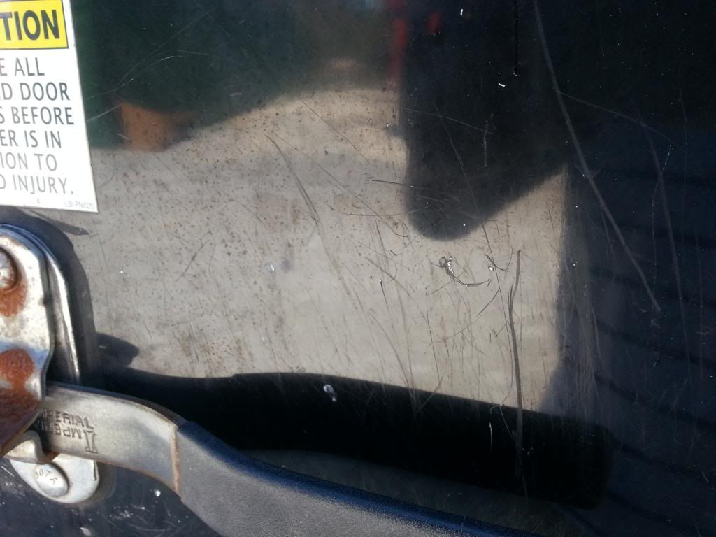

avg condition ( scratches ) some light peeling of some sort on one of the pics posted below)
Not looking for a Pro turn around on this
* Wants it Cleaned and some Protection from the sun.

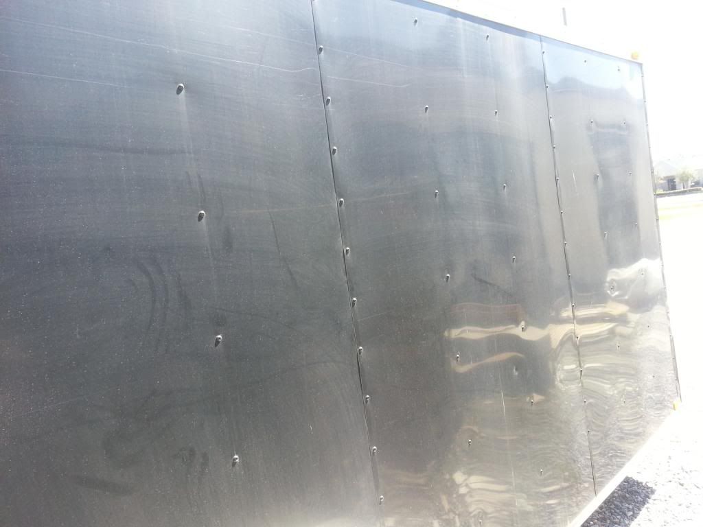

I was thinking.
Foam Gun blast
2 bucket Wash
Dry
and then
XMT 360 AIO on black Pad with GG6 at speed of maybe 3
Thoughts, suggestions and opinions?

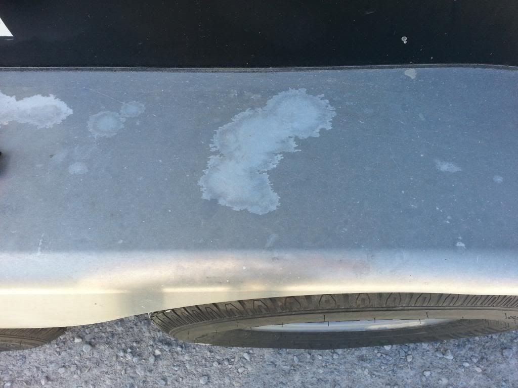

* Also he didnt mention the fenders but take a look.. what products can be used to clean these up?
^peeling I was talking about
^oxidized fender I'm guessing

Oy. My thoughts...
- Make sure his expectations are in-line. One pass with an AIO isn't going to offer much improvement.
- He's got a slick trailer and three vehicles....he can undoubtedly afford quality work. Lowballing only establishes you....as a lowballer.
On something like this, if you don't mind investing 30 minutes, I'd offer him a demo. Do a 2'x2' panel with a wash and AIO, followed by another with some corrective work...and perhaps a layer of sealant. Explain the pricing for both, and let him decide which best fits his budget. Good luck.
Agree with above and pick half your 2' test in that peeling area or do a smallwr 1' in the peeling area showing how its going to look just cleaned up

I know the baked on enamel paint is usually very thin.
But I do appreciate the thought on offering him 2 packages.. a simpler clean or correction work and see which panel is to his liking.. He may not want a full turn around as this is simply a workhorse for him.. however I would guess that the trailers appearance is still of some importance.
Would you recommend for correction i just polish and then seal?
Seems no need to compound as it may be a bit over the top?
It was awhile ago, but I think this one I did with M205 and then sealed with Collinite 845.

What did you use on the Fenders?
the paint on that trailer is VERY,VERY thin.........use caution!
The last one i did, I used megs mf cutting pad and d300 and then sealed with coli845 came out very nice. (speed 4 on my GG)
the fenders are aluminum...Mothers Aluminum Polish,will make them shine like a mirror.( I used a 4" tangerine lc hydro on speed 3 for this and looked better than new)

Polish with a more agressive pad should do the trick but try it. It's going to depend on the paint. M205 is a great polish that finishes down really nice. Rather than a polishing pad like LC white pad try a tangereine or yellow cutting pad with M205 or equivalent. BUt do a test spot so you know where you stand. Once you get the finish uniform it should polish out easily.
For the diamond plate Flitz will kich a$$ not sure you have any but worth a try.

Like dad07 said above, über thin paint. My race hauler is a 24' and is black. I gave mine a one step and Opti Coated the crap out of it. I used Menz SIP on a white pad via the Flex 3401.
What materials do you usually work with?
I have never worked on Diamond Plate the only thing I have for it I thought that may work was . Mothers Mag and Aluminum Polish.
I figured If I needed to pick something else up and since I don't have time for something to ship in I could find something to work with from autozone, pep boys or advanced auto parts for the D Plate.
From memory, I'd bet it was orange or white pads. I tried to use up some of my older, beat up pads as there are a lot of sharp edges on some of these trailers.
For the fenders, it was probably Optimum Metal Polish or 105 for the bad stuff. I usually use junk 4" pads for metal and then toss them.
