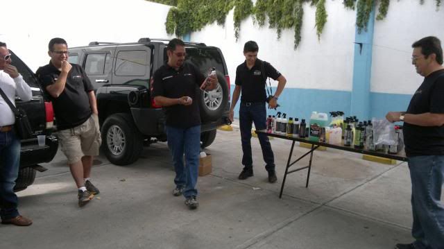

After the representatives put their products, we started to give the event’s shirt to every assistant

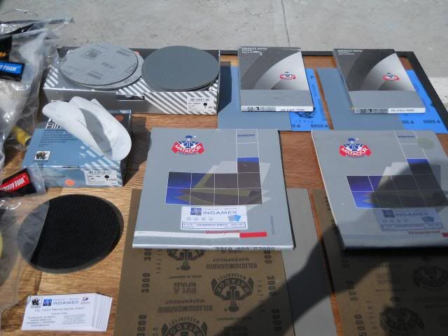

Sandpaper: wet and dry systems, sandpaper gradings and charts, and grading differences (CAMI, FEPA and JIS).

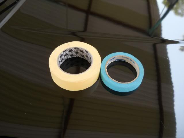

And for last, how important the use of Masking tape is when doing a detail.

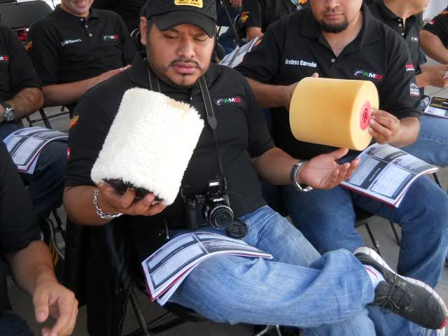

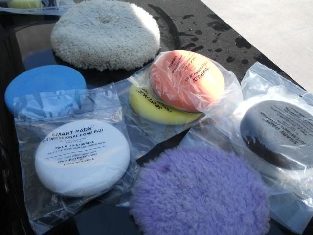

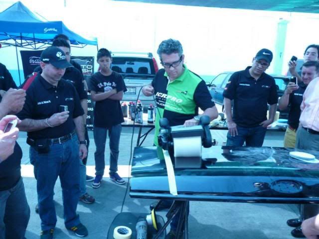

Different foam pads were shown to the assistants: from wool pads to specialty pads like Lake Country’s foamed wool pad.
These pads are from the Buff Pro Machine: one foam pad and the cutting wool pad
Some people were new to Microfiber pads which were also shown
After the pad topic, I asked Victor Aguilar from Indamex to give a brief explanation about the difference between wet and dry sandpaper, and how the backing affects the scratch pattern.
What he explained was that film backing makes the scratch pattern much more uniform than a paper backing in a sanding disc (or normal sandpaper in which most cases they’re made out of paper), because paper is not as uniform as the plastic backing. And after some testing made further, this is true.

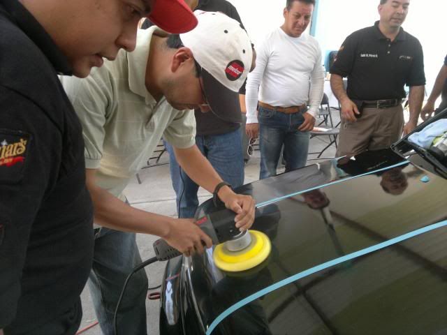

Once the areas were sanded the tests started. The first one to give it a try was Luis perez using Meguiar’s M105 and the Rupes LHR15 orbital polisher with the Rupes blue compounding pad.
After polishing his section 4 times, most of the dry sanding marks we gone.

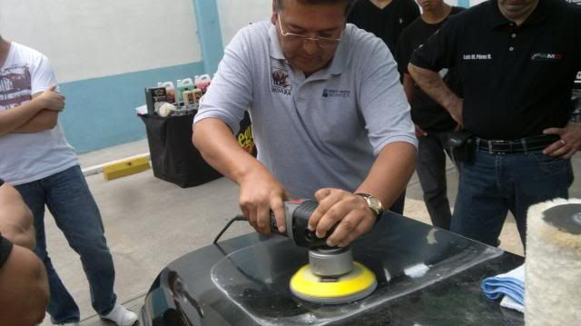

Jesus Castillo was the next one to give it a shot using the Buff Pro drum polisher and Menzerna FG400. Since the paint was pretty hard and he tried in the P1500 sanded area, it needed one more compounding pass to remove the marks completely.
What most of us saw with this polisher, is that instead of leaving holograms, it will leave horizontal and vertical scratching which would be the hologram it leaves.

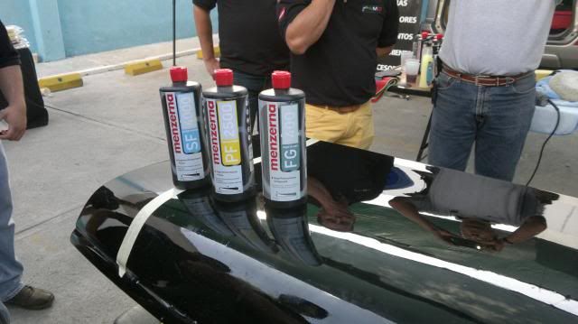

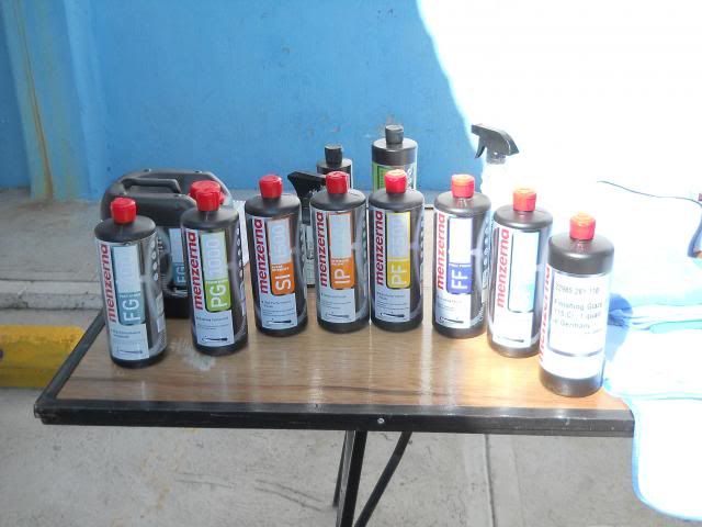

The last demonstration was from Menzerna. The products used were FG400 using a wool pad, PF2500 on a yellow SM Arnold medium cutting pad, and SF4000 with a black finishing pad to do the finishing step.

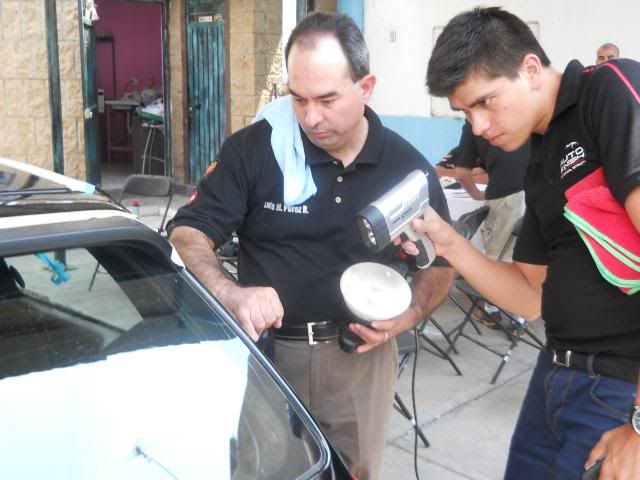

After it was done, the surface was checked with a Brinkmann swirl finder light, revealing an almost perfect job.

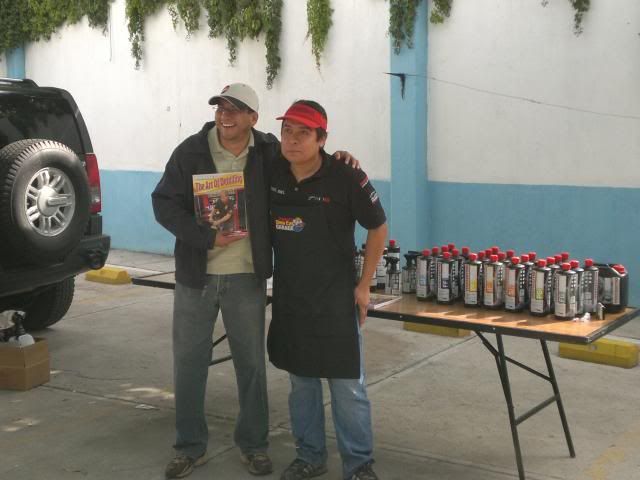

Sergio Perez was the first one to win the Art of Detailing book
All other representatives also received a copy of the book with an Autogeek apron
Francisco also won the book

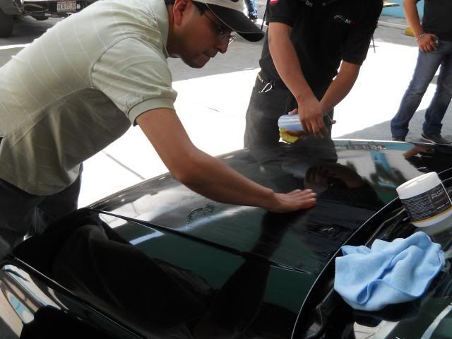

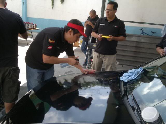

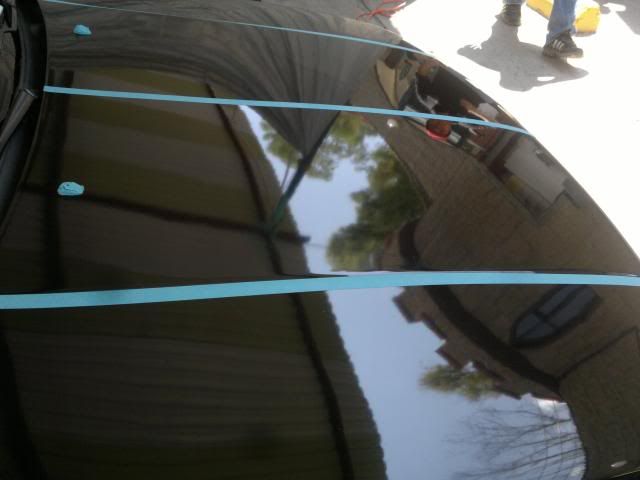

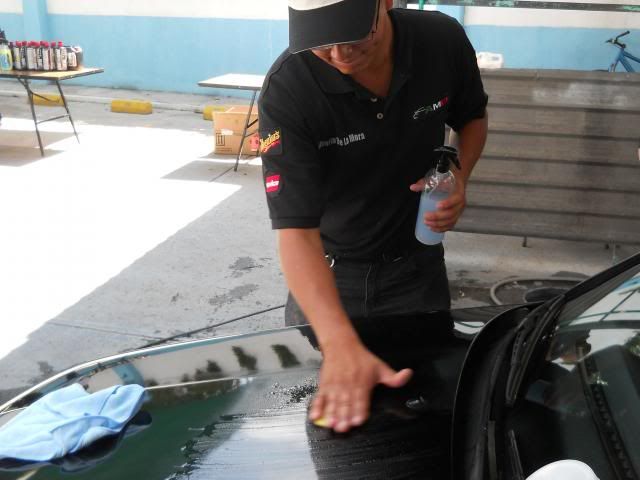

After washing the car we started the contaminants inspection. Then we proceeded to clay the car using the aggressive clay from Meguiar’s since the car had white overspray that was very bonded.
Oscar claying the hood, and Beto preparing his clay and surface with enough quick detailer to start the process
Beto claying his section

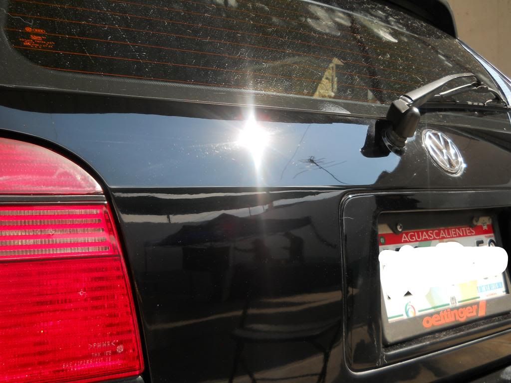

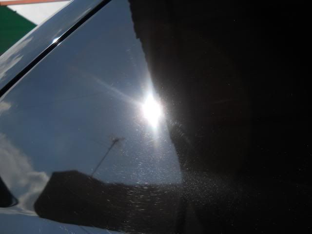

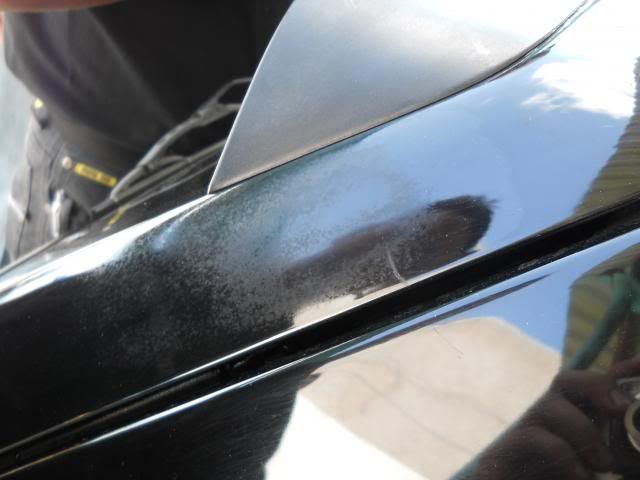

Since the other pictures came blurry, only one showed clearly the condition of the hood. Pretty swirled up

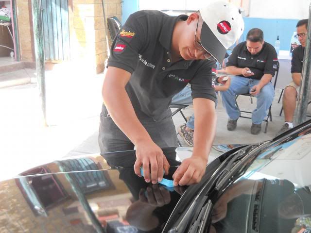

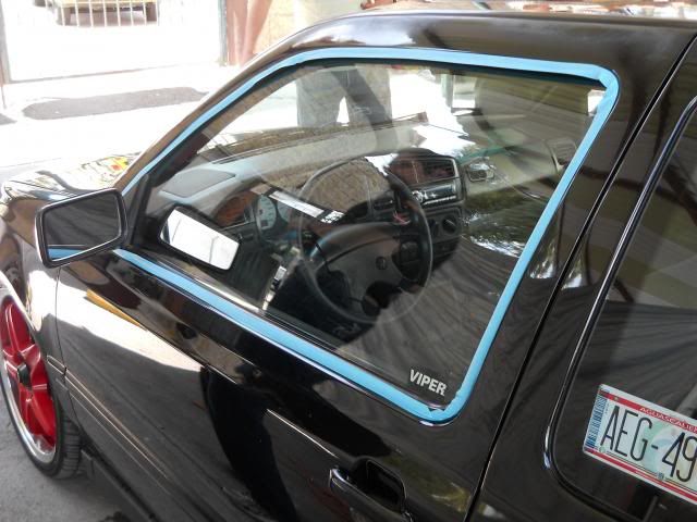

Before starting to machine polish, we taped off the car so no moldings were exposed to any possible damage.
Daniel taping the door moldings with the Indasa 2” masking tape
Miguel taping the window moldings using Norton American blue masking tape

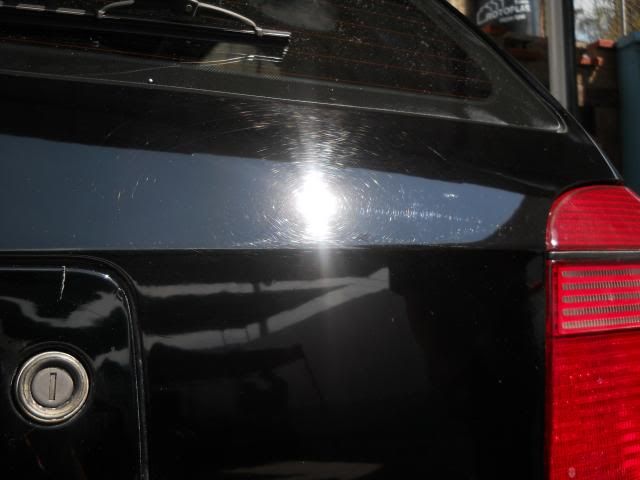

The best thing about this car is that it had almost all defects, including some parts with clear coat failure.

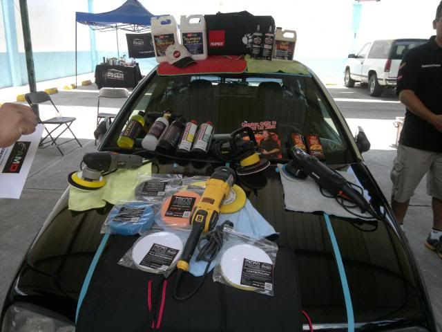

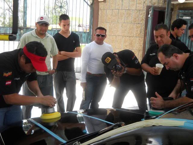

Now that the car was taped off and the hood divided into 4 sections, it’s time to buff:

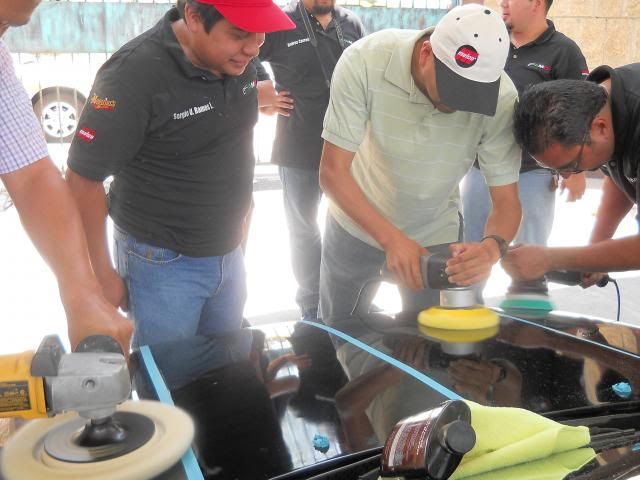

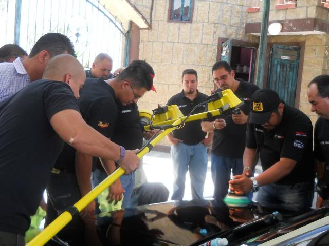

While I was showing how to use the PC to the less experienced ones, Luis started to use the Rupes with FG400 for some testing with other skilled detailers to see what could be achieved
Now it’s time for Oscar to use the PC with Pinnacle Advanced Swirl Remover to remove defects
Meanwhile, Dante is using the Rupes polisher to see how it performs vs a standard orbital polisher
Now both in action

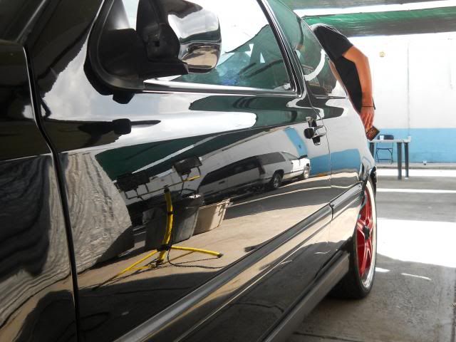

The results
These results encouraged the newer ones to machine polishing, since most people believe at first that paint correction is something not so easy, and getting near to perfect, to perfect results is almost impossible for someone with little experience. They saw that doing things correctly and having patience can lead to excellent results.
Checking out the results in the sun
