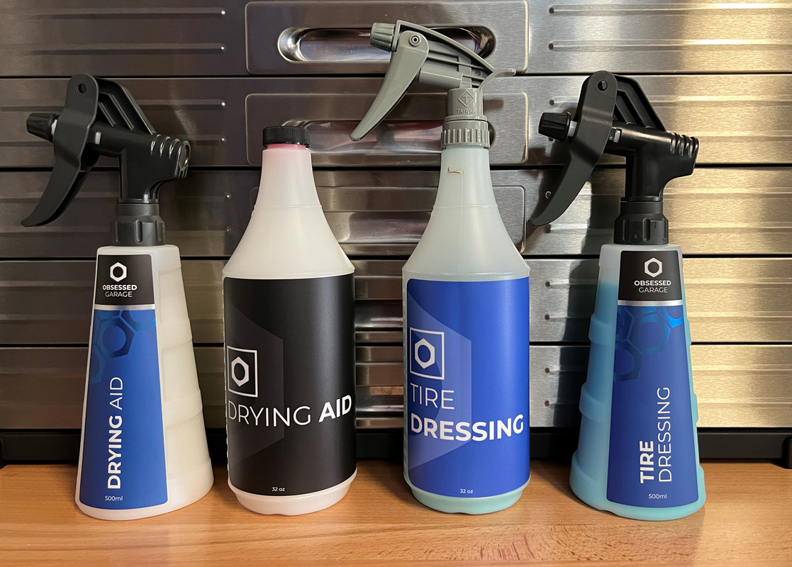

Nothing special on this one, it just HAD to be done. But it did give me a proper chance to see how these new Pressol Pro Series sprayers perform.
I've used the original "household" versions for a while now, with and without the chemical resistant "Industrial" spray heads. Those heavy-duty heads had to be purchased separately, which increased the price by $15 on top of the bottle/sprayer price. And even then, the Industrial heads still failed with alkaline chemicals. I actually stopped bothering with them and just used the household sprayer. The trick is to purge the chemical back into the bottle and flushing the sprayer with clean water after each detailing session. I've been doing that with both head types and have had about 15-months out of them so far. The reality is, you shouldn't have to do that on a premium purchase like this when a basic $7 Tolco will outlast it 3 - 4 times over.
The Pro Series spray head has upgraded internals, so there is no longer a need for the "Industrial" version. At $32+ per bottle, I'm not going to subject these to high-impact chemicals, especially when replacement heads are not available. With ADS Amplify being a high-use product, I decided to put it into the Pro Series.
The first thing to note is how nicely the new stainless-steel tip atomises product. Having said that, I actually prefer a slightly heavier dispersion to limit chemical drift and overspray. Perhaps this is why I never cracked a single one of those old plastic tips, I just wasn't cranking them down as hard. The trigger action feels smoother too, although that could be a new vs well used situation.
At the end of the day, you are only buying these Pressol bottles and sprayers if you are insane like me. That's because on pretty much every metric, a $7 Tolco or Canyon sprayer with a generic bottle is going to do the same job, just without the double action trigger and weighted pickup tube for 360-degree spraying capability. The question is, are those two benefits worth an extra $26? And if those last two aspects are important, then Kwazar Mercury is $14 cheaper and as good if not better than the Pressol.

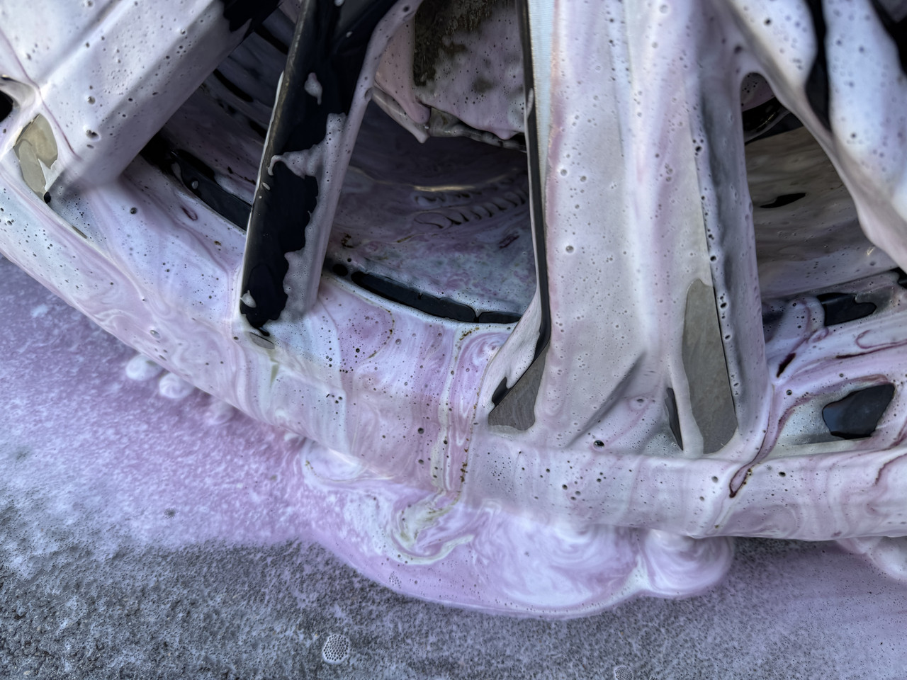

The photos don't fully show how putridly dirty these wheels were.
Wheels & Tyres -
Sadly, these wheels weren’t coated with the rest of the car, same with the glass. I can cope without a glass coating, I really don’t see the point there. However, I wouldn’t dread cleaning these wheels if they’d been coated. That’s because of the super dusty brake pads, the hidden lip behind the spokes and the sheer size of the things. So, I always need the nuclear bomb to deal with them.
For the pre-clean, I grabbed Carpro WheelX. I hate this product, but considering the Carpro theme I decided to peg my nose and give it another go. And…………….I still absolutely hate this stuff. I love Carpro products, but this is the worst smelling detailing product I have ever encountered, and it’s not balanced by added effectiveness above other competitors. The stench is so revolting that those inside the house could smell it, and I still have it up my nose as I type this after a shower. I used up most of the bottle, the rest is going in the bin. Do not buy.
I then foamed P&S Brake Buster over the WheelX, allowed to soak, then rinsed. From here, I scrubbed the tyres with Shine Supply Wise Guy, then foamed again with Brake Buster for the contact washing with an assortment of brushes. Another Carpro product, this time Hydr02, primarily to assist drying and gloss enhancement. These spray and rinse sealants don’t offer much protection, and the pH tolerance window is extremely narrow.
I just wish I had the time to remove, properly clean and coat these 21-inch wheels.

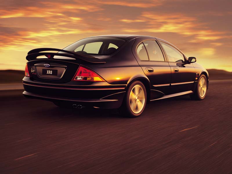

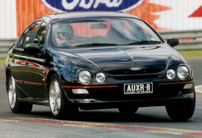

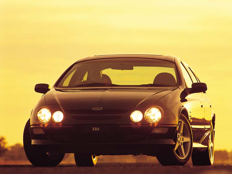

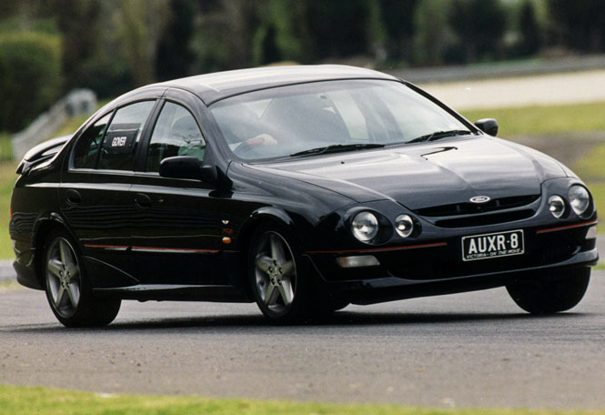

Wow, someone REALLY wanted one of those! Being the series 1, it's the least desirable of the AU model, and being an AU in general, the least desirable and most despised Falcon of all time. And I say that as an AU Falcon lover.
The AU series Falcon was launched in September 1998, so this is a very early build. It has the optional Tickford body kit which added the door cladding side skirts, front and rear aprons and the bi-plain spoiler (Tickford was Ford's Australia's BMW M, MB AMG ect). The wheels are from a 2013 FG Falcon XR6, 18-inch in size and 245/40/R18 tyres. Colour is Hot Chilli Red.
The engine in this series 1 is a 5.0 Windsor V8, but someone has added a series 2 engine cover. The XR8 had 185 kw (248 hp) instead of the standard 175 kW (235 hp) available elsewhere in the range. That extra power came from a dual exhaust system, so they sounded amazing............even if they were slow. Transmission was either the Borg-Warner T5 5-speed manual or the BTR 4-speed auto. Being an XR8, these got a double wishbone rear suspension that was based on the Lincoln LS and Thunderbird, also used in the Jaguar S-Type. Front end was also double wishbone. The best part of these cars was not the engine, but rather the brilliantly tuned chassis and steering. The brakes were horrible though, 287mm disks and single piston calipers all round.

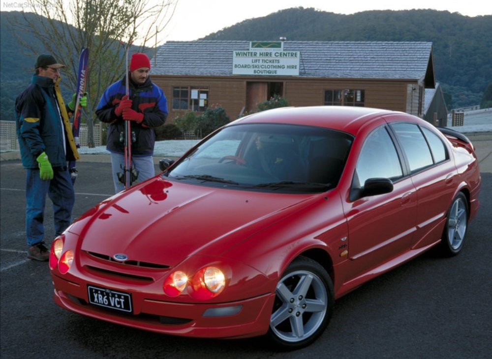

This is an XR6, but it has the same body kit as the car in the ad. It also has the optional Tickford 17-inch wheels with 235/45/R17 tyres.
Note the bi-plain spoiler...........................
Regular spoiler, also note the lack of the body kit..................................
They may have been slow, but the Windsor had that old school V8 note.....................probably because it WAS an old school V8.

The XRs were the best looking AUs, in my opinion, saying that as former Holden fanboy as well. I honestly don't remember the biplane spoiler, it does look a little silly, but I've always preferred lip spoilers.
