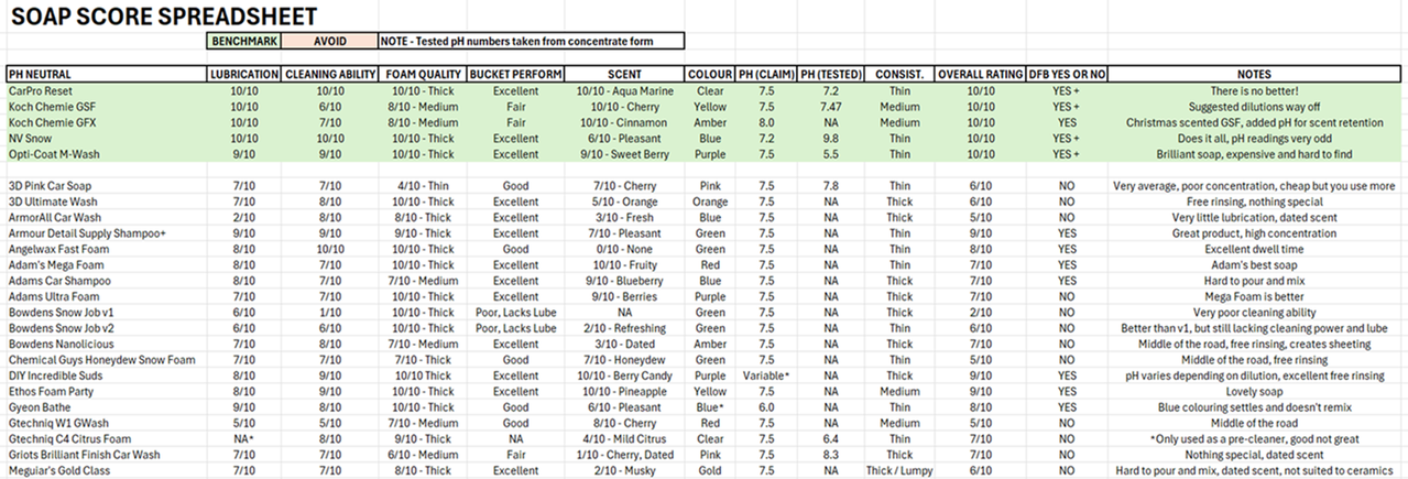

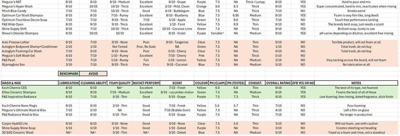

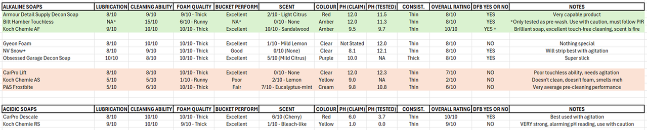

DFB's Soapy Notes
A condensed spreadsheet view of each soap review, current as of February 2026.
I have also made some minor score adjustments here and there to account for further analysis or newer products surpassing previous high scoring products. Products highlighted green are winners, those in peach are sinners. Overall, these are my usage notes, observations and measurements that I achieved, your milage may vary.

Hey Deyon, I'm sure you know this already, but what's your thoughts on ADS working on an acidic soap?
That's an odd one, from memory there was doubt from ADS about the effectiveness of that type of soap.
