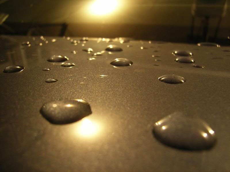

I've never used any bonding agent. The pic below is DG105 after 2 1/2 months with NO washings or any kind of maintenace. I applied DG105 by hand directly after polishing with XMT3:
That is a cool picture.
