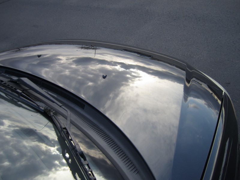

I cut a circle as best I could out of a LC CCS orange pad,I trimmed off some of the the face of the pad so it wasn't too thick. The pad is very crude looking,and I'm sure there is a better way to cut and shape the pad. I used the P E8 Flex 1" backing pad and Menz. 400,polishing speed set at 2. I scuffed up my old hood with 3000 grit paper and tried it out. You can see the dull scuffed side and the polished side was swirl free. No sun today so the pics don't do justice. I'm sure in a pinch it might work.....

Here is another pic of the job done. The scuffed side was done with 3000 grit paper. I made 6 section passes with the Flex PE8 on speed 2 setting. For a crudely circle it did a swirl free job. Now to find a way to cut perfect circles,THEN, cut the face of the pad down evenly.......I love a challenge...View attachment 50100
