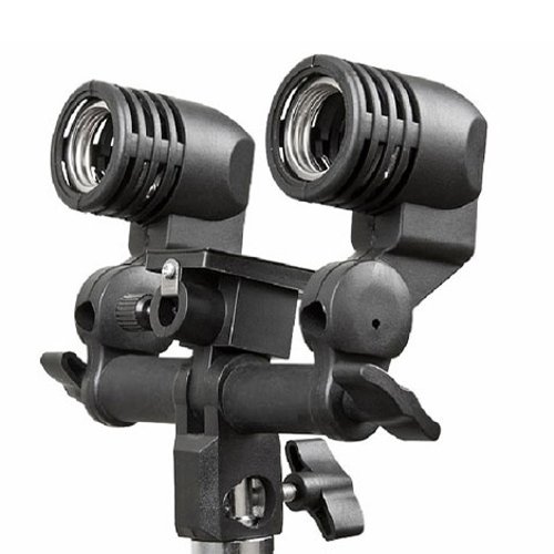

With this design in mind, I set out to find an easier way to accomplish a similar setup. Given that I am a photography nerd, I remembered seeing a dual light bulb base setup that would work great for this. I set out to amazon and quickly found what I was looking for, and for only $9.
Photo: Dual Bulb Base on Amazon
I then searched my local hardware stores to locate some suitable LED spot lights that would fit this base. I was able to find these LED bulbs that are daylight temp (much better than the warm tones of halogens!) and 1400 Lumens each.

Dual Bulb Base: $9

Light Stand: $15 (Amazon Link)
Dual Bulb Base: $9 (Amazon Link)
LED Bulb (par38): $38 (x2) (Lowes Link)

Sorry - I tried to add links to the OP, but it had already been more than 20 minutes so I couldn't edit. The stand is a very basic light stand used for photography, I already had several of them laying around, so it made this even easier for me... See my reply above for links... and yeah, the energy savings will be very nice as well :)
