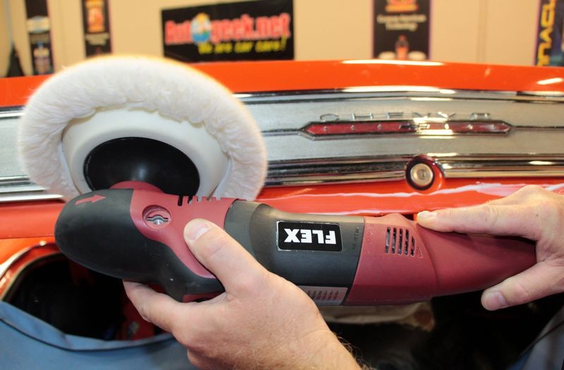

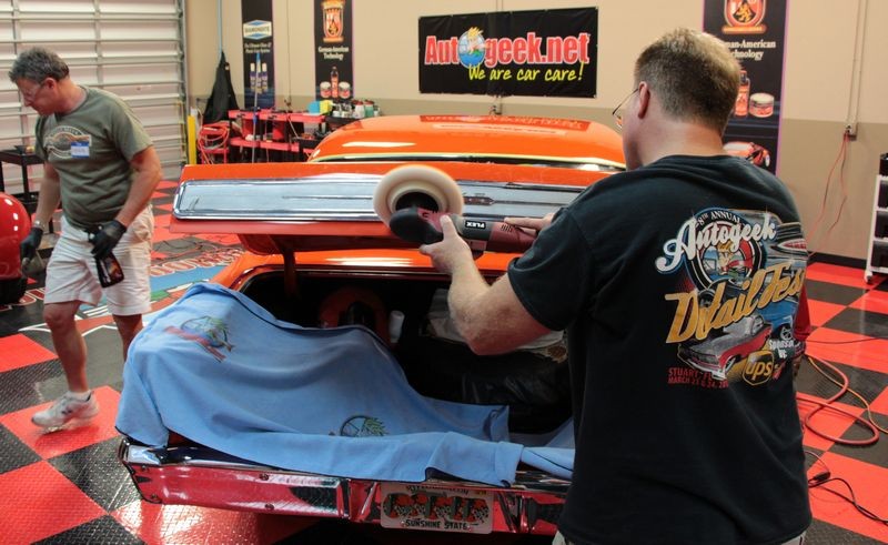

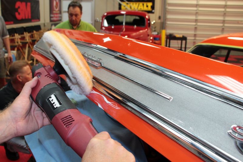

My guess is you can improve these scratches but probably not completely remove them or all of them.
Because you already have a rotary, I'd hit that area with some compound and go until you hit your "comfort level".
You can do some light sanding first, this tends to keep the HEAT down versus JUST compounding with a rotary.
Just be careful or you'll go through the clearcoat and then you'll be getting that are repainted.
Also - if you don't have an orbital polisher - I'd suggest getting one. It's really the best way to follow any rotary work and you can use it for your all your cars for both correction and maintenance.
