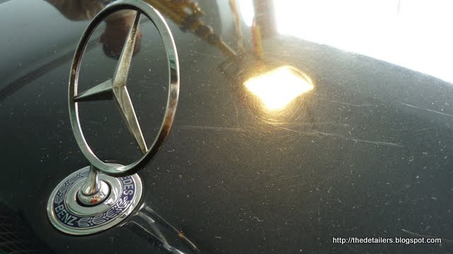

this is a 16 years E class master piece....
i wonder how can one just live to scratched & drive the car at the same time
this is the most most most
most horrific paint damaged i ever seen in my life...more compact than any Compact disc
as water cover 70 % of the earth more swrils scratched & RIDs covered this ride

Menu for the day:-
ONR no rinse wash with 3 microfibres cloths
Clay with aggresive clay - ONR no rinse as lube (2 ounces of ONR diluting with 500ml water)rr
ONR wash again again
Correction work......
whole car - Optimum Compound & wool x 2pases & more follow with LC CCS cutting pad x 1 passes
back hood even more with Finishing 2 3/4 inch Backing plate & 3" polishing & finishing pad with Optimum compound & polish & finishing polish
for front hood - Megs M 105 with multiple wool passes & cutting PAD with LC ccs & Megs 205 LC polishing pad - Optimum polishing & lc ccs polishing & Optimum finishing polish with glazing pads
Optimum polish with CCS LC polishing pad
Finishing - optimum finishing with LC CCS, RED & Blue pad - glazing pads (stepping in a finer finishing)
Optisealed - optimum opti seal (whole car - including all rubber , vinyl & windows)
Wax - Optimum car wax
Meguairs UQD on all windows
pls HUNT & look out for the numbers of pads i use of

after 2 passes of compounding...megs M 105 & Wool pad
look at the 50/50 comparrision before & after...
Picture before correction
detailing tuition begins
look at the pads & the right combinations of products & pads make the corrections prefect
day light pic of the hood after correction...like about 8 passes altogether???
