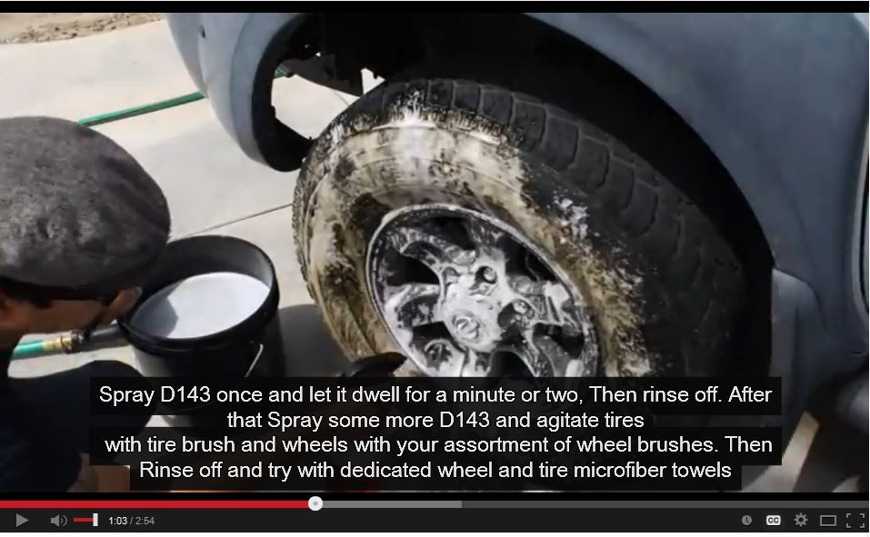

When I clean extreme dirty seals I use a tire and rubber rejuvenate cleaner on the mf towel or spray it in a long bristle detailing brush. Hold the seal against one side first so I reach down to the bottom where you have the adisive against the vehical. Spray it on the brush or kind of in it from where it touches the vehical. And aggitate without pushing to hard and let the longer bristles work. You can if you have gotten like sand in those places also push at one side and vacuum out the most of the grit out before getting it wet with the cleaner. Dry it up with a damped with the rubber cleaner mf towel and follow with a dry mf towel. If you need to you can be doing a couple of cleaning with the brush to get it off. Let the cleaner dry as little as possible so the dirt not re-attach to it again. Work on small areas and stretch it out until the first part don't dries. It's no disaster if you follow up with the cleaner on mf towel it's useally okay. But it's extra work to let the cleaners dry.
This is just what I have seen on Youtube when they do the chemical torture testing with Super Clean. It leaves a lot of residue behind and you see how much harder it is to rinse off Super Clean than other products in these testings. So if you just wipe it off and don't follow up with damp or wet mf towel to soak up the residue. You have a lot of it left on the rubber. And it may have a big impact on the bonding of the product you apply over it. Some other APC is like this too and I don't like to use them for that part where it leaves a lot of residue behind.
