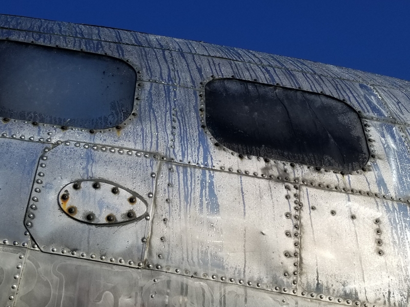

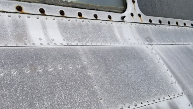

Being that she’s bare aluminum, she is subjected to the elements of heat, cold, rain, wind and anything else mother nature can throw at her. Her skins had become rough, dull and badly oxidized.

As soon as I was able, I dried off an area and performed a test polish. This test will tell us if years of neglect was reversible and if she could be polished up to a brilliant shine.
The test went very well.

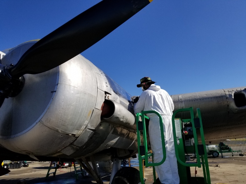

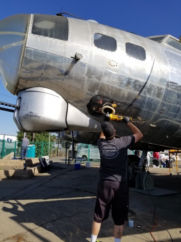

Once we were all on the same page, we geared up with high-speed rotary polishers and aggressive wool pads and got to work "grinding" off years of neglect.
Polishing aluminum isn't easy. It's very laborious, monotonous and dirty. The guys on the team were without a doubt driven by passion. I am proud of each one of them.
By the end of day 1 we had a large portion of the aircraft "cut." It was tough work and we were beat but we were making progress.

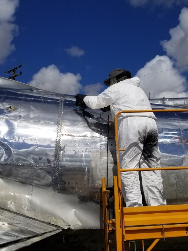

The rest of the team started the highly anticapated step II in the polish process. This is where we are no longer cutting or grinding but are starting the refine polishing step. This step removes the deep machine buffer trails put in by the aggressive first step. Here is when start to bring out the brilliant shine of the aluminum.
You can see the difference in the top portion of this tail section I am polishing with my Rupes Mille.

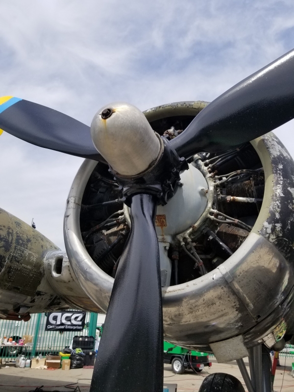

Erik is taking care of all 4 spinners.
