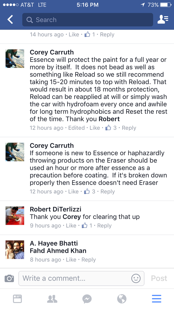

Something confusing to me with essence-- I thought with coatings you want a completely virgin surface. And being an AIO, essence leaves behind some protection of its own. And yet, it's ok to put coatings on top of it? From everything I've learned- I thought an AIO would prevent or hinder adherence of coatings? Catch me up, please :)
Straight from Corey.

See the snapshot I posted. Corey of Car Pro answers that really well.
Yes he answered that you have to wait one hour, but not if you could use a regular sealant and/or wax after polishing with Essence!?!?!?:dunno:
Also would there be any impact on the longevity of sealants and wax??
