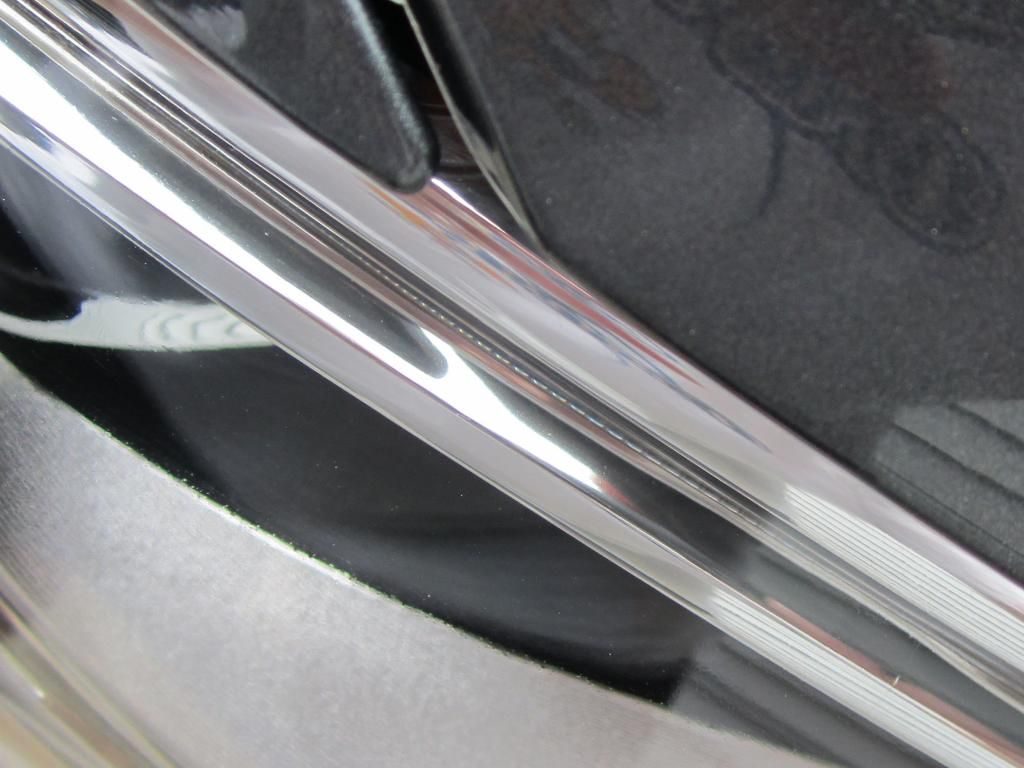

i had clear film installed and they cut one of my headlights with a razor. it's hard to gauge exactly how deep it is...but it barely catches my nail. it's such a thin cut, so the fact it doesn't catch that much could be a function of the thickness of my nail vs. the thin nature of the cut.
here you can see the scratch, then branching off of it is a faint reflection of that scratch in the reflective surface below it. underneath you can see something that looks like another scratch - that is actually part of the LED DRL assembly. it's a seam/joint.
Audilightscratch_zpsb03bdfa3.jpg~original
i hit it with an orange pad and some hyper polish just to knock the edges down. i'm wondering if it'd be worth spot sanding it lightly with my finger starting with 1500 grit and working my way up. i think a slight bit of surface "bend" or distortion would be better than the scratch. it's up high in the lamp so it wouldn't affect the optics.
I would say give it a try with the 1500 with just the scratch isolated with tape then work your way to 2500 while making the area a little larger with the finer grit. I'm no expert though, so wait for some other more experienced geeks to chime in.
Good luck with it either way!
thanks. it's really annoying to get a car back from a respected fellow detailer and have to take care of things like this (only one of many issues i have with the work performed).
the old adage "if you want it done right, do it yourself" is certainly true but i don't do clear film work!!!
it's in a tough spot in that it is so close to the panel edge so i don't know if i'll be able to get enough of the pad on it without hitting an area of the lens that is too big. maybe i'll do 1500 all the way to 4k by hand and try to polish by hand as well.
sucks i'll have to redo the coating on these but that's what Opti-Lens is for.

my fear is that the cut is deep and you are right, i'd have to go pretty far to get it out. it's just too hard to tell without digging into it and i don't want to distort or overcorrect while trying to get it out.

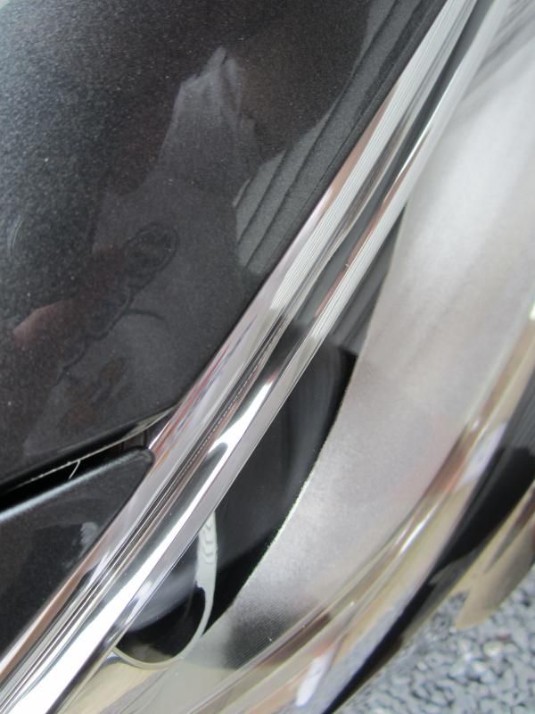

ok update
so, when i took the car back to that fool he said he couldn't get it out due to any number of so-called risks.
i figured what the hell, it's already cut, what else could go wrong? so i attacked it.
here's the result:
that dude was and is so full of crap!
process:
2000 grit finger sand with feather out under less pressure
2500 grit
rotary with 2 7/8" plate, 3" orange foam and Hyper Compound (had to use rotary because oscillation of DA killed working room, even with the same 2 7/8" plate)
had to go back and sand more with 2k
skipped 2500 and went right to rotary combo
then DA with 3" black pad and Hyper Polish
IPA wipe
Opti-Lens (two coats)
