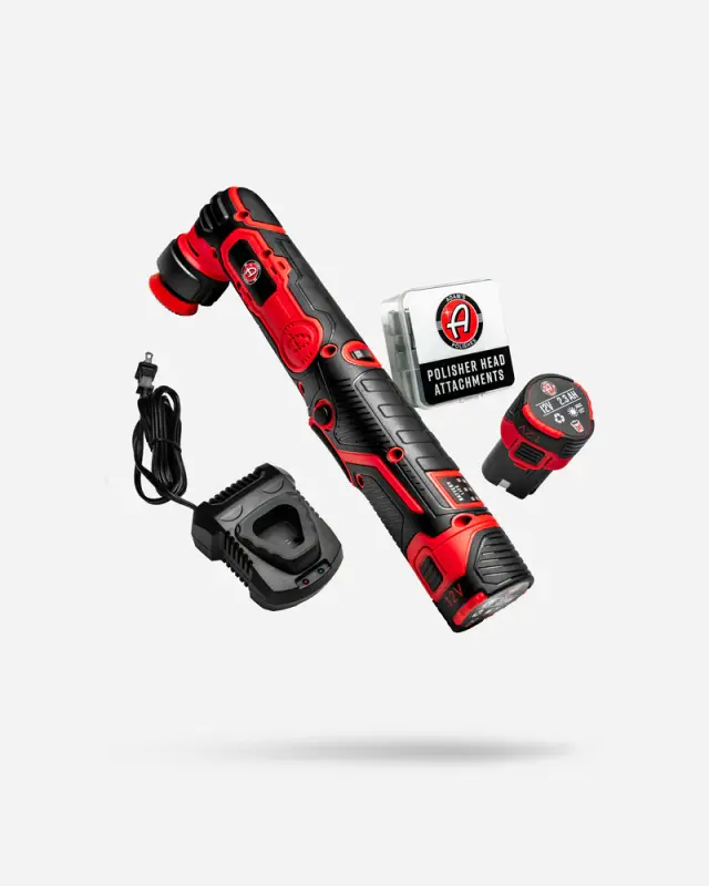

Is this the same tool that Adams sells. If it is it sure seems to stall when they show it on videos.
From the outside, there are some similarities, but also differences. In particular, the speed adjustment dials are different, as is the outer casing design and bolt holes. Having said that, I would not be surprised if they were the same machine under the skin and made in the same Chinese factory.
Specs same. All same CHIT different smell! Adam's just changed exterior cosmetics. I did try and use there electric corded battery and it didn't work:( Had to send it back.
