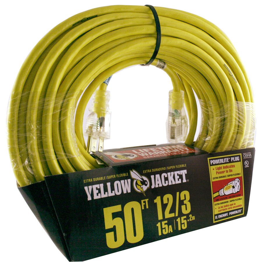

I have this one for my PC, rotary and vac....

This is the cord you want....I have them in 50 and 100 footers....I use the with all my high draw power tools and never a heated cord or tool ....
Years ago I was using a cheap cord with a skil saw and the extension cord was heating up and melting due to the high draw of the saw..I swittch over to all construction grade cords and never had a problem again..even when using with the generator...

I use the Yellow Jackets at the shop, but yesterday I went to Sears to look for a new Dryer (you just can't go to Sears without a cruise thru the Tool Section LOL).
They have a great new 12/3 extention cord in 25-50 lengths that has a locking mechanism on the female end. I ended up getting a 50 footer for my driveway details and the lock works great! I'll try to snag a picture of the cord and post it.

Cool thanks for all the info guys :D. I'll pick me up a yellow jacket someday. Toto, I'm curious about that cord :) hope to see a picture soon!
