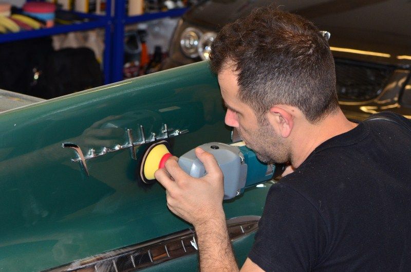

I know we have gone a bit off topic but these day us too have an American beauty for total detailing. You can watch the progress here
