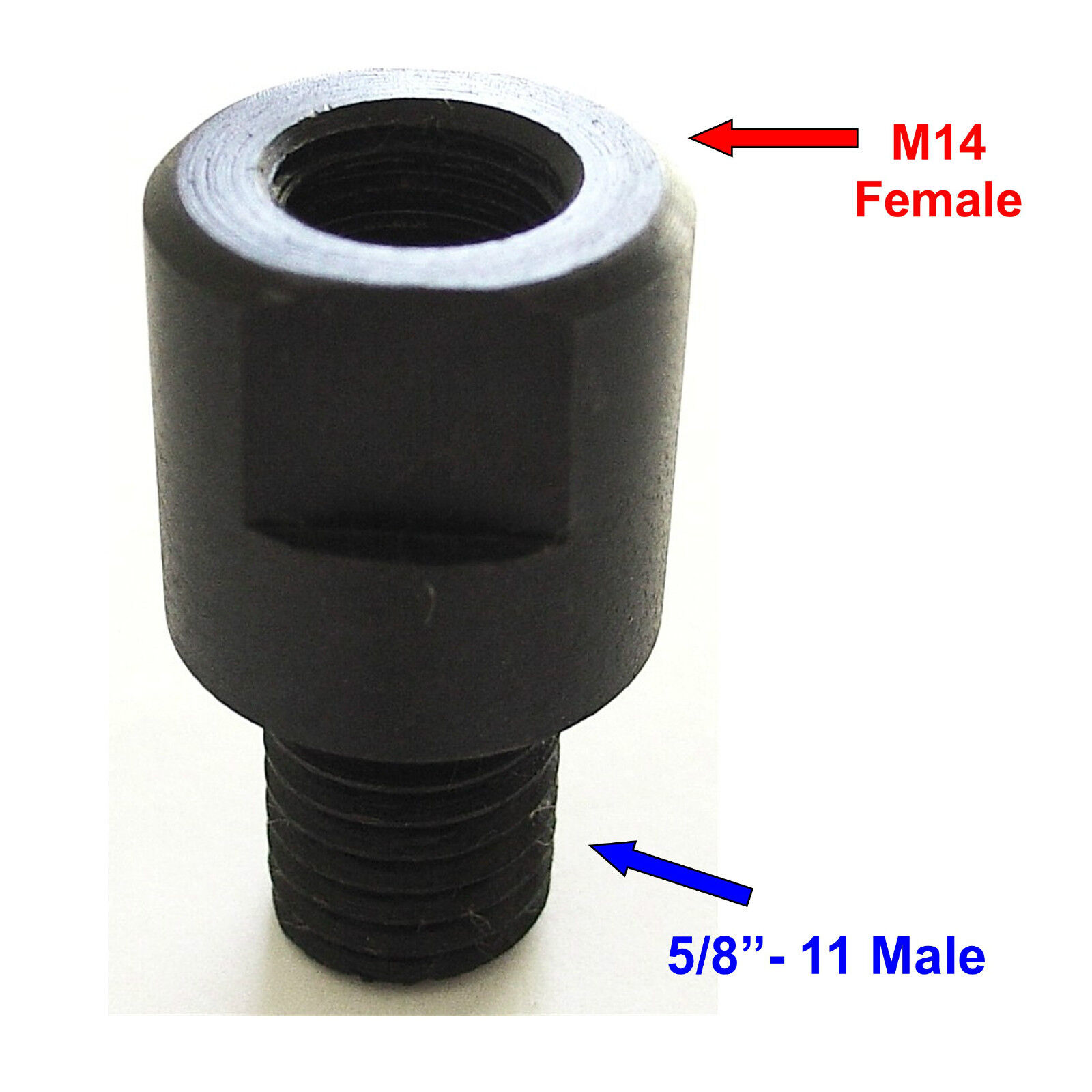

Went to all the local hardware and machinery stores, i showed them my PE14 and the double-sided adapter, they looked at me like i'm a weirdo. :dunno:
However i managed to find two of these available online.
Not sure if i'm allowed to post the link here, so i just posted the picture and brief description.
Is this what i need?
1.
Name - Adapter 5/8"-11 to M14
Description - "Convert 5/8"-11 female arbor to M14 female arbor. It will allow power tools with M14 thread spindle to use diamond tools with 5/8"-11 female threads. European, Asian and Australian customers may need this adapter to use our diamond tools with 5/8"-11 thread."
2.
Name - ADAPTER converts 5/8"-11 Threaded arbor to M14 THREADED HUB
Description - "Use this adapter to convert your tools from a 5/8"-11 threaded arbor (MALE) to M14 Threaded (FEMALE) Hub."
:thankyousign:

Thanks everyone, i have received the adapter for my EU version PE-14-2.
Adapter on the right.
