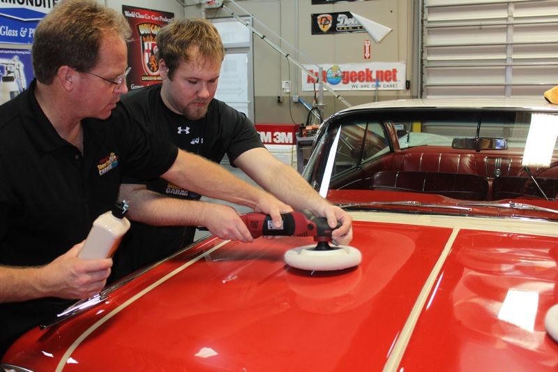

I apply FK1000P using Griot's Garage 3"
Polisher (speed setting 3)...with the
RUPES 4" White Foam Finishing pads...
as depicted in the picture below:
(Cropped--->Photo--->Source):
The following Mike Phillips article:
http://www.autogeekonline.net/forum...tions/85163-how-create-high-gloss-finish.html
