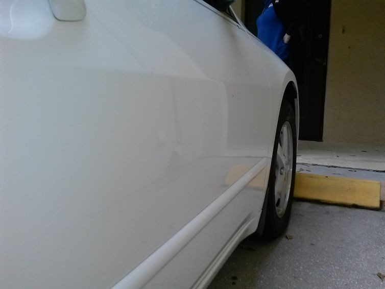

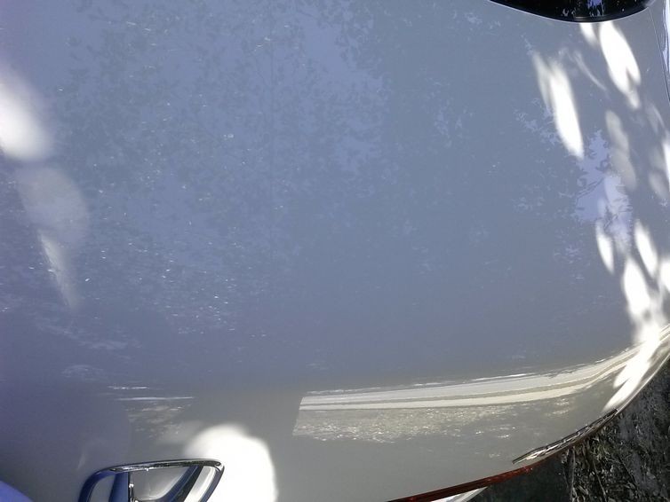

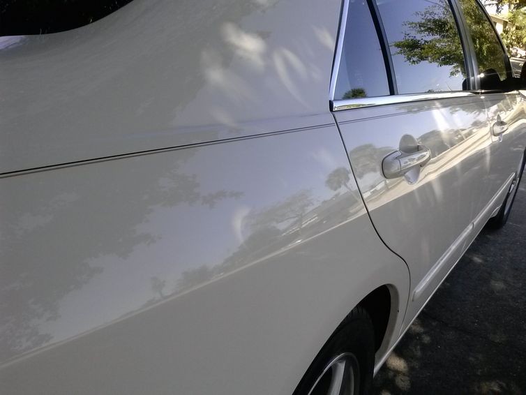

Here are some shots of the other panels with swirls(didn't really get shots of the panels I worked on)
View attachment 47439View attachment 47440

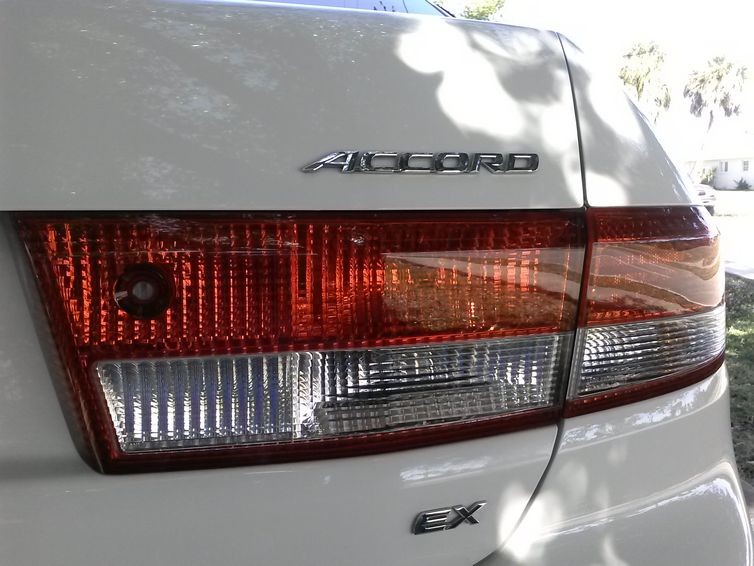

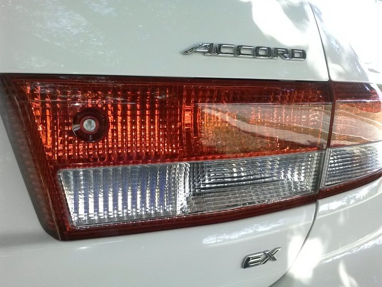

Here are a couple shots after the polishing(still have some deeper scratches and rock chip marks).
View attachment 47441View attachment 47441
This one has like these weird circles on the inside right side of the light.

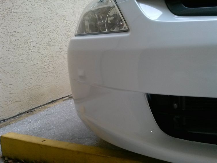

One with a couple of deeper scratches.

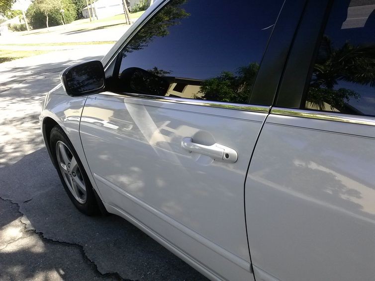

Oh here's picture of car(prior to polishing).
