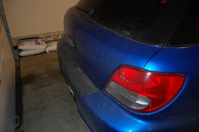

Swirls and just general paint haze from 11 years of neglect

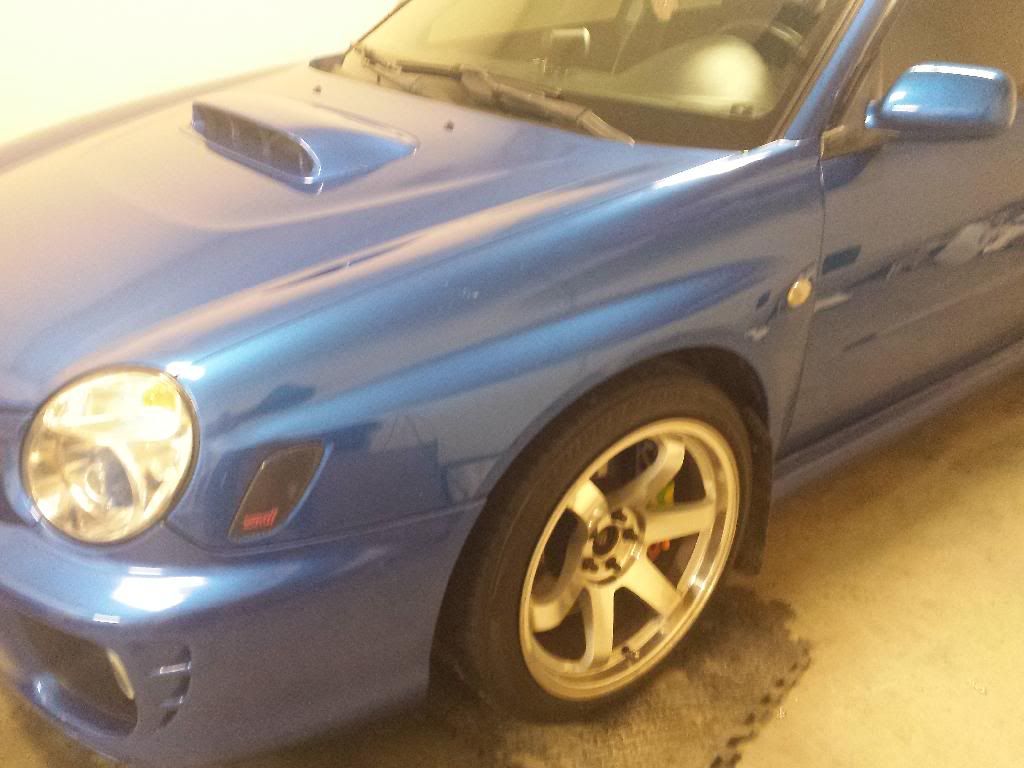

And After :)

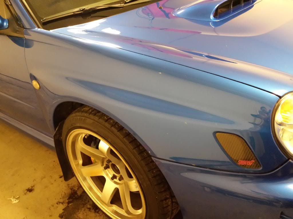

Great job. I love that color. I saw where the clear coat had broken down on the pre shots of the left front fender. How did you deal with that?

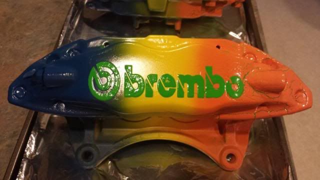

Nice! Are those rainbow colored brembos?
Sent from my Alien ship
lol, you noticed those. yeah, I wanted them to be different from every other set of Brembos out there.

Thanks! The clear coat and the paint is gone on spots on both fenders.
They are the JDM STI fenders, and they wrapped them in cardboard when they shipped them, and it destroyed the paint on them, I put some clear coat on them for the time being until I put my new set on.

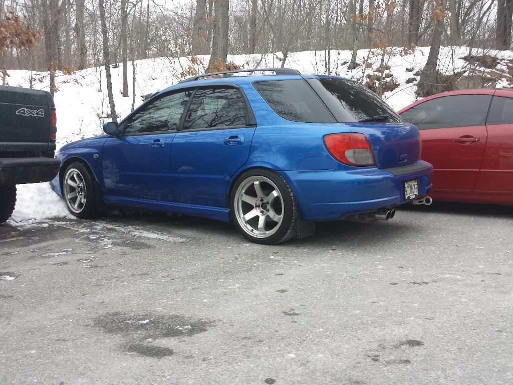

Finally got around to taking a couple pictures outside.

On a side note, here's a better pic of one of the brake calipers.

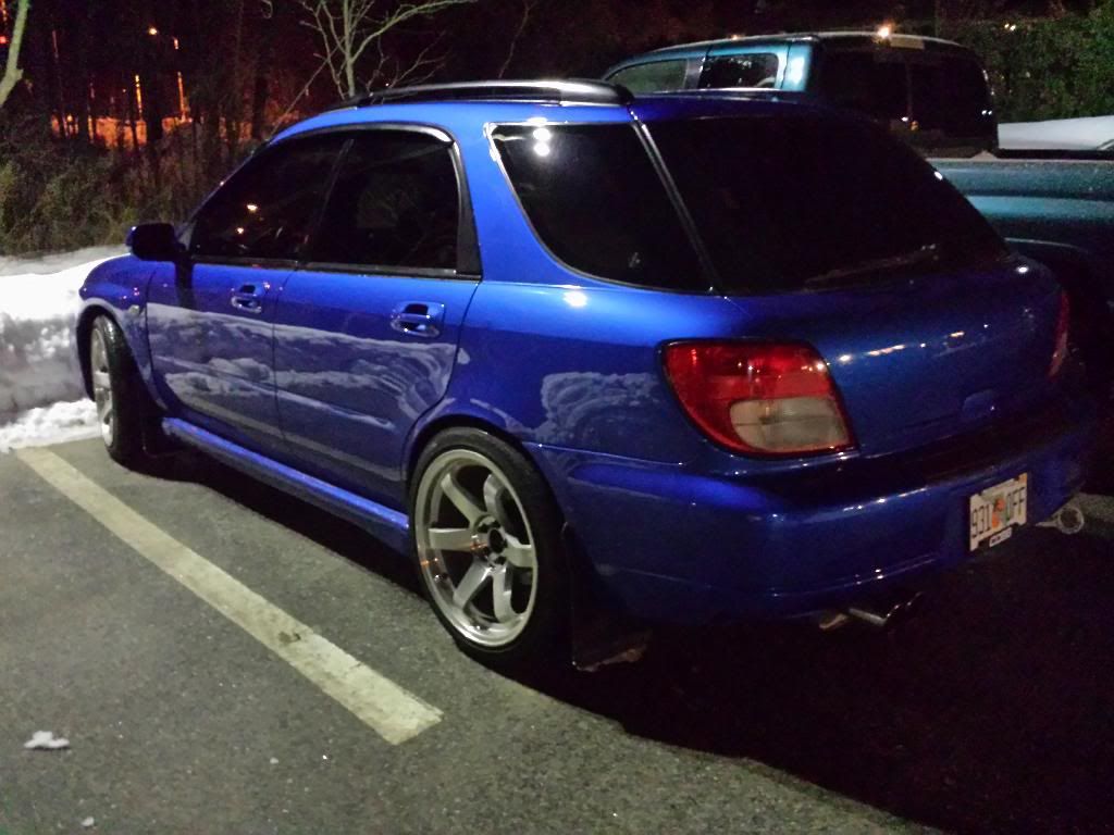

Durability update. After one month, the sealant is still holding up perfect. this was when I came from work and saw the beading. When I got home, the car was completely dry. 3 miles, max speed 40mph.
