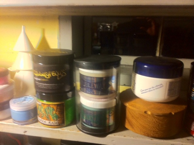

I like to keep my 5.5" pads in pretzel stick containers. They are around 5.5"-6" diameter and you can fit about six pads in them. Just make sure the pads are really dry first.
