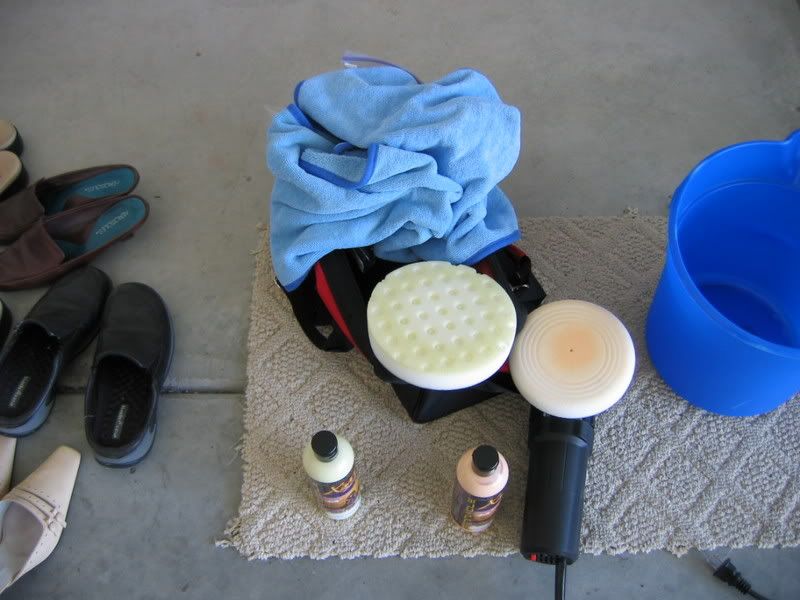

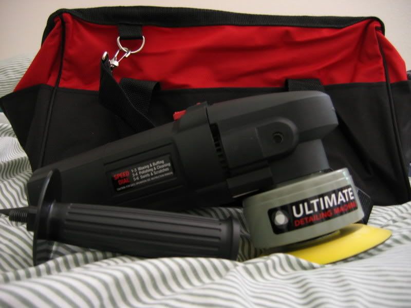

UDM: Pretty much identical looking to the Porter Cable. It's not too heavy for me, and it doesn't vibrate too much on speed 6. The vibration doesn't bug me at all, but then I haven't used it for an extended period of time yet. I haven't had any problems accidentally bumping the switch so far, but it does feel like it can easily be switched. The pad that comes with the UDM is a nice size, and it has indented lines for the polish to go into. it's a nice pad and I'm glad it's included with the UDM.
CCS pads: I like these pads as well. Too bad they don't come in a 5.5 inch or something below 6. I haven't been able to experiment with the advantage of the CCS technology, but overall these pads are great.

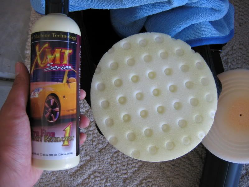

Here is what I started with, white Lake Country CCS pad with XMT 1. I worked it in until it looked translucent on speed 6. It dusted a little, and had a nice working time. I'm not sure how long it took to break down, I'm guessing I took 3-5 minutes. I just worked a small section, 1 ft by 1 ft. All in all, I like this polish, had no problems. I didn't see how much it corrected though. My garage doesn't have great lighting, and I didn't have the car pulled out into the sun yet.

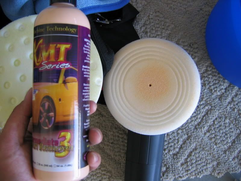

Here's another combo I practiced with. Boy, did XMT3 break down FAST, I was surprised. I used about a nickel size for 1 ft by 1 ft area. I did this on speed 6. I like how this broke down fast, but I haven't used it enough to comment on its correctability.

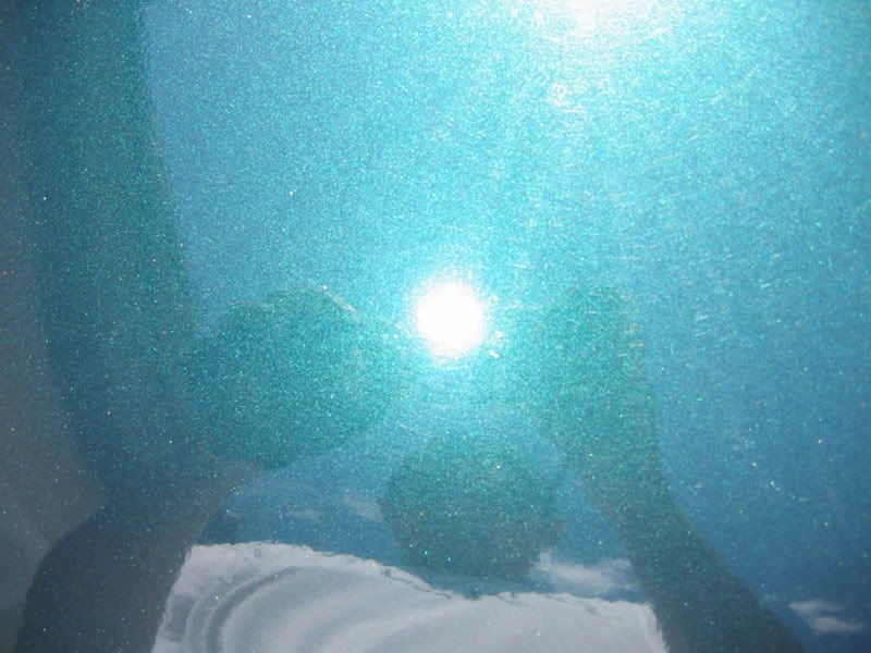

The horrible orange peel

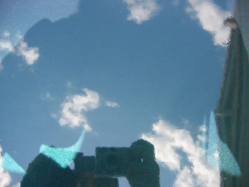

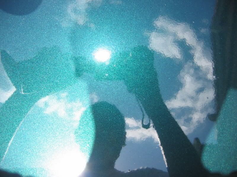

Polished portion of the hood
Unpolished portion of the hood

That sucks that you did not get to do the whole car...I would of felt like a book I read and I am stuck half way... So it looks like I will be getting some CCS pads soon. But how do you like the UDM so far? :)

2turbos - I feel the same way, stuck in a book after the hook, but I can't read on :p. I love the UDM so far, it works great. I'm sure the PC is a great machine too, but I love how the UDM can get you started already with the backing plate and polishing pad, AND a bag, so it's a great deal! All you'll need is a polish and more pads :D
