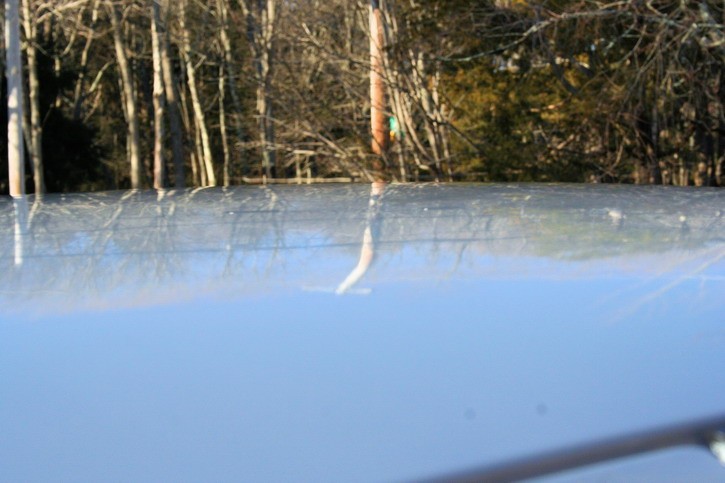

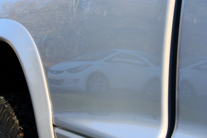

My wife works at a hospital, so the car gets dinged all the time. The third pic shows what I was dealing with, there were several scuffs like the one behind the door handle, and several shallow scratches. This made me elect to use the orange pads on the doors. After:

Overall, I'm very happy with the results for a first time. 360 is very easy to work with, especially if you're new to it like me. With an orange pad, it did a nice job of getting rid of swirls and light scratches. As you can see from the hood picture, the white pad left some swirls uncorrected. It was overcast when I started, and could have done a better job of inspecting prior to starting. I could have also gone with an orange pad instead, but since I did the hood first I was being super conservative. I could make four or five passes on the panels that were in good shape, and seven or 8 on the ones that needed more love. Regardless, it was easy to see, didn't dust, and wiped away with no effort. My truck is much newer and in better shape overall so I have no doubt it will do a fine job. However, I'm going to pick up another bottle of 360 before I start because the rogue took about 1/2 of this 16oz bottle. I used a bit to prime each pad and then 4 nickle-sized dots per section.
