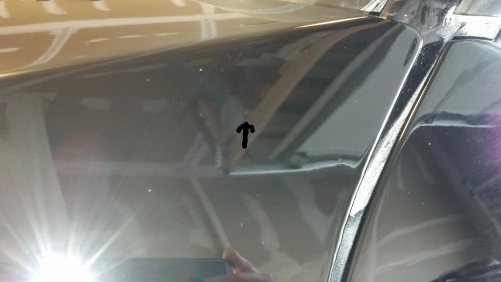

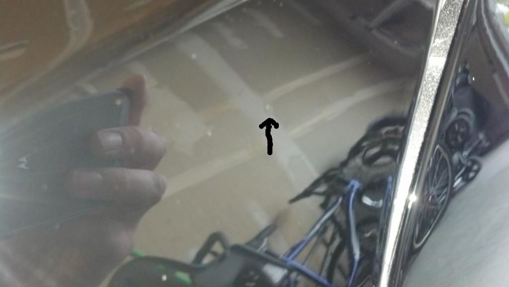

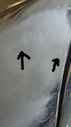

Figured I'd do an update to this thread and show how my attempt at fixing these went. It actually turned out not too bad. You can still see them from most angles but they are subtle enough now that I don't think most people will even notice them.
First I started by scuffing up the inside of the eye as best I could. Then with a fine tipped paint brush (Yeah I had to buy the wifey a new one when I was done) I dabbed a little bit of clear in. Let them cure. Then sanded them down flat with some 3000 grit paper. I kept waiting for the blob to pop out or something but they stayed in there. You can still see the dust or contamination point in the middle that originally caused the fish eye but all in all its way better.
This was what they originally looked like before filling.

This is after sanding them down smooth. You can barely see them just above the arrows.
This is after buffing, polishing and waxing. They are still there but were very hard to capture in a picture. I could really only make it visible when I got it on the edge of the sheet rock line to show some distortion.
This pic is a little closer. You can really only see the dust spec in the middle of it (which kind of blends in with all the other dust on the car lol) Other than that not too shabby.
