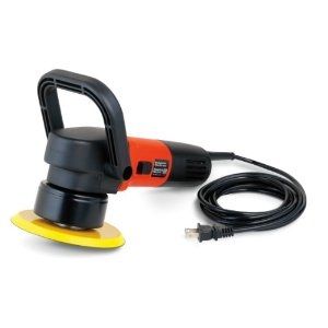

I've been thinking of attaching a "D" shape handle on my PC. I left the side handle on (for leverage) but have been using the back of it more and more. And I use the handle to carry it.
When I purchase my next DA I want to first use it how it is, and try to get used to it, then attach a handle if it's possible and if I have to.
If these machines are getting so hot, I don't see why a small D shape handle isn't made?
http://i1079.photobucket.com/albums...E210235-2049-0000022294820C4B_zpsc42a8a60.jpg
Like this ^
But small handle would be nice (for better grip and less heat transfer IMO
