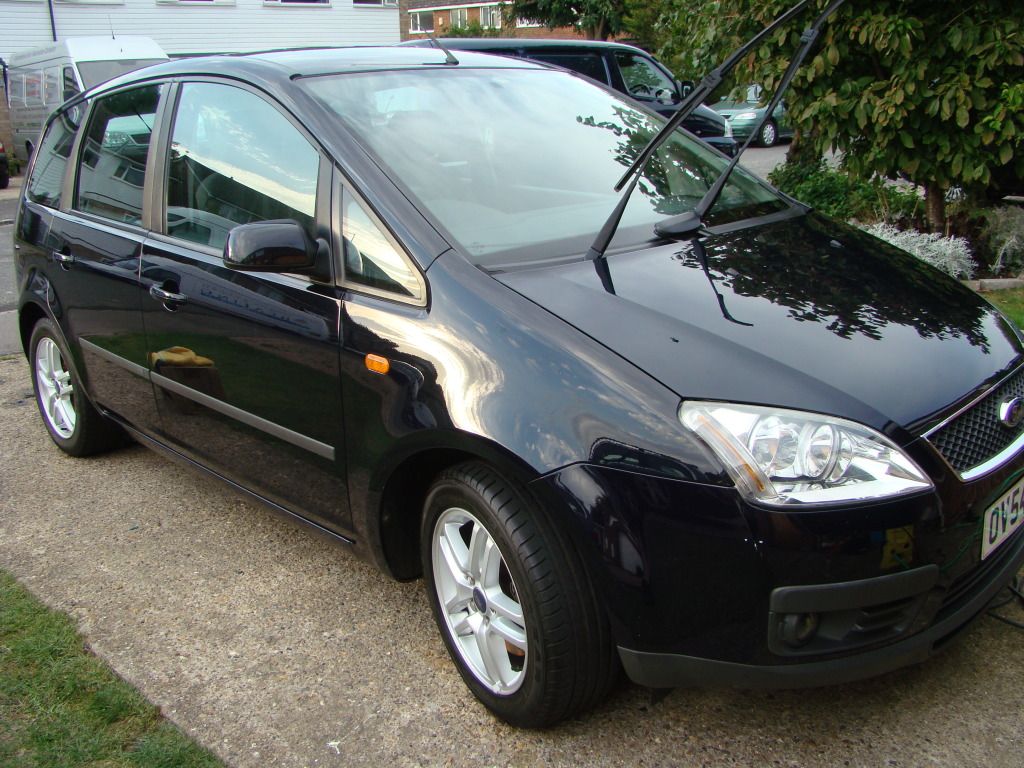

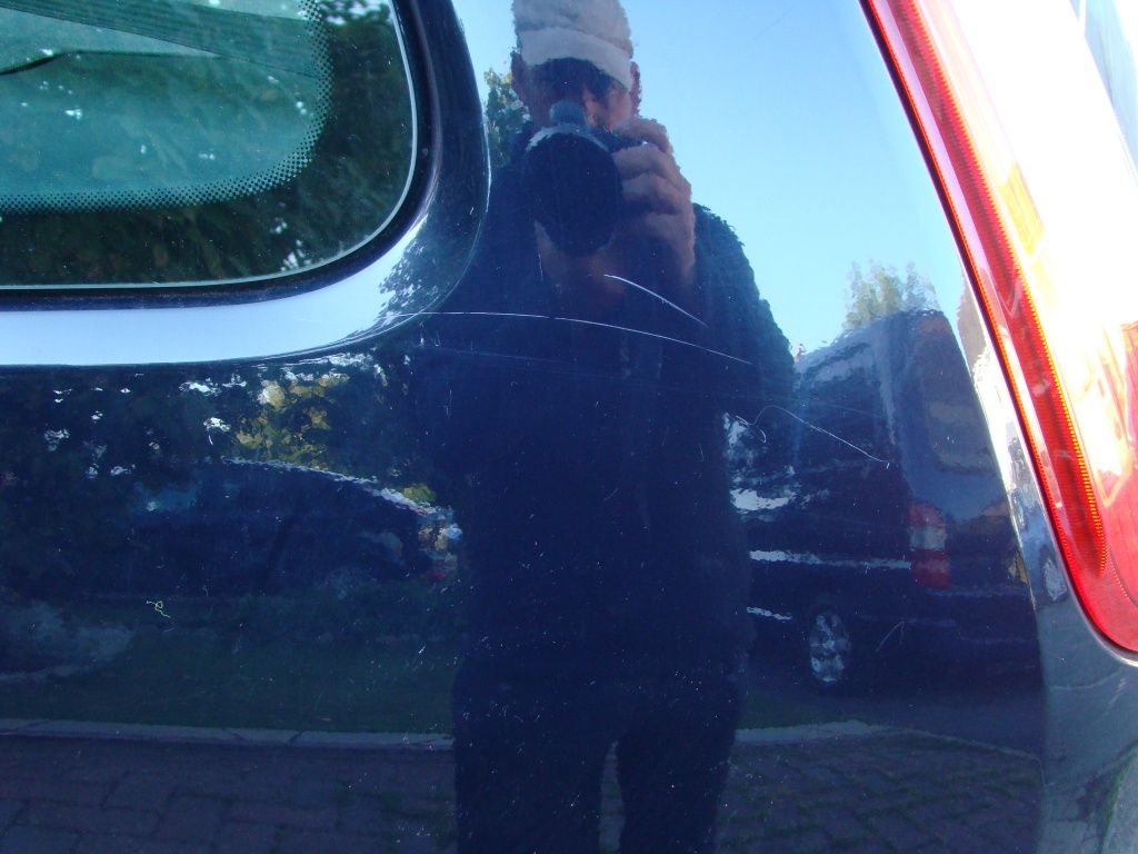

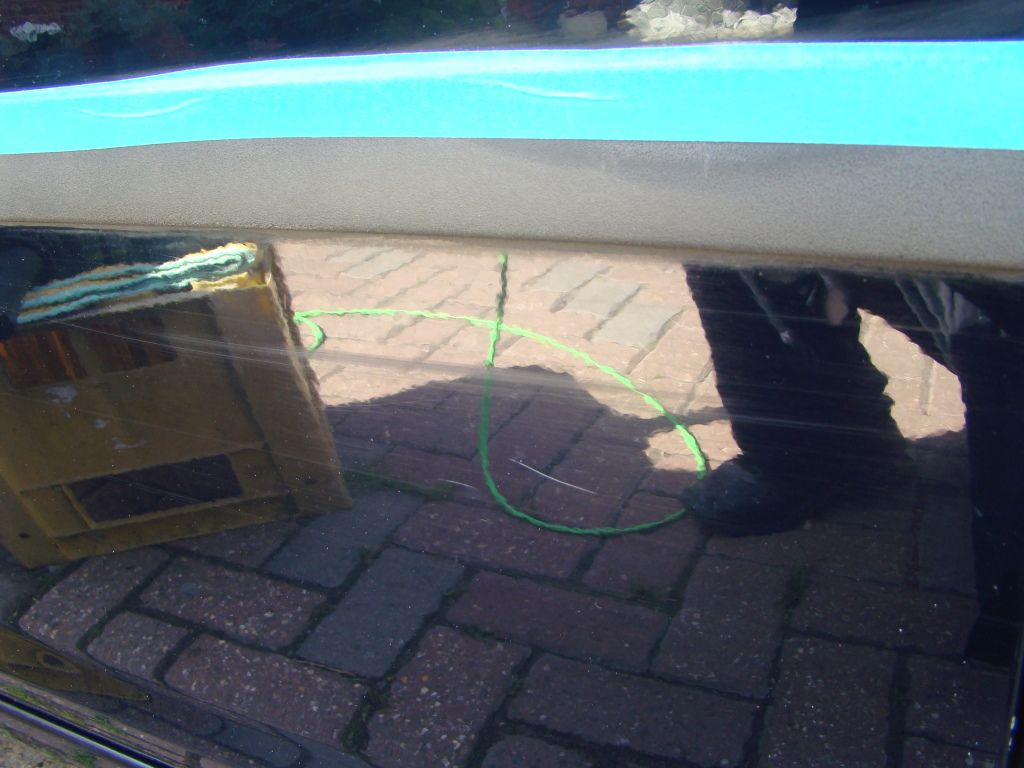

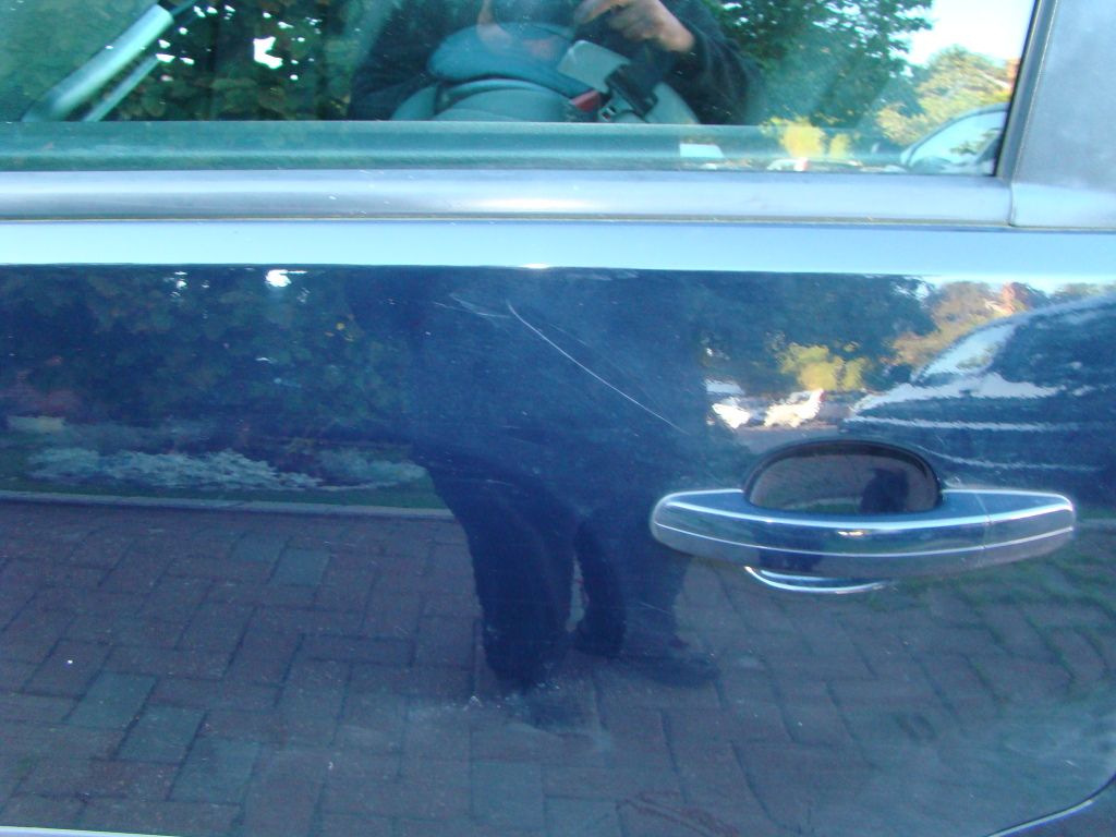

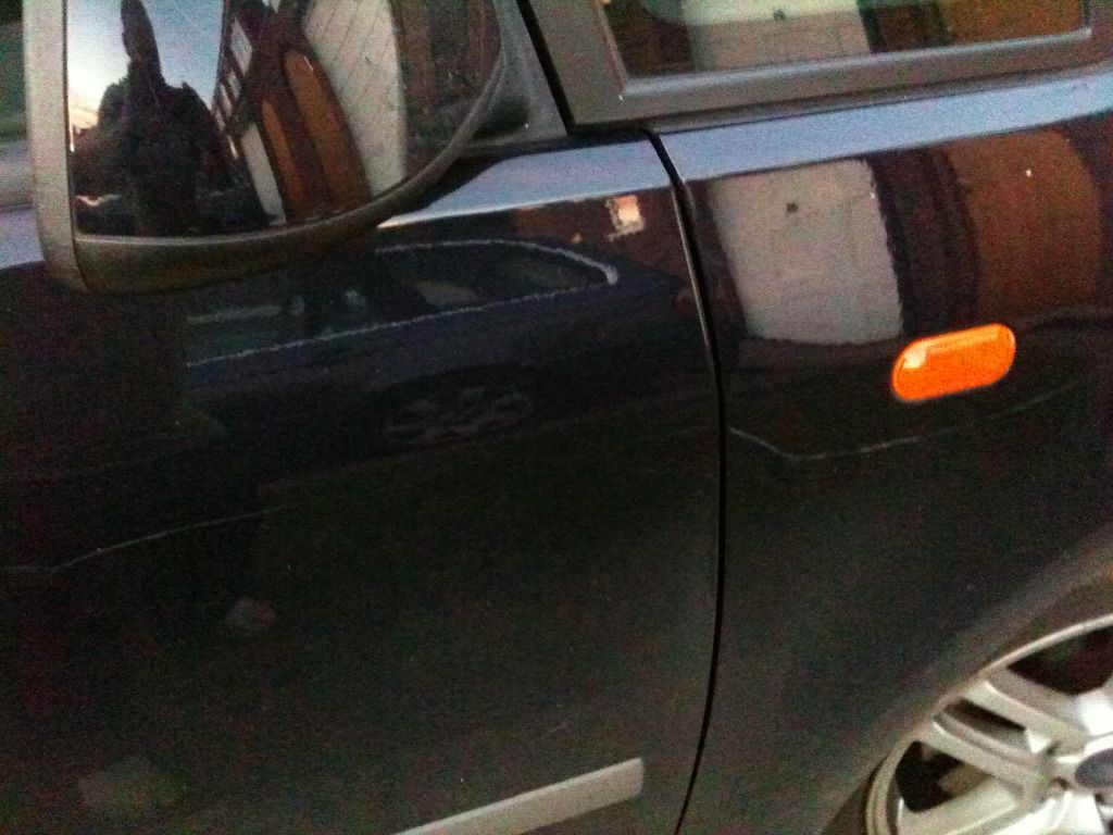

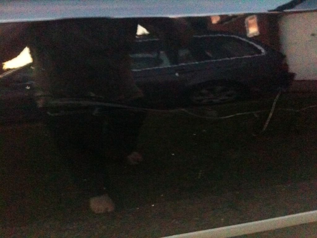

this Focus c-max belongs to a neighbour who asked me if i could have a look at her car for her. i had one day to turn it around, so started at 8.30am and finally handed it back at 6.30 that evening. last time it was washed was 6 months ago, and it's hasn't seen any polish since they bought it 4 years ago. on the up side that meant the paint was still factory depth.
a few before's (some were taken on my iphone the night before, so please excuse the quality)

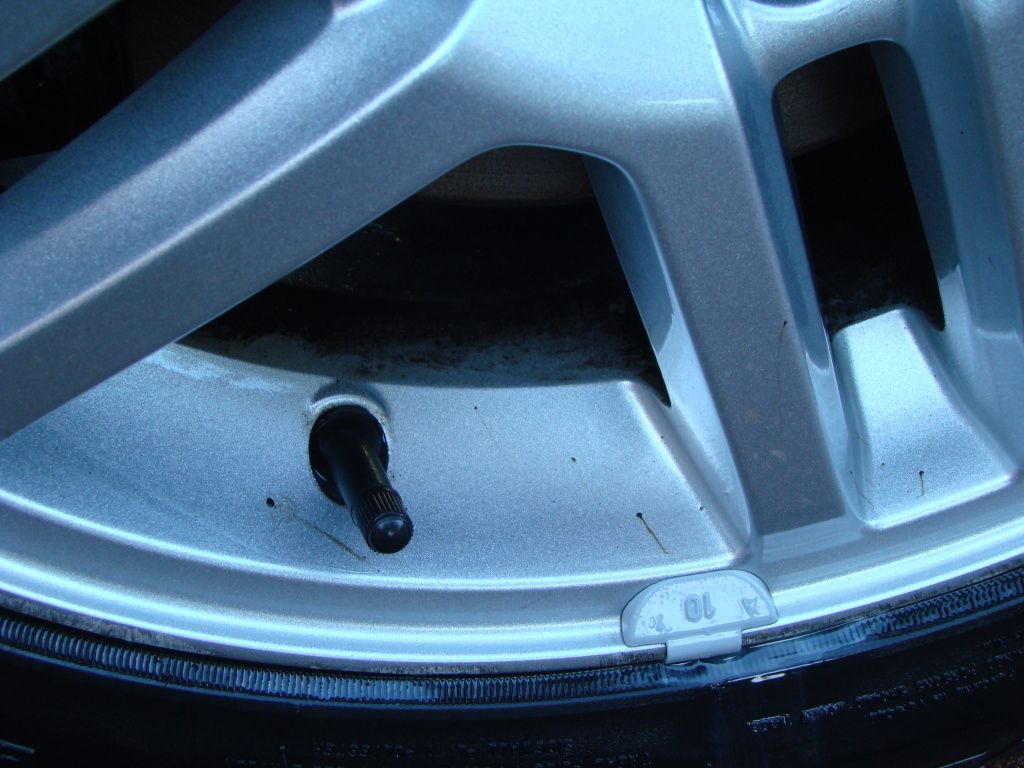

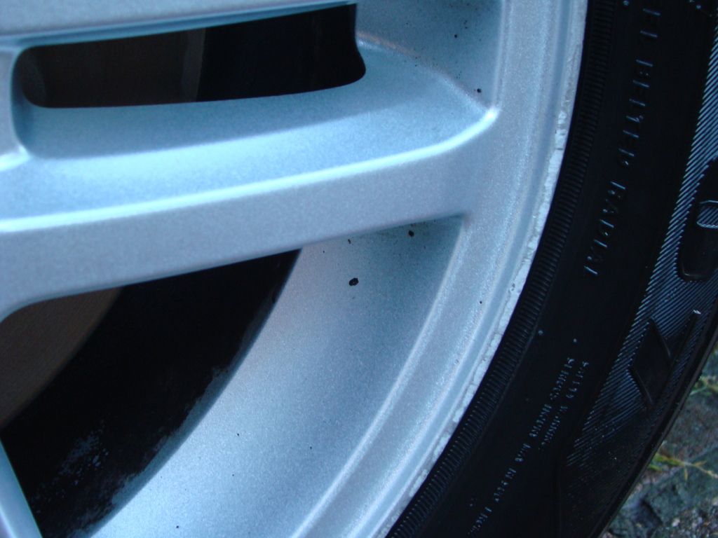

so as you can see, plenty to keep me happy (as it turns out, for most of the day) i gave it a good blat with the pressure washer and a soak with some Valetpro Citrus pre-wash to get started. Then on with the wheels which i gave a good hit with AS Smartwheels - great stuff

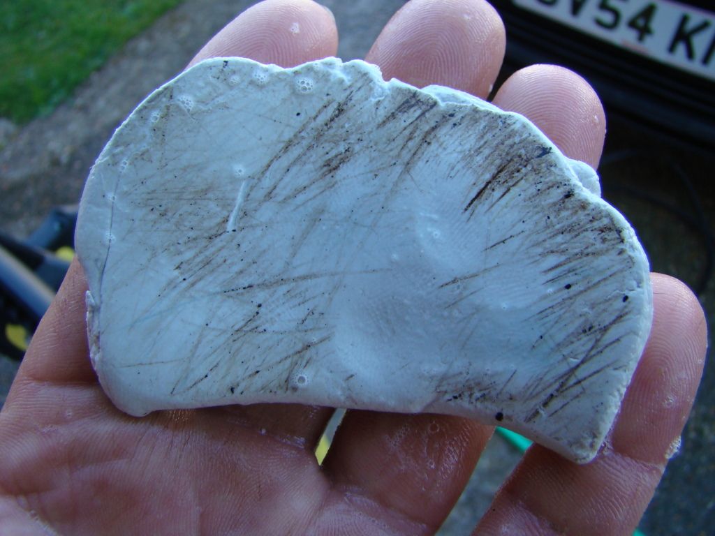

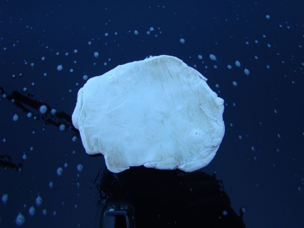

next up, time to clay. born slippy and some DJ SN fine clay.

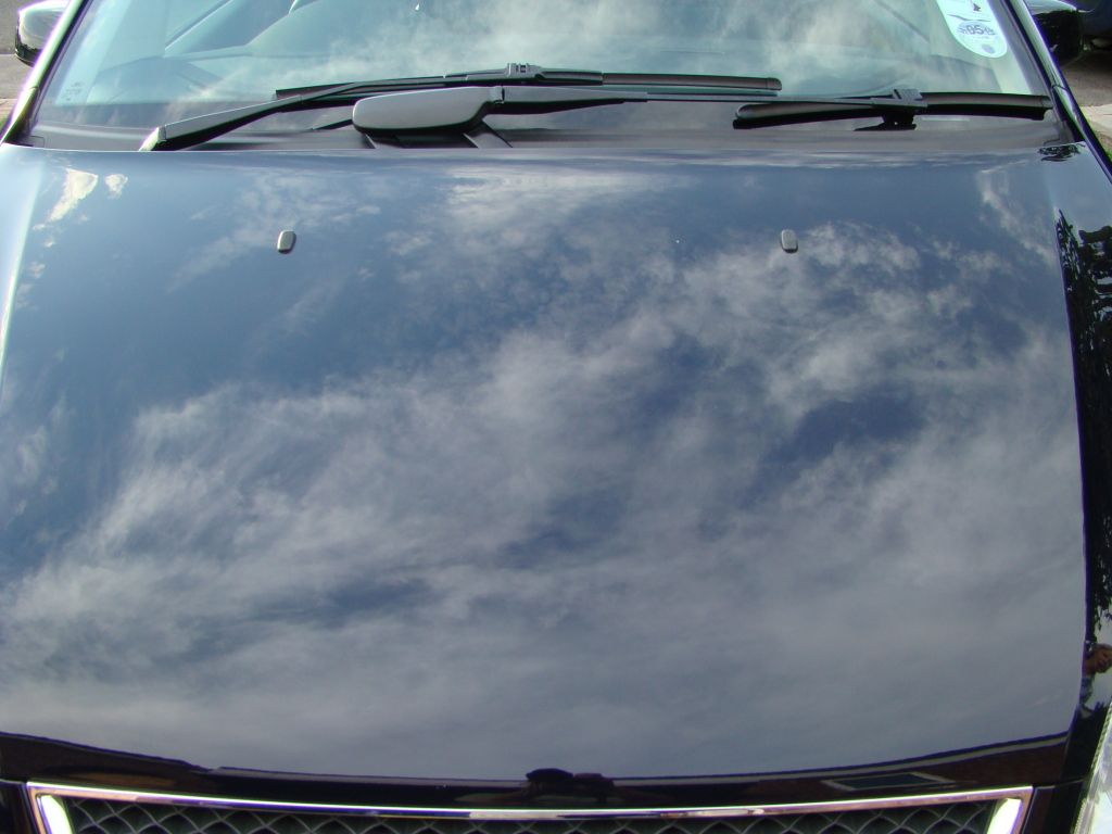

The bonnet wasn't too bad at all, but it had been resprayed (PD8 reading 400+)

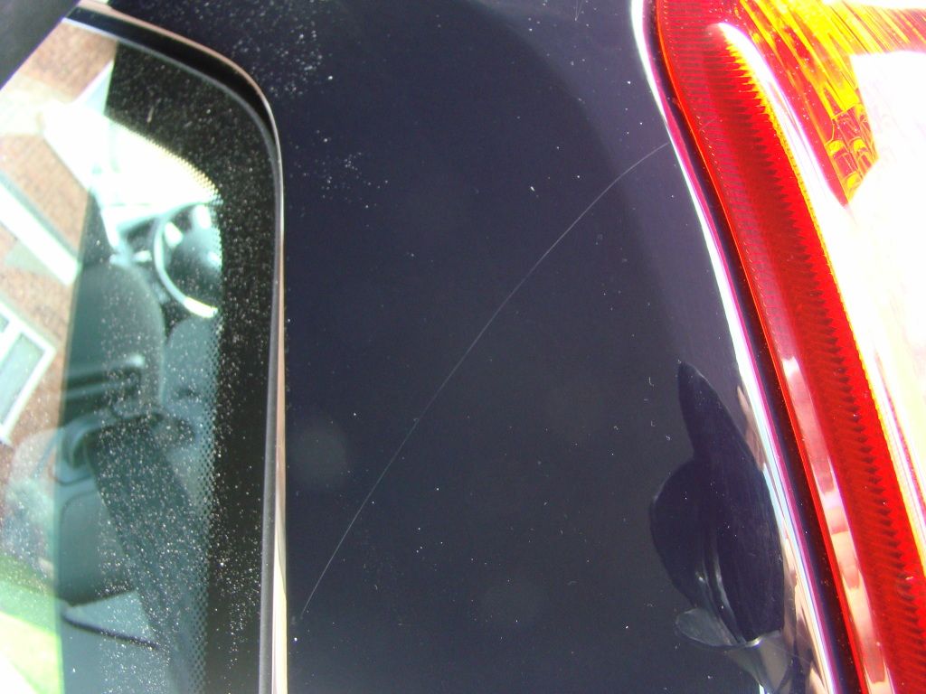

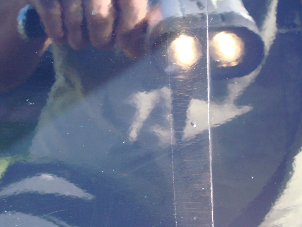

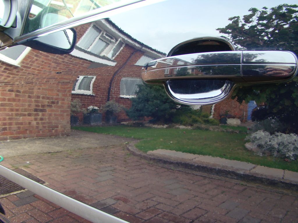

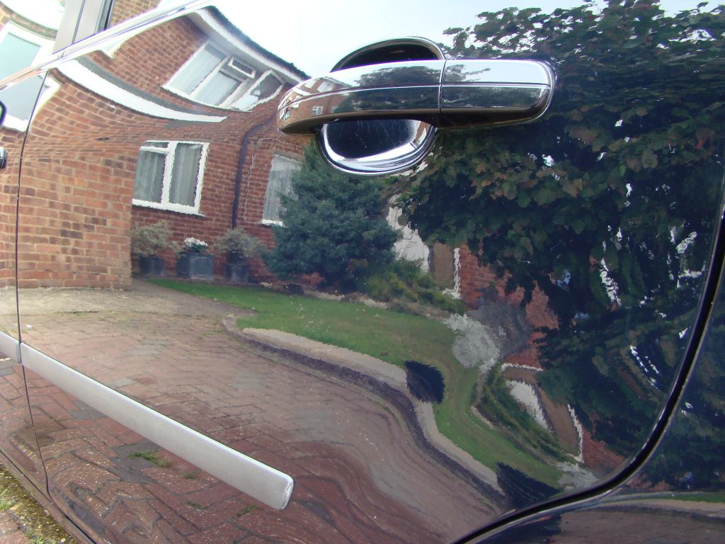

the rest of the car was just as bad. So once clayed it was out with the fezzy. i tried a few combos, but for the level of correction i wanted i found Scholl's S3 gold on a white festool pad was just about spot on. i did on occasion move up to an orange pad for some of the real nasties. that was followed with DJ Lime prime on a Festool black finishing, leaving this

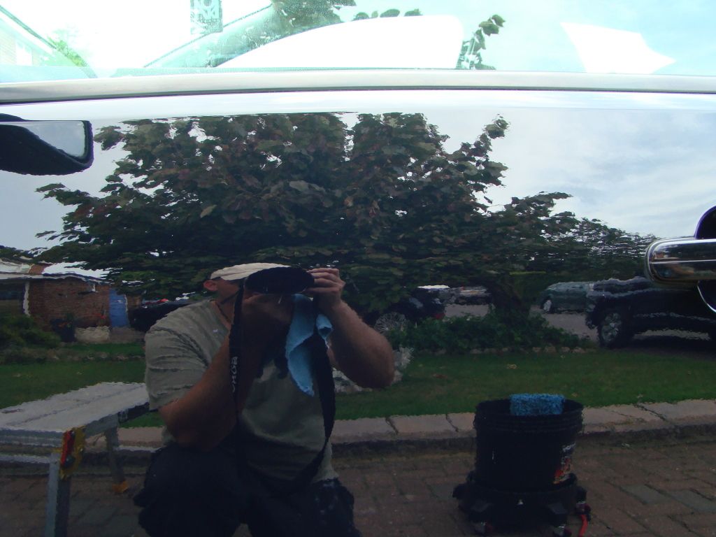

not perfect, but good enough given i only had today to get it done.

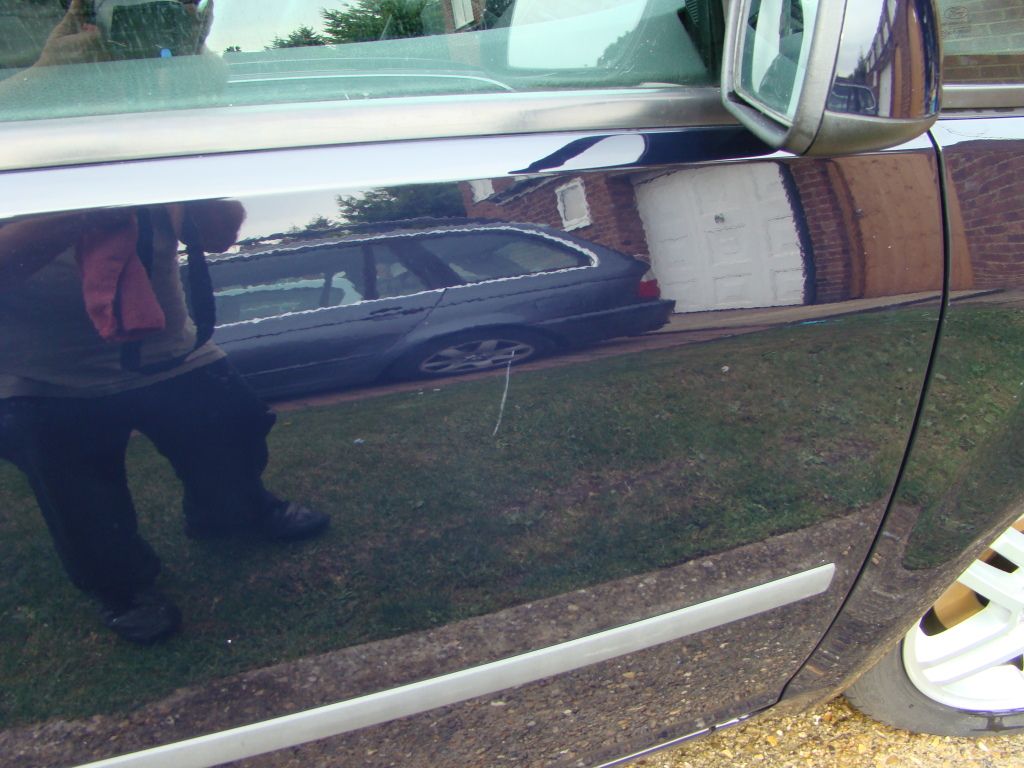

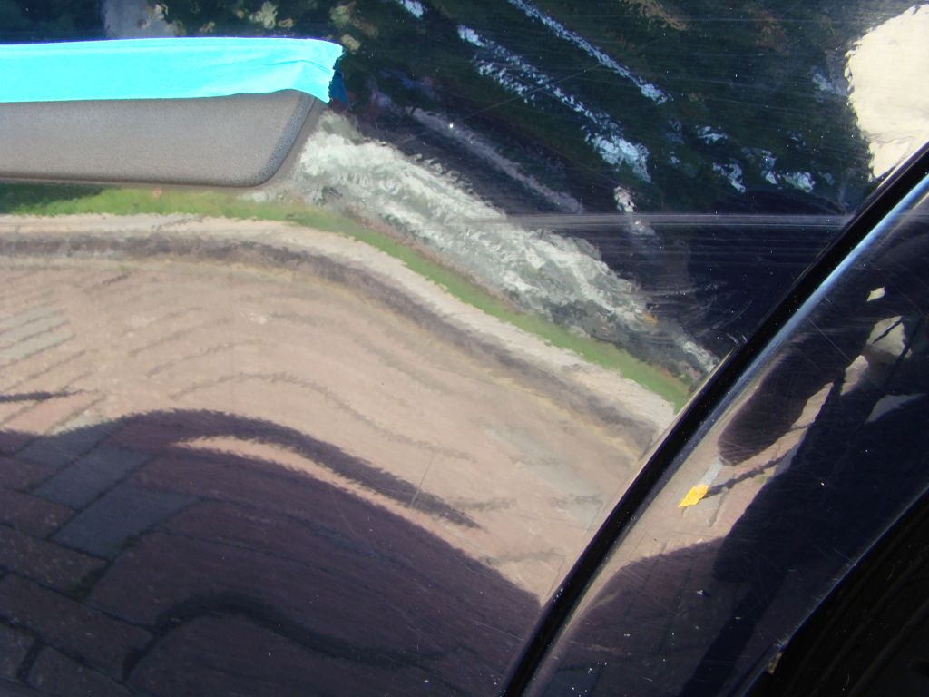

a few more scratches down the nearside

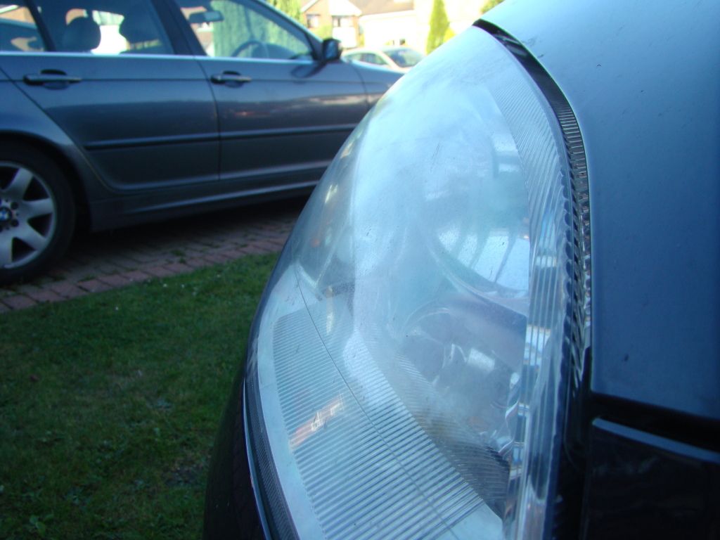

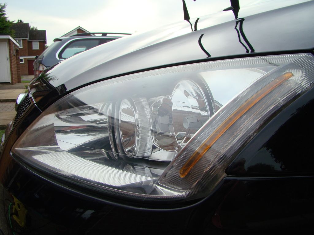

i decided to wetsand the headlights to try and get back some sort of clarity to them, TBH they could have had another hour spent on them, but again its a matter of what i had time to accomplish.

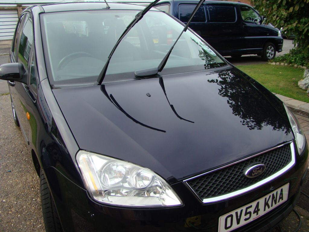

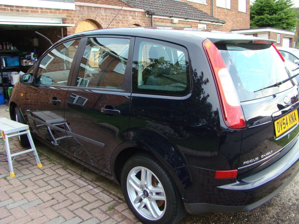

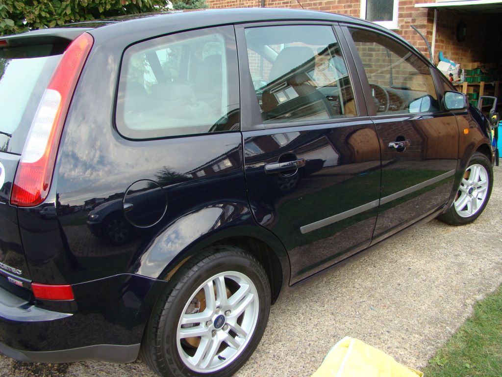

the rest of the car was waxed with DJ Blue Velvet, because i love it, and tires were dressed with DJ SN Tyre dressing, trim was treated with AF revive and glass was cleaned with DJ Clearly Menthol. leaving this.
