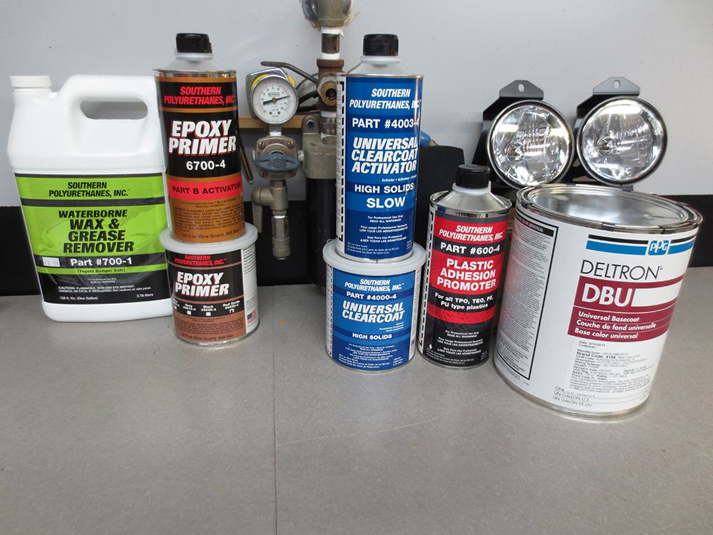

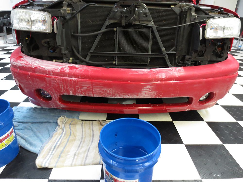

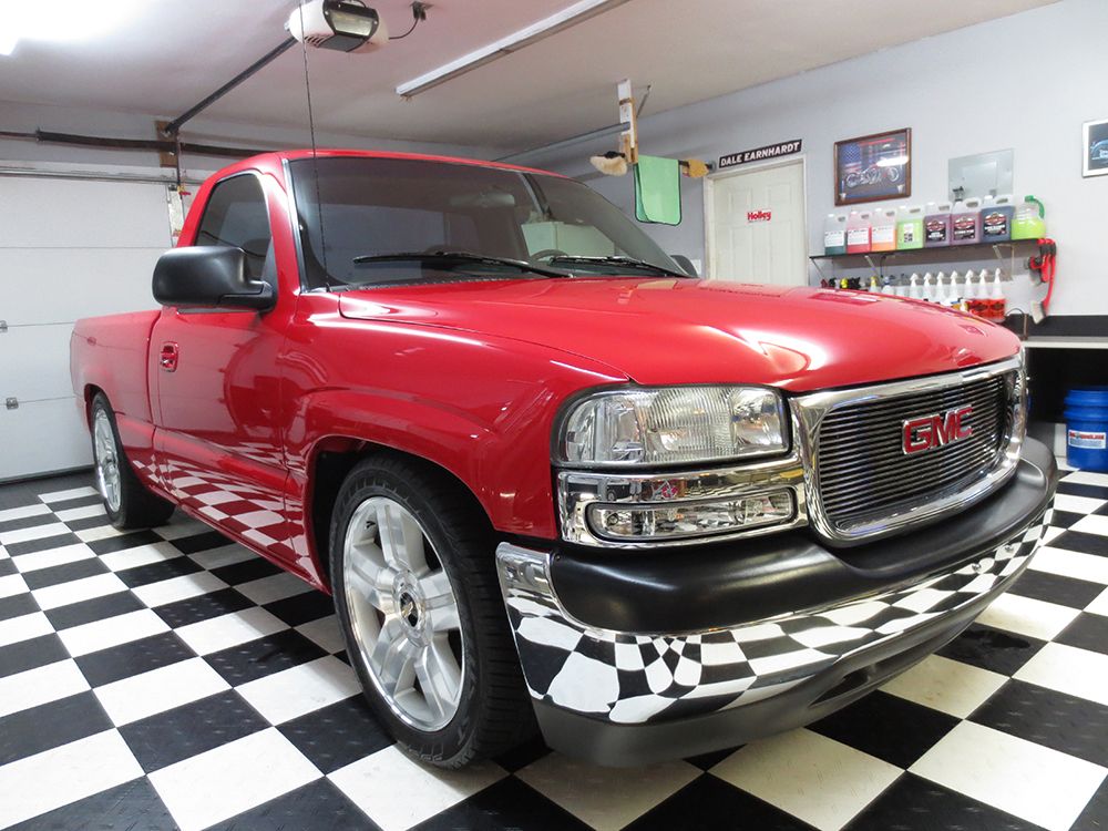

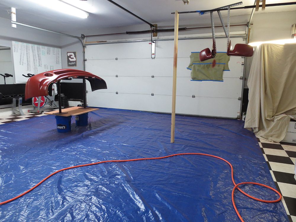

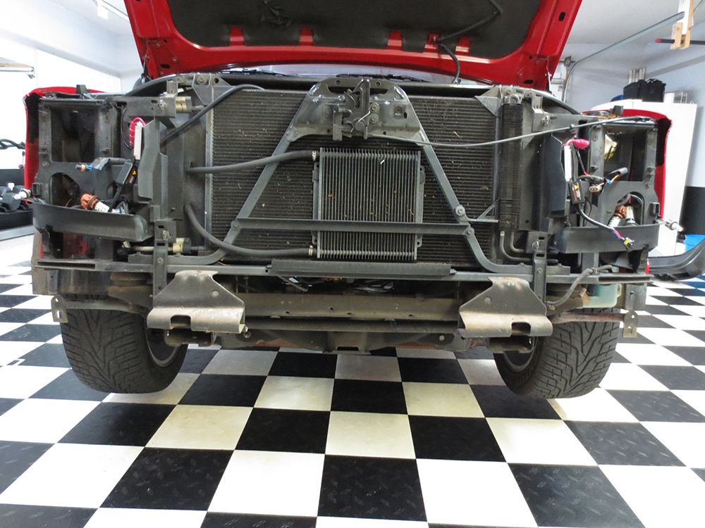

Just finished the Denali Conversion on my truck. Found a used bumper that was scuffed up in a few places. Feathered it down, Adhesion Promoter, Epoxy Primer, Basecoat, Clearcoat.

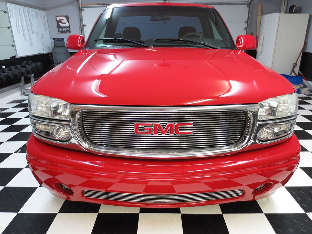

This SPI Universal Clear has to be the best clear I've shot in the 35 years I've been doing this. Laid down slick and cut like butter, good value also. It sanded so easy I decided I didn't need the aggressive wool pad on the rotary which is the norm for buffing fresh clearcoat. The Griots 6" did quick work on the clear.

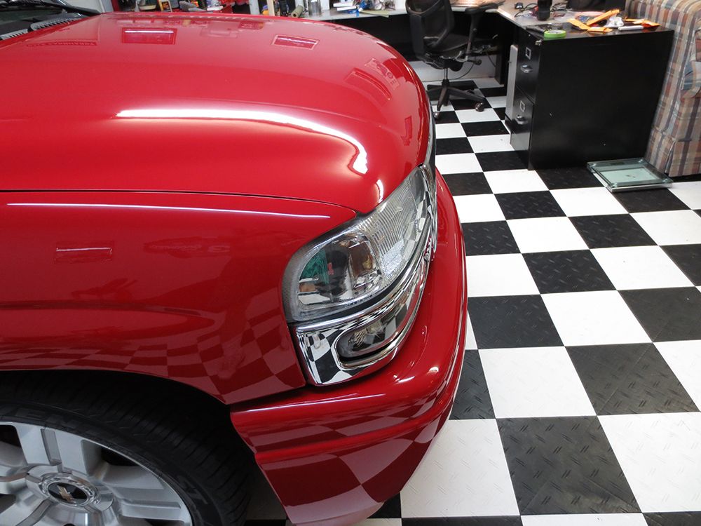

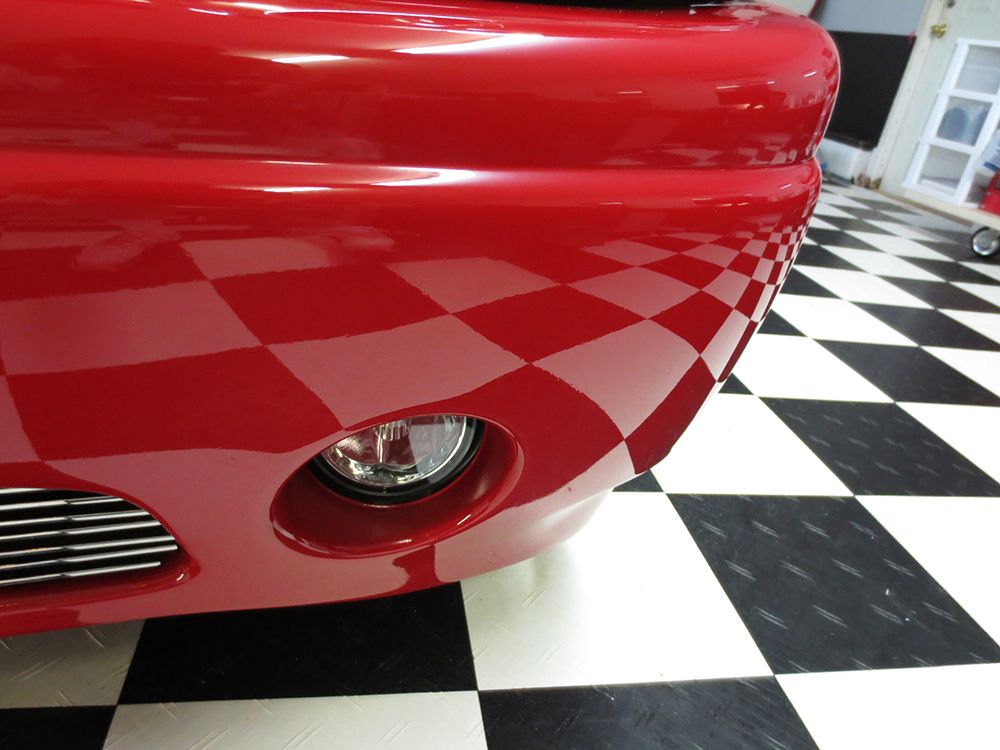

Cut and buff... 1000 grit, 2000 grit, Meguiars M105, HD Polish.
Test with the M105 and a Orange CCS Pad and HD Polish with a Gray CCS Pad. It cut the fresh (32 hour) SPI Universal Clear like butter. So this was the combo chosen.

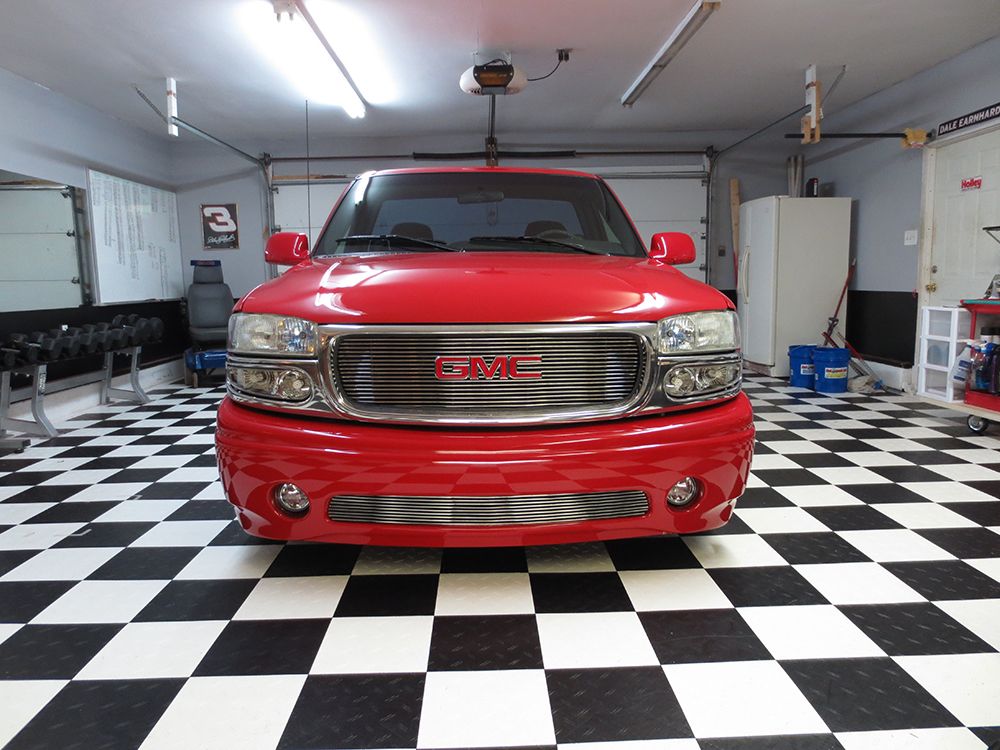

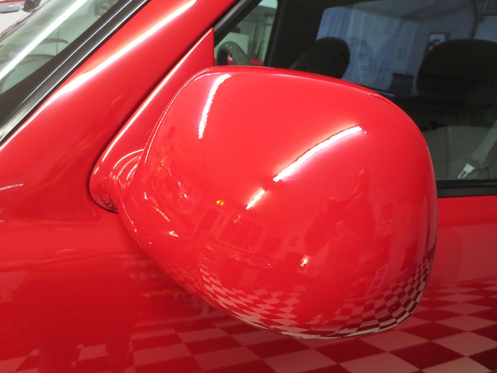

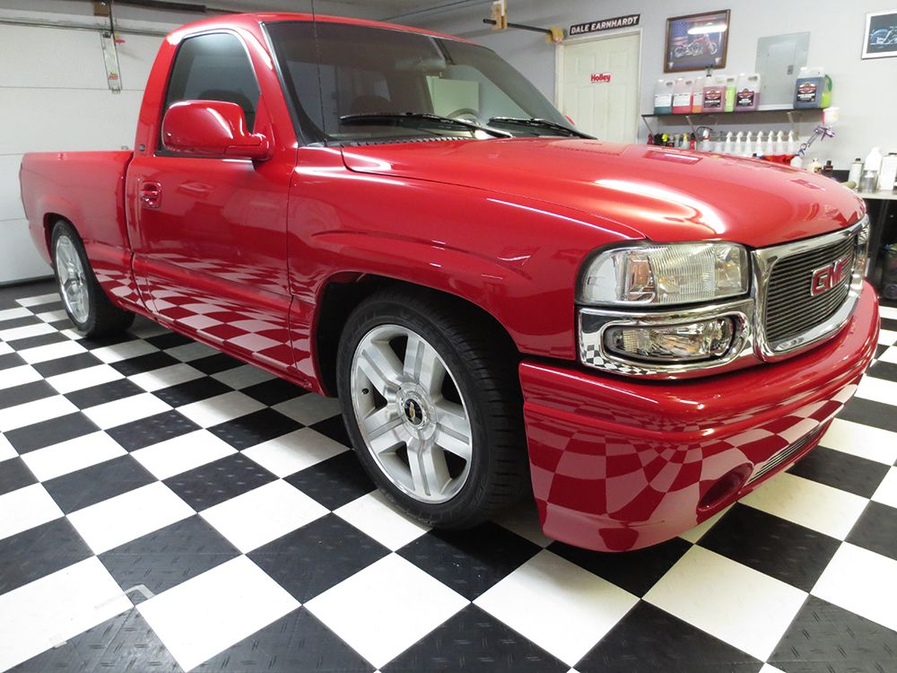

Finished
Still need to cut & buff the mirrors.
Well I'll be done when I clean up the mess... tomorrow... this old mans tuckered out! Not really just enjoying a cold beer, the mess can wait.
I agree your one hell of a body guy. And i see you have those nice LED's in your lens.
Now there's a nice skill set to have! If I knew how to do that I'd change the color of my car once a year probably.
Nice work. Looks good!
Been waiting for this update! Well done! Love the look! Are you nervous about paint chips now?

The epoxy primer has great elasticity and perfect for problematic substrates like urethane. The OEM's original base/clear was void of rock chips (just a couple) so after DA and hand sanding with 180P giving it some tooth, I applied three coats of the epoxy. Epoxy doesn't fill as well as 2K (two part primer/catalyst) primers but the three coats did fill enough to block out the scuffed edges I had to feather back.

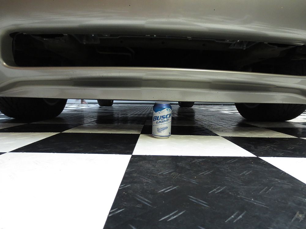

I guess time will tell as there is a lot of vertical surface exposed. I tend to stay far back of 18 wheelers anyways but you never know when or what gets kicked up on the road. I'm more concerned about dragging or misjudging those parking stops. I'm seriously thinking about installing a backup camera up front just to park lol.
5 1/4" clearance :eek:

Did you use the normal activator, or did you cocktail mix some of the slow into it as well?

Yeah I read a lot about the universal clear before shooting it and IMO it lives up to it's positive reviews. I used the slow 4003 activator on a 92 degree day and did get one minor clear slide on the bumper cover which cut down very easily. Maybe just a splash of medium activator would have dialed me in just right for panel spraying. On an all over, the slow would be perfect with the temps. You know us painters like to get it wet just before it want's to fall off on the floor, so signing your name in a place or two means a super slick flowed out job.
SPI is in Georgia and when I ordered it was on my door step (SC) the next day with free UPS shipping. Great deal on the prices, great products and free shipping!
I also bought the 2K primer for the tailgate. It has a small ding plus I'm adding the RST tailgate spoiler. I'll update my opinion of the 2K when I get that done and sprayed. If it's as good as the epoxy I'll be buying most everything from Barry except the base.

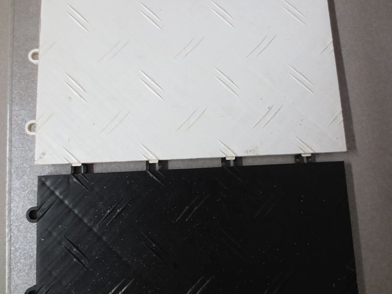

Red - Speaking of the garage, is the floor peel and stick vinyl or is it the floating click lock stuff?
Yeah it locks together.
It's "MotoFloor" from Costco manufactured by Snaplock Industries, the same company that makes RaceDeck.

Looks great, can't really see in the pics but do you have projectors now?
