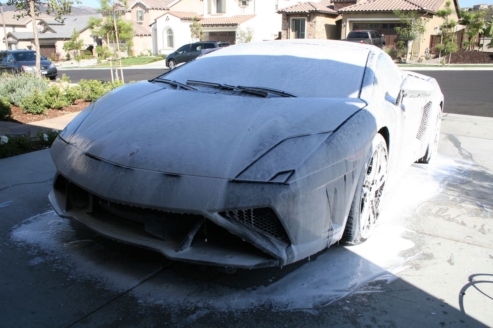

Polishing Prep is one of the MOST important steps and is often overlooked by many. Its imperative that the paint surface is not only contaminant free, but that the surface has been properly prepped before starting any correction work. This means from step a-z the vehicle has been washed, clayed, trim and edges taped, paint readings taken(If Possible), and inspected via LED & Halogen lighting. Skip Claying and you will start noticing pigtails and deep scouring during polishing, skip stripping previous LSP and you pads will gum up and defects won't be as visible. In addition I recommend that the interior, engine bay etc. are cleaned before polishing work is completed. This also means door jams are cleaned as well so that you don't have any chance of cross-contaminating paint surfaces down the road.
