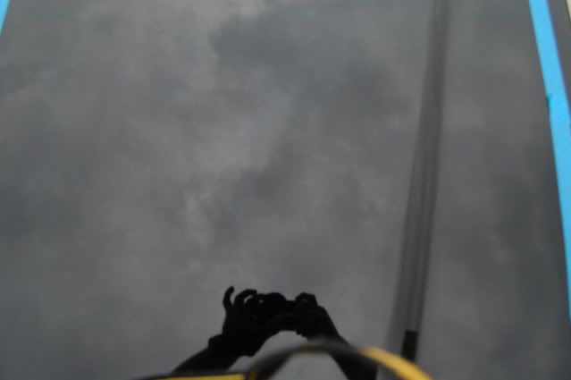

Here is the hood after washing and claying. YIKES!

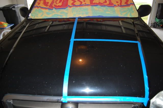

I taped off a section for a test spot.

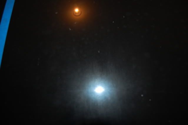

After my virgin run...to the naked eye, it looks "ok"
But unfortunately, the spots are still very much there.
TexanJim...I feel your pain...spent two hours today on the hood of my M3 with so so results...you can see what I used on my post White M3
Definitely work in smaller areas with more pressure and slower arm movement. I would get some white pads to use with the Finishing Glaze. It seems like the Total Swirl Remover left some micro marring on your paint.
