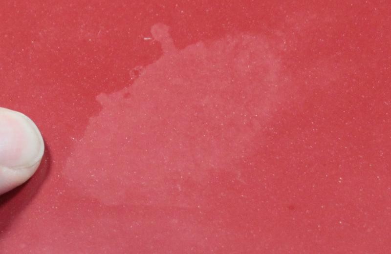

And you have read this article and looked at the pictures?
Clearcoats are thin by Mike Phillips
Yeah. I am aware of it. < 3mils, thinner than a hair... A few panels of this car have been repainted so I figured they might be thicker. The paint was already savaged anyway so I some how treated it as a test project.
