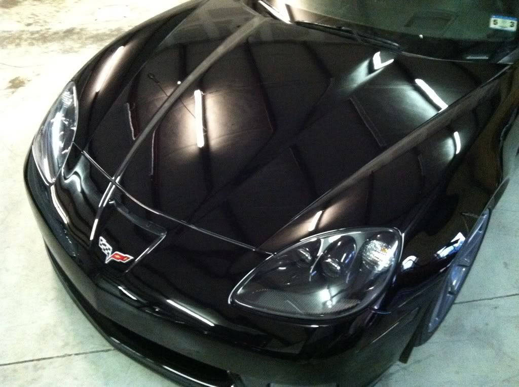

If anyone's curious how the car turned out, I will never allow a product issue stop me from providing a quality service. This is from my iPhone.
