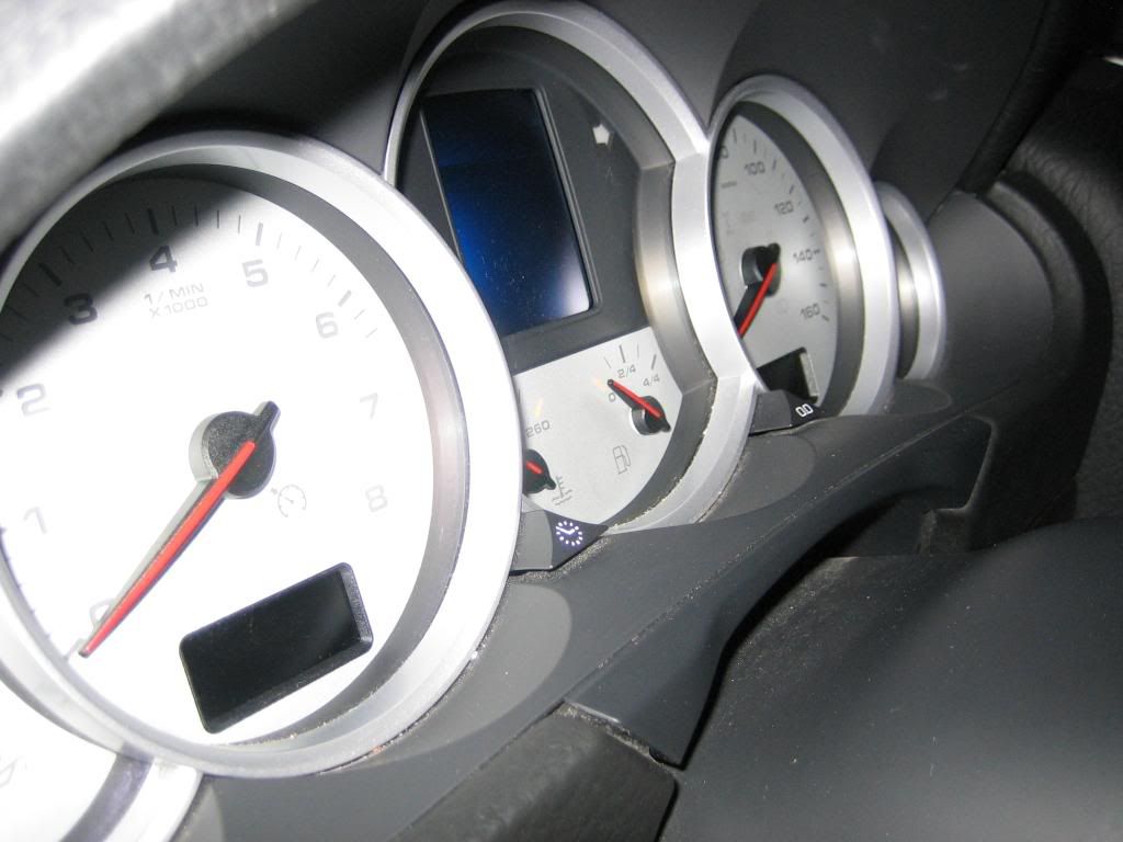

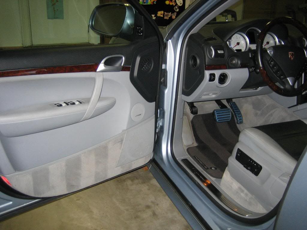

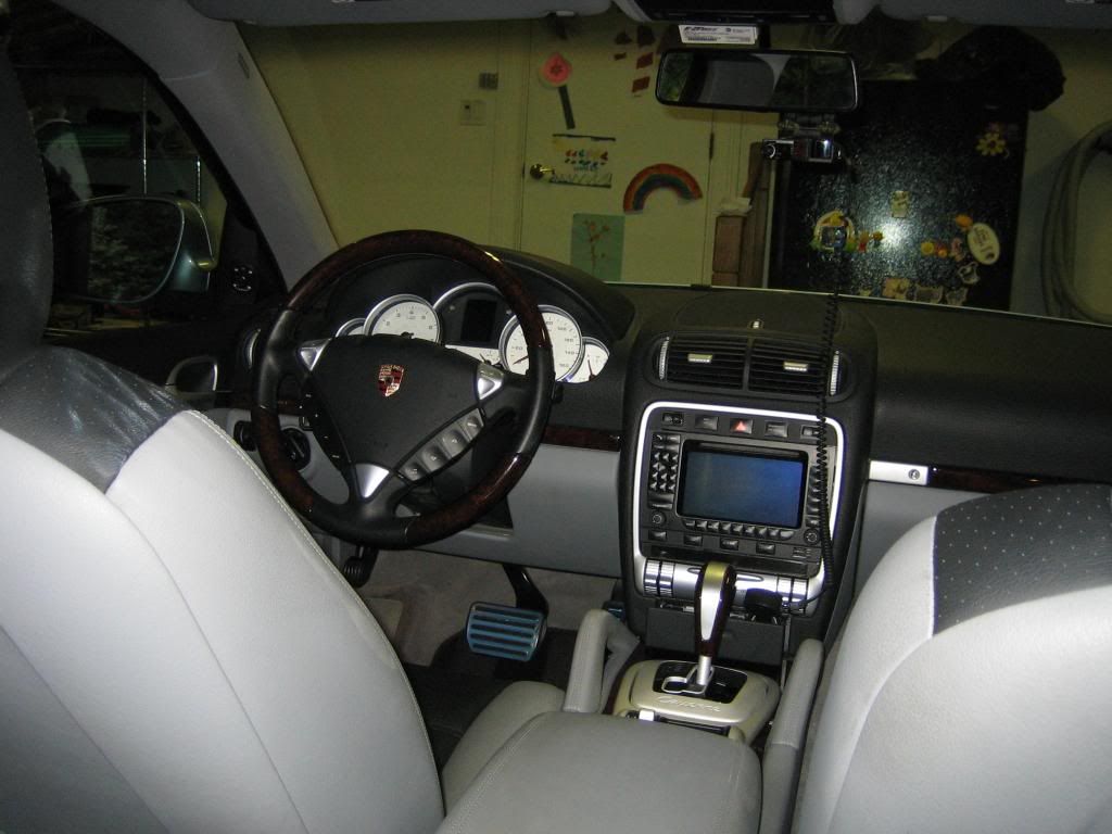

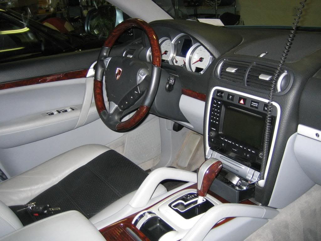

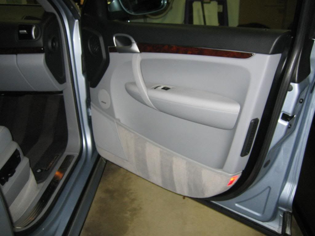

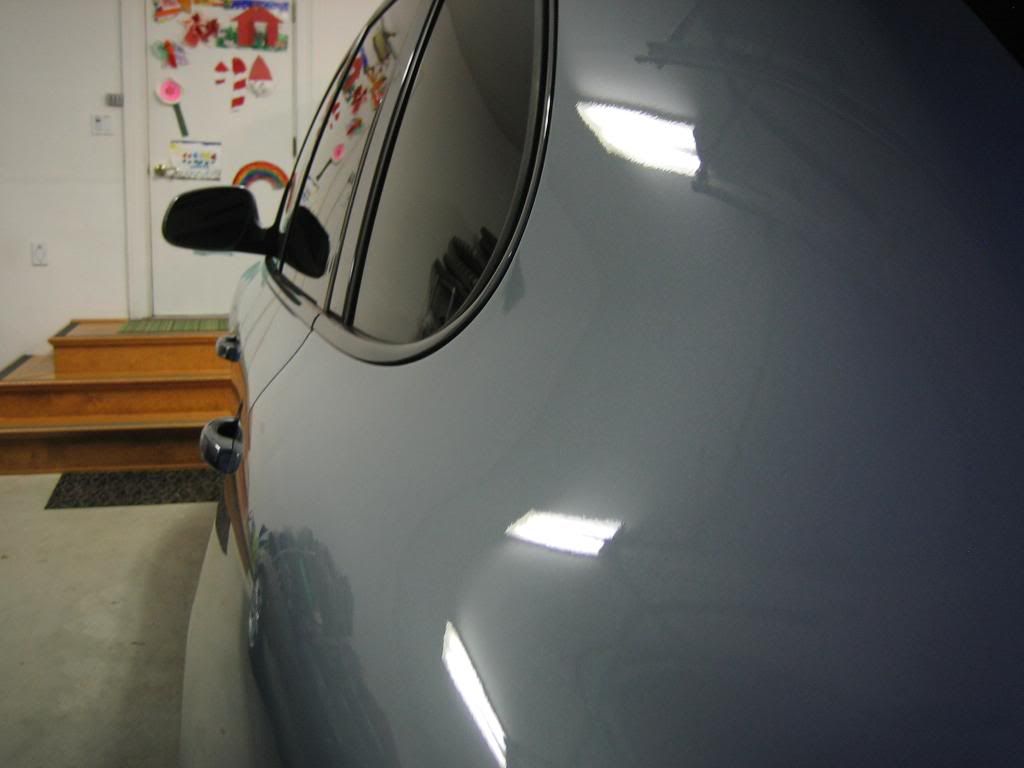

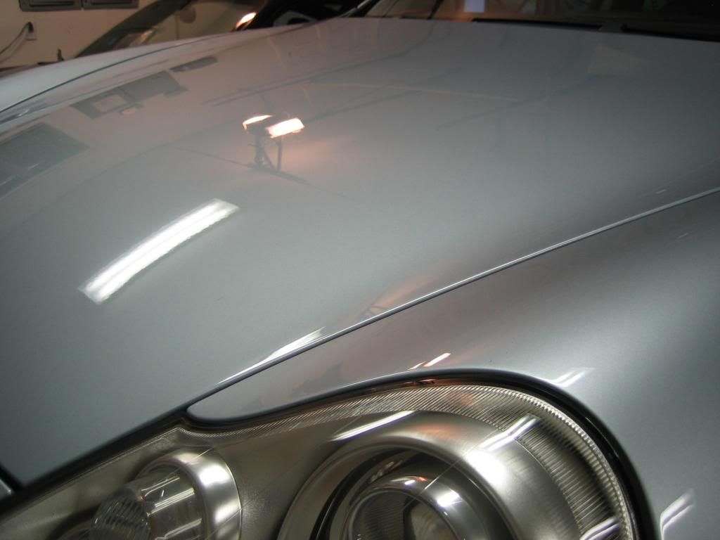

Well, this was one of those where do I start details. I talked to the owner after I finished and he confessed to having it washed once since he has owned it. That may not sound bad yet, but consider the fact that he bought it in 2006 and drives to New York city and back every single day!

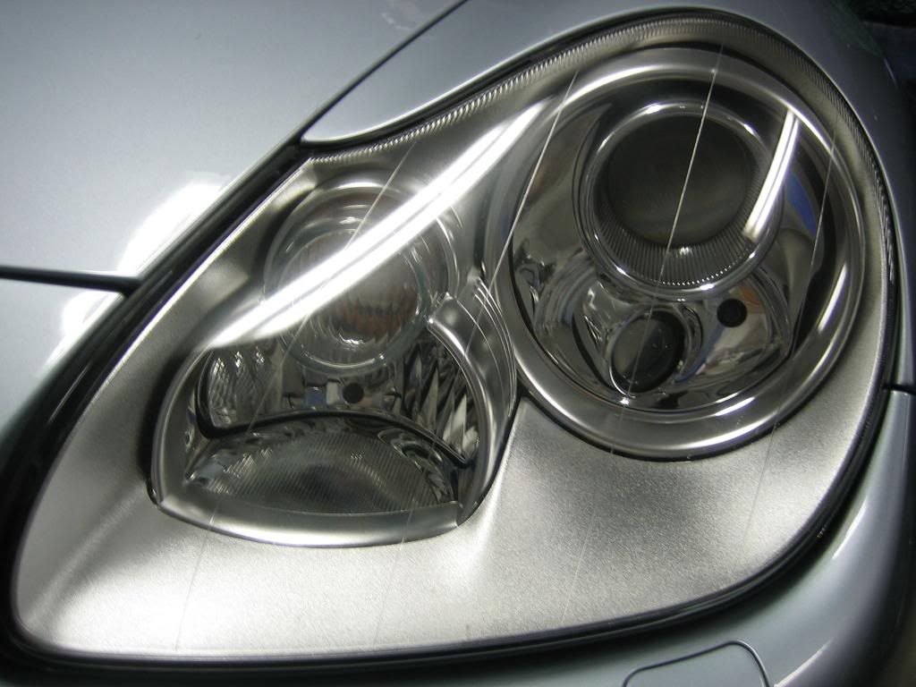

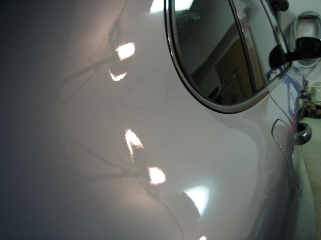

I detailed this 2006 Porsche Cayenne S titanium today, it was up for a full correction. I knew it was going to be a challenge, but it turned out very well all things considered.
Process and Products:
-ONR wash
-Riccardo clay, ## Luber

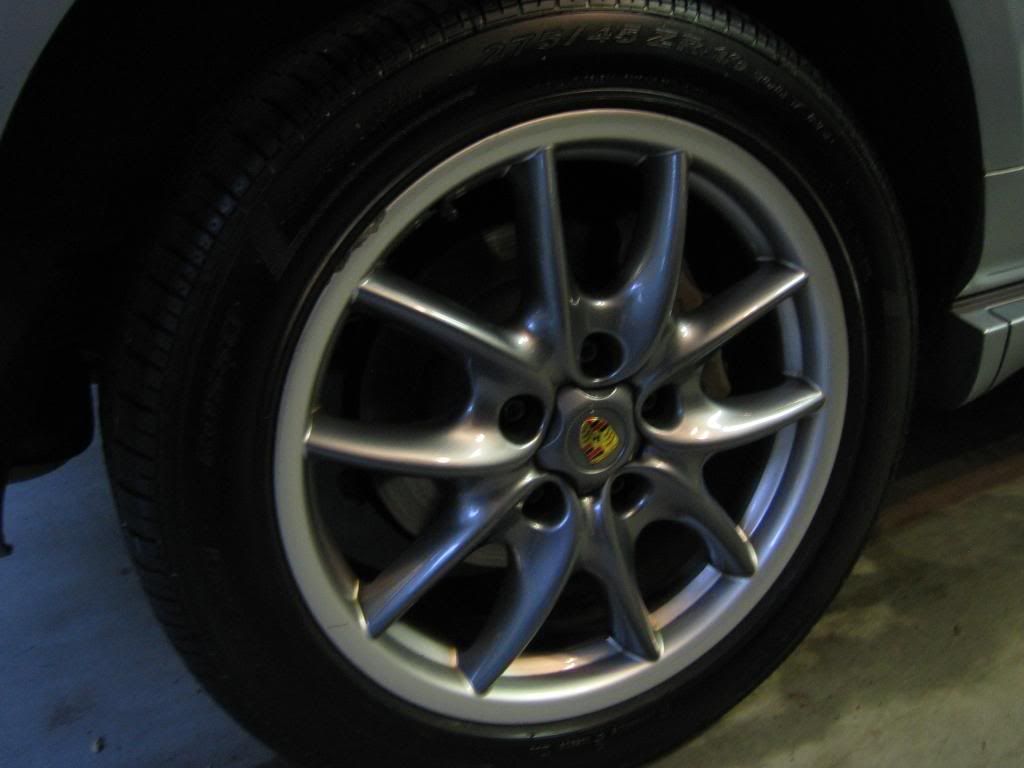

-Amazing roll-off on the wheels and wheel wells
-XMT #3, PC7424 and orange pad
-Menzerna 106fa on a white CCS pad
-Collinite 915
-P21s 100% Carnauba
-PB's wheel sealant
-Megs Endurance tire shine
-Rain-x'ed all exterior glass
-Flitz metal polish on the exhaust tips

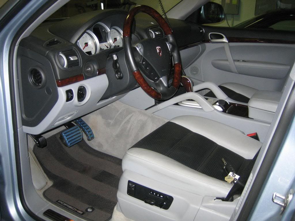

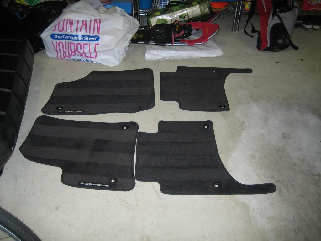

-Bissel little green on the carpets
-Resolve
-Woolite and water 1:3 on all interior panels
-303 Protectant
-Lexol leather conditioner
-Megs UQD on windows and gauges
-P21s on the wood trim
Befores: 50,000 miles, 1 car wash
