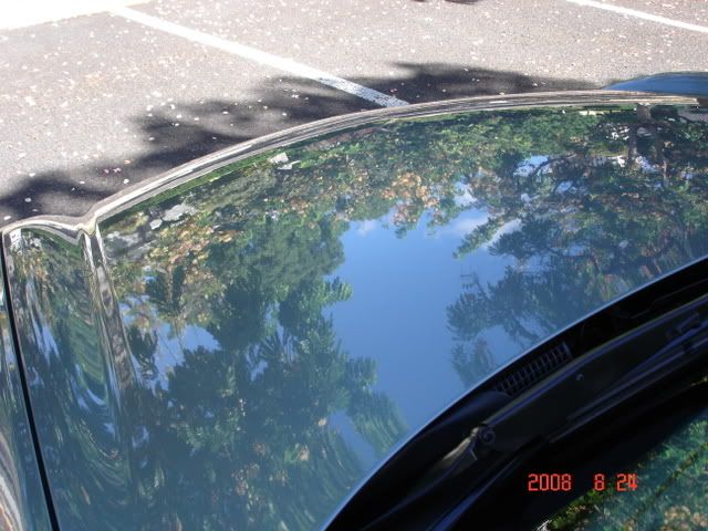

The clarity of the reflection is amazing. I noticed in several like pictures that w/ Fuzion you could see my reflection taking the picture and I was a good 10-15 ft away to get the entire car in the shot. The more I really analyzed the pix (and the actual car) the more amazed I was. I'm really glad because working in my garage (read sweating like hell) I was gettin a little concerned that I might be disappointed with this purchase. I don't think after such success in the last month I could have taken 2 let downs.
But you decide for yourself. I have a link above to my first pictures. I tried to do the same basic angles plus a few others. Here are the pix. I hope the picture compression when I upload these shows the reality of the pix. I was able to compare them at the 10 megapixel originals...

GREAT PICS, I was hoping to post some of my results with Fuzion but being White Paint they don’t come close to your results. Very Nice Ride.
Ah come on, post 'em. And thanks for the compliment!
Here's Fuzion X 2
